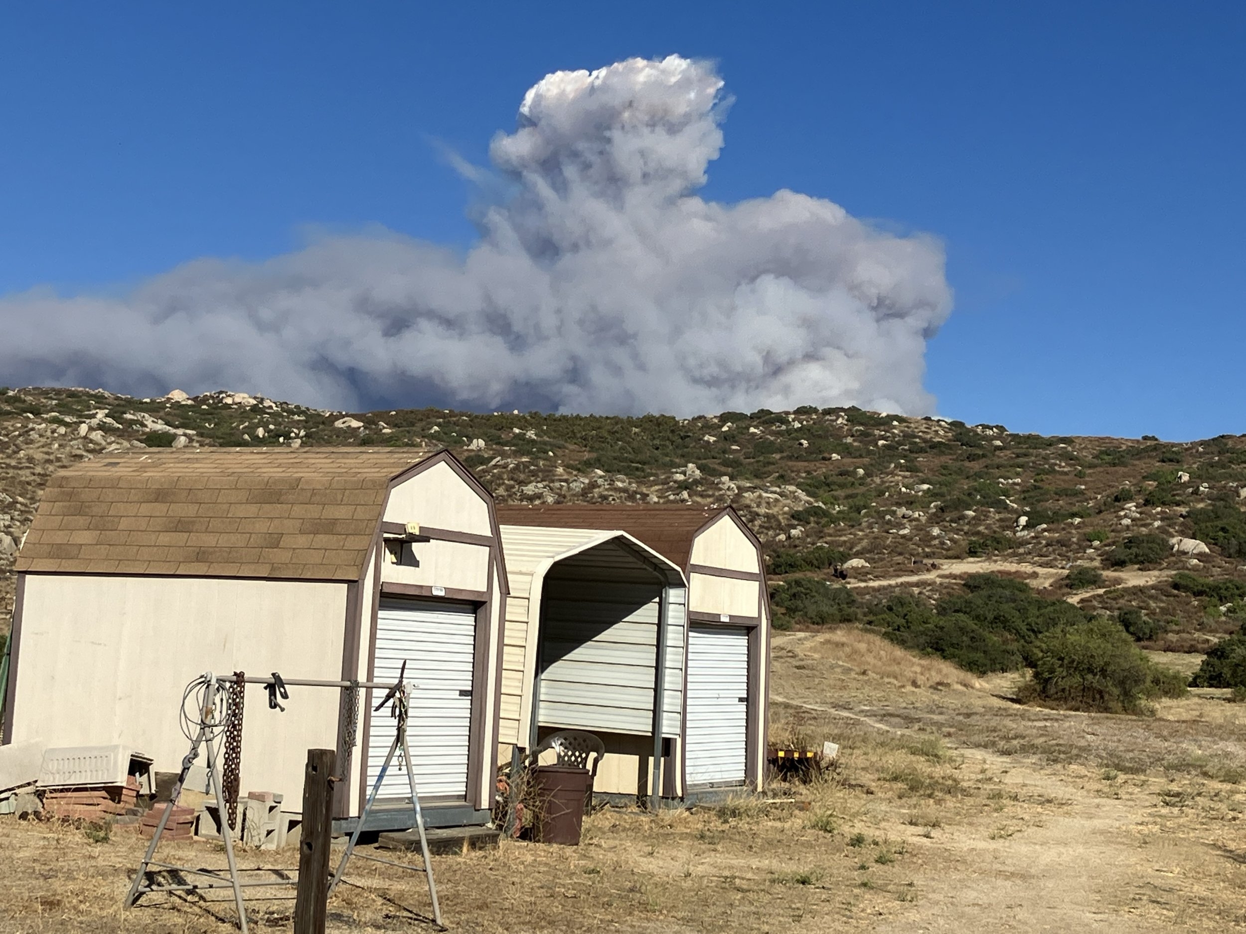

Minor problem with getting anything done today...Over 300 acres already and its only 5 miles away. Sorry if this is off-topic.
Looks like youre safe.😌
