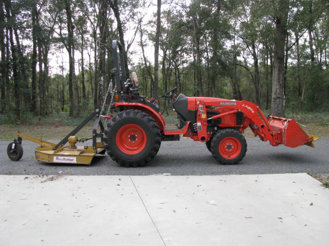

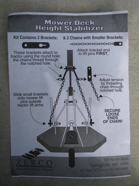

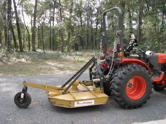

None of the 'B' series has position control. Without position control a SLOW drift down of the bottom links is normal.
The only palliative is check chains, such as Zerco, most commonly used with rotary cutters to assure down return to specific height. Zerco check chains work "fine".
In Photo #2 rotary cutter is UP, chains are slack.
In Photo #3 rotary cutter is DOWN, chains are taut. DOWN adjustment is repeatable and will hold as many years as the chains last.
MORE INFORMATION:
http://www.tractorbynet.com/forums/...271185-kubota-b3300su-zerco-check-chains.html

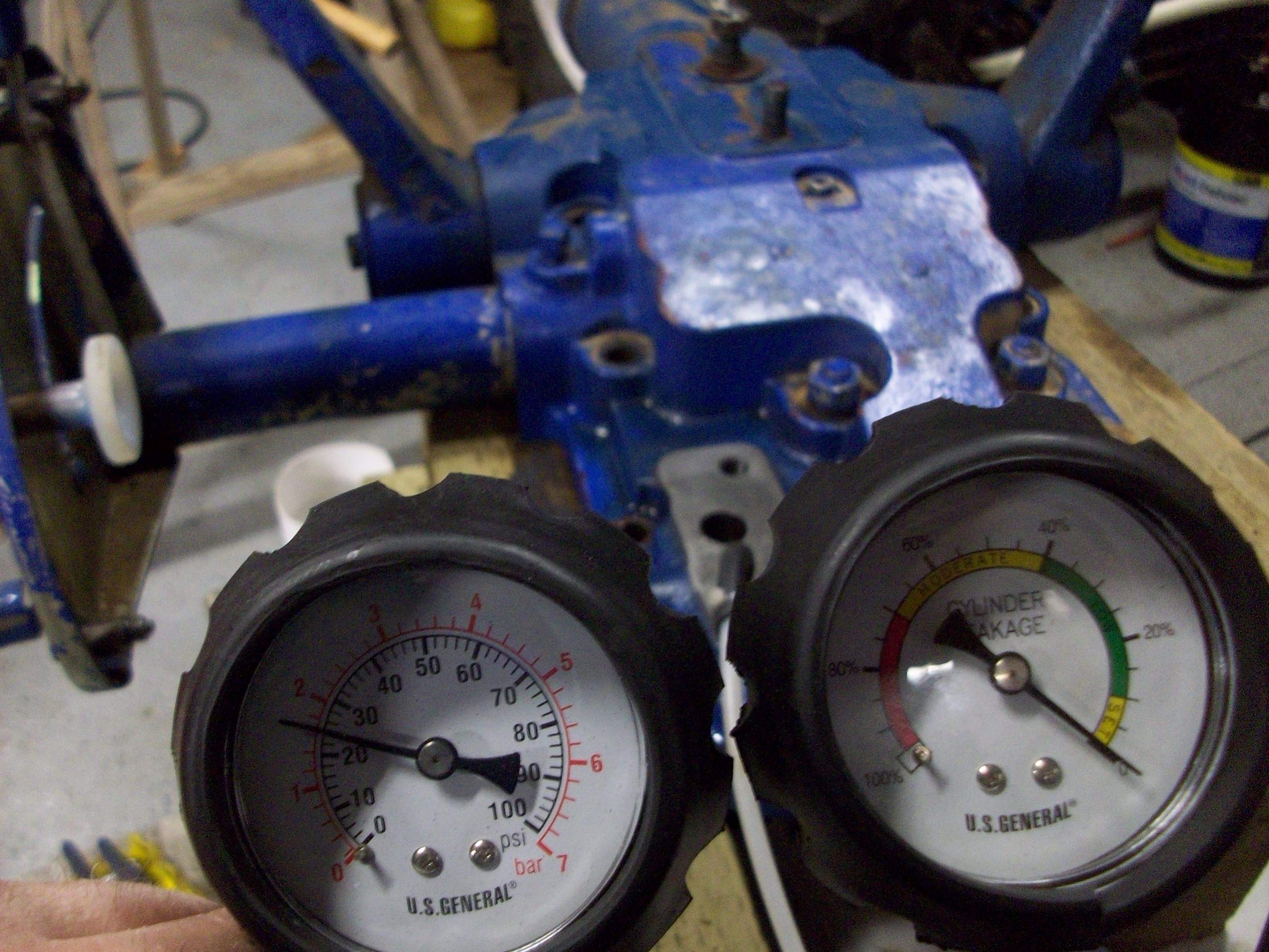

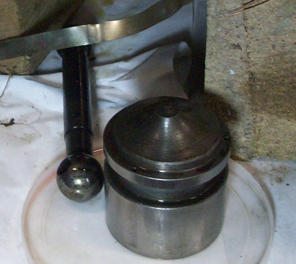

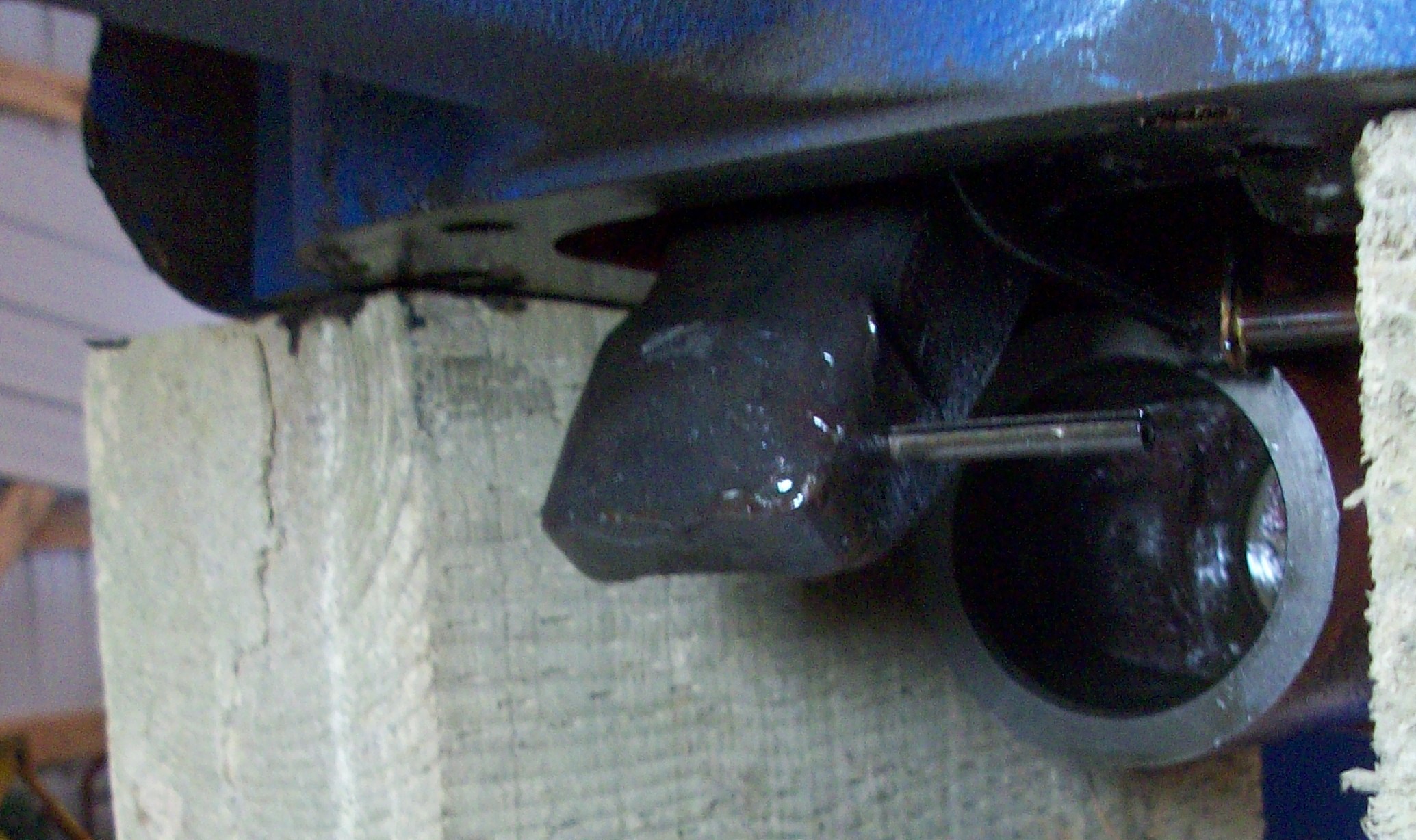

if it is like most tractors, the rockshaft seal if bad- results in your description, but the hydraulic control linkage would cause it to lift back up to the original position if the tractor had position control and the tractor was running..
When not running the quick lowering is the most common result with a failed rockshaft seal...one more thing a rockshaft seal failure will not affect fluid level, it will just end up in the sump..rockshaft seal replacement 001.JPG rockshaft seal replacement 002.JPGas can be seen in this picture the cylinder that the rockshaft piston slides in is open to the sump, this ones seal had completely disintegrated.
Replacing the seal and honing the cylinder restored the 3 point lift, to as new operation.
You can also check your work by using an air compressor and an inexpensive leak down tester as I did, this assures you that the seal is sealing correctly and that it didn't get damaged during installation rockshaft leakdown test 002.jpg besides those rockshaft covers aren't exactly light, and it's no fun taking it apart twice...
