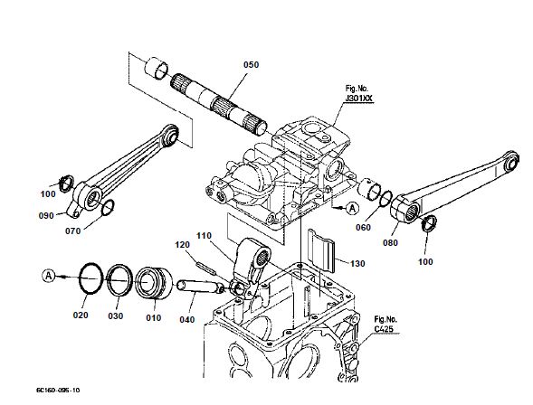

Hi 600Rider, my Kubota 7510 is the same, the 3pt hitch drifts down, in my case it will drift down faster when the rpm's are at or just above idle and very slowly at 2000 or higher. It is a pain. I am considering the repair this summer, I think that Sd455dan in post #10 hit the nail on the head, the seals on the Hydraulic piston/lift arm are bad and need to be replaced. I am attaching an image from the parts manual I found showing the piston (#010) and the O ring (020) with Ring back up (030) are the parts I am going to need.
The knob under the seat will not lock the 3pt in position if the seal is bad, the hydraulic fluid will bypass the control mechanism. Hope this helps. B7510 hyd piston lift arm.JPG

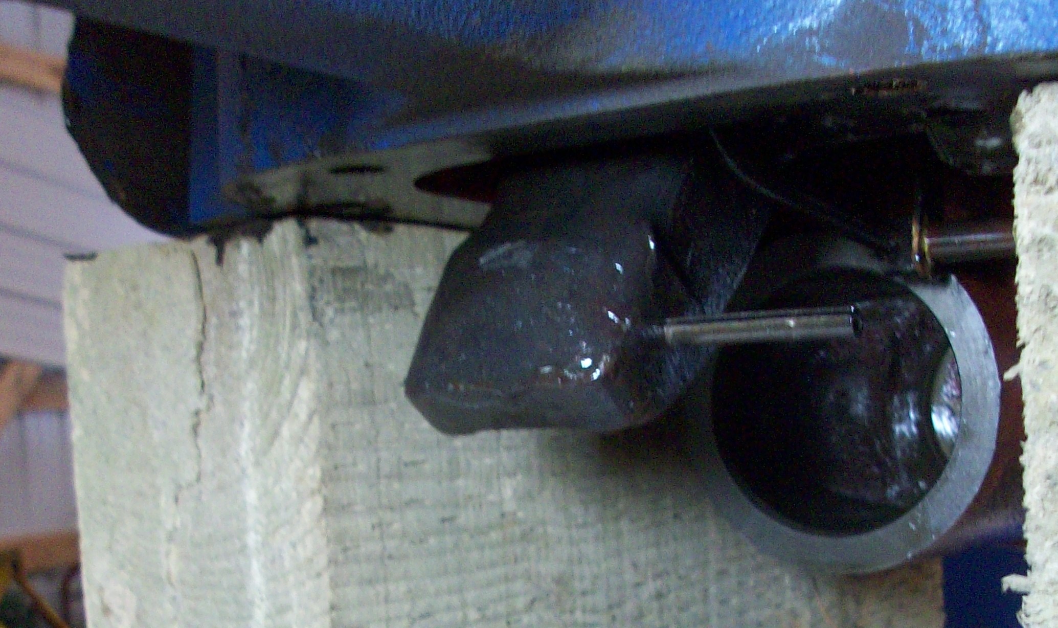

When not running the quick lowering is the most common result with a failed rockshaft seal...one more thing a rockshaft seal failure will not affect fluid level, it will just end up in the sump..View attachment 313934 View attachment 313935as can be seen in this picture the cylinder that the rockshaft piston slides in is open to the sump, this ones seal had completely disintegrated.
Replacing the seal and honing the cylinder restored the 3 point lift, to as new operation.

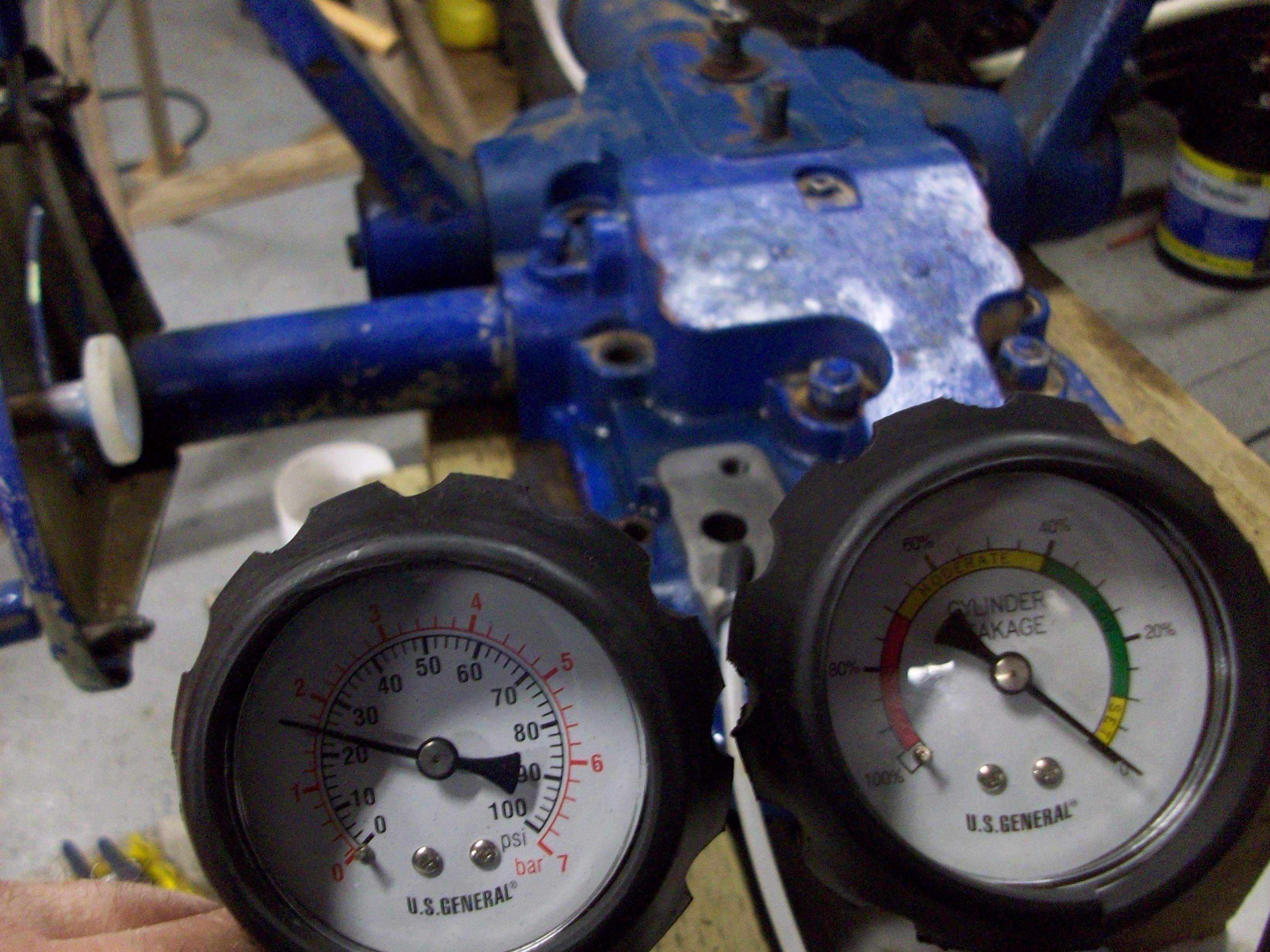

You can also check your work by using an air compressor and an inexpensive leak down tester as I did, this assures you that the seal is sealing correctly and that it didn't get damaged during installation View attachment 313940 besides those rockshaft covers aren't exactly light, and it's no fun taking it apart twice...
I agree with this post^^^^ most likely the rockshaft seals are shot. The next possibility is the rockshaft valve is leaking and would need new orings too.

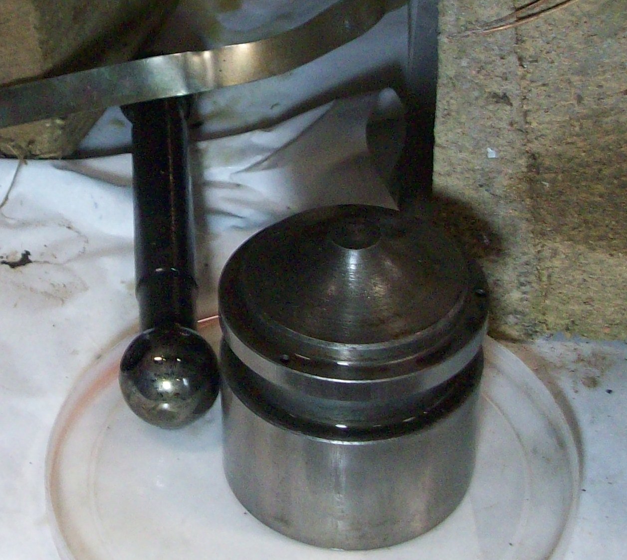

One other thing 600rider , and you may already Know this, but I did not think it would hurt to include it.
The main piston seal is a v type seal it will always be installed with the outer sealing lip facing the pressure side of the oil circuit.
That way as the hydraulic pressure increases the lip of the seal will be pressed outward and in contact with the cylinder proportionally to the pressure of the fluid, so the higher the fluid pressure, the the tighter the lip presses outward.
The tractor I replaced the seal on only employed one seal, and as you stated- your application requires a second seal... not sure if the back up seal is of the same type so can't advise on that ... Looks like your well on your way to getting the 3 point back to fully functional :thumbsup:
