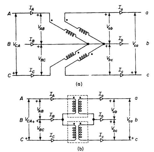

All delta systems (there are at least 4 variations) provide 240 Volts single and three phase including the open delta systems. If the open system is corner grounded it provides 120 volt single phase on phases A and B (normally colored black and red) and the wild leg (blue) higher voltage which cannot be used for 120 volt circuits.
120/208 volt systems are only what are called Y connected 3 transformers. these systems can be derived from delta (3 wire) distribution by connecting the primary side of the 3 transformers in the delta configuration and the secondary side in the Y configuration. Most parts of the country utility companies replace the old delta primary systems to Y systems as they are more versatile in general population areas. Industrial areas where heavy loads are encountered still provide delta for those loads.
You electricians out there correct this dialog if I got something wrong. I have tried to discuss open delta with some of my electrician friends but they know the theory but have never encountered it.
Voltages higher than 240/120 are outside the scope of this discussion.
Ron

1) Open deltas are fairly uncommon, but are used in emergencies if a transformer fails, since you only need 2 utility transformers. It is sometimes used as a low cost 3 phase install, that can grow into a real delta system by adding another transformer. An open delta will put out 57% percent of the power of a "real" delta. An open delta is still created from a 3 phase utility system. You cannot get 3 phase from a single phase system without some type of phase converter.
2) The most common delta system is the 240/120 delta. Line to line voltage is 240 volts all the way around. Line to ground is 120 volts from A to ground and 120 V from C to ground. B to ground gives you 208 volts (wild/high leg). This is because the winding between A and C is center tapped and grounded to give you a neutral for 120 V loads. THIS IS NOT A CORNER GROUNDED DELTA.

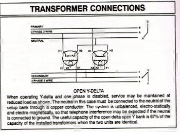

   / 3 Phase? #24
A quote from Arlens post.
"You cannot get 3 phase from a single phase system without some type of phase converter"
Arlen,
Here is some more data to either expand or compress the confusion, you pick.
This is a wiring diagram excerpt from the "Electrical Pal" an electrician's pocket reference. This is how the utilities get 3 phase from a single phase primary. Same thing if they do in an emergency when one phase is out. That is why the capacity is cut 57% and it is a grossly unbalanced system; but, it works until someone tries to screw with it or a glitch pops up. Back in the 50s we replaced a lot of AC compressor motors at the utilities expense when we proved their system was at fault. They had a lot of problems keeping the power factor balanced. We carried a PF meter in the truck just for that purpose. Rest my case.
Ron
Arlen,
Ron
That's not an open DELTA. It's an open WYE DELTA. And it is certainly not what the OP has. It is not a viable 3 phase in my book for the reasons that you mention. That configuration would destroy equipment, is dangerous, and causes serious line disturbances. Allot has changed since the 50's. Here is an open delta. Three phase in...three phase out, using 2 single phase transformers. It's also important to note that your diagram is still fed from a three phase wye system with one dead phase. It's still a 3 phase system, and the neutral is being used. It would not work for a single phase distribution, that would have only 2 wires.
