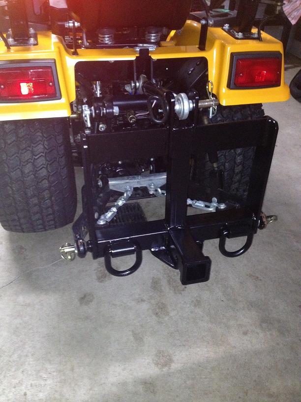

Anyone ever make a cable plow? I need to run some power to my shed. I'm going to make one this week for my rear hitch. any tips?

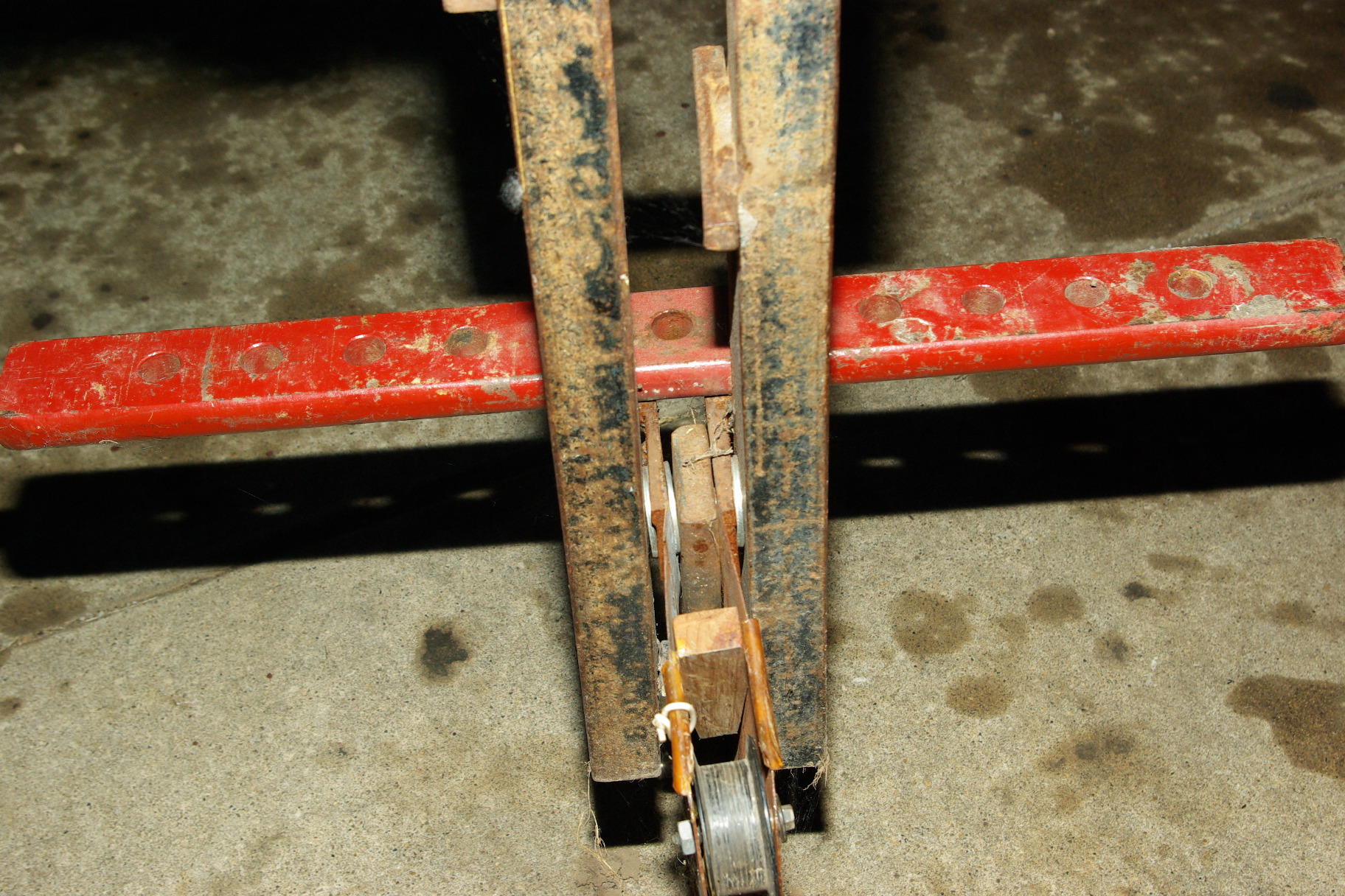

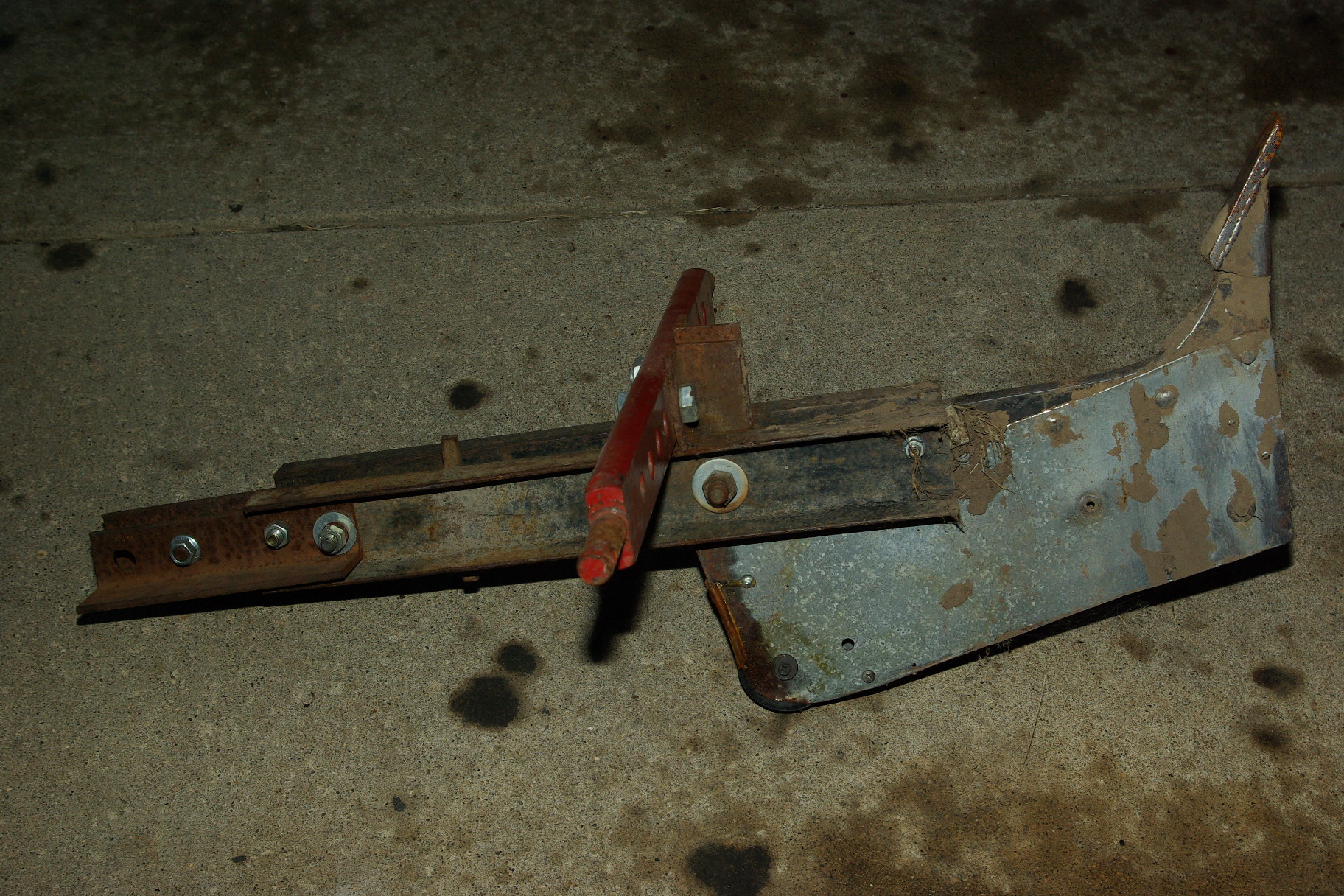

Bolted this together one afternoon. Started with a shank from the box/blade, a Cat 1 3 point drawbar and a piece of channel iron or C channel which was not long enough. So I had to add the top pieces of angle iron to make it tall enough. Flat steel to make the shoe and some plastic pulleys for the cable. Made it so it would shear the lower bolt when I hit rocks and that has happened a few times. I use a hardened bolt there now. I have put in everything from invisible dog fence to 10/3 underground. Working depth is 12" and at that depth, it pulls hard. If I change my mind, I can always take it apart.IMGP5865.JPGIMGP5866.JPGIMGP5867.JPGIMGP5872.JPG

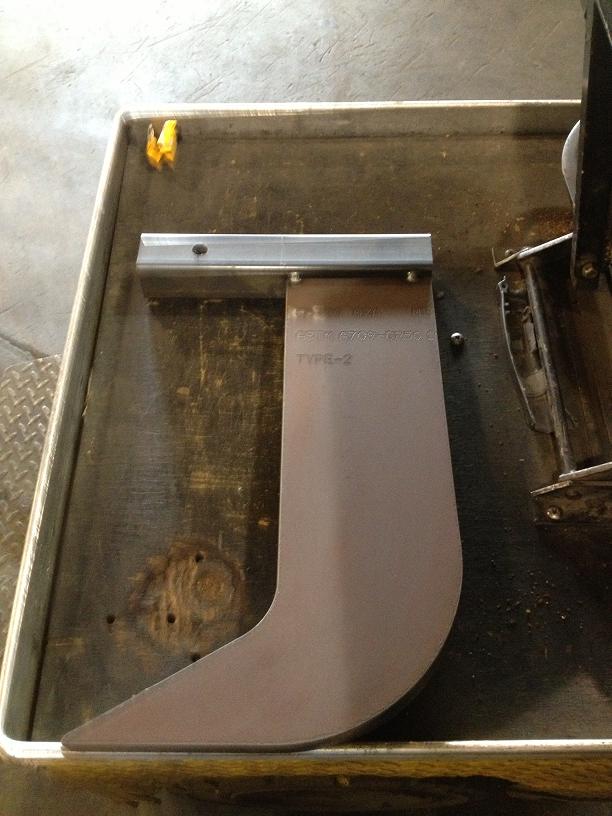

ok, here is my prototype. 2" tube with 1" thick mill plate knife. I'll make sure it fits then weld it up.

I was going to just put the cable in the ground. I changed my mind and now plan to put it in that gray pvc tubing. So I plan to just trench with this. If I ever want to make this into a cable plow I was going to weld a pipe with a elbow on the back side & a spool holder.
The hitch I made in the first post I also made some weights that slide on. About 350lbs worth. hopefully that will get the job done.

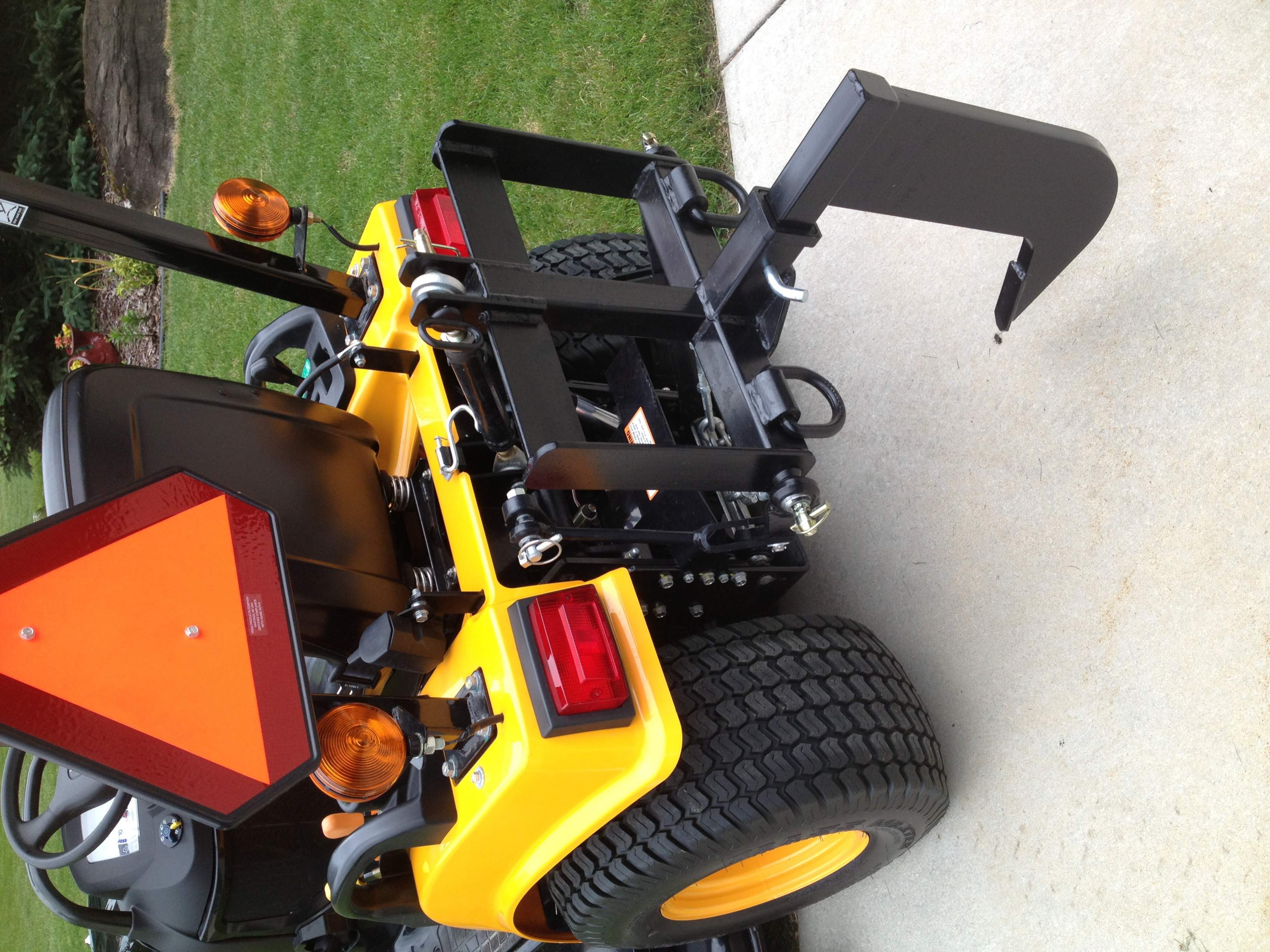

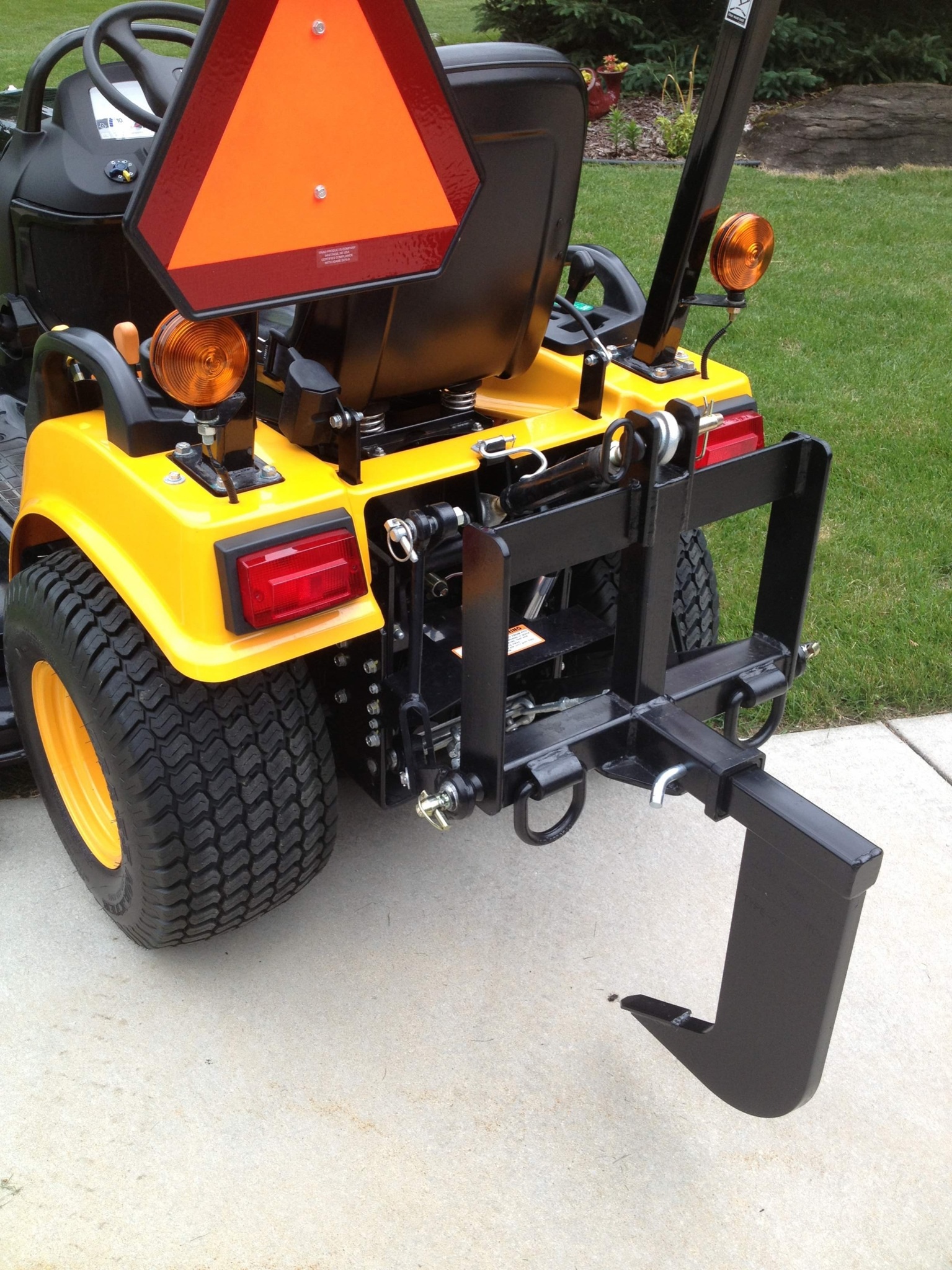

Here is my finished cable plow.

Hopefully I have enough traction to pull it. I'm guessing I'll have to lower it a little at a time. I have about 350lbs of weights I made to fit on the hitch.
