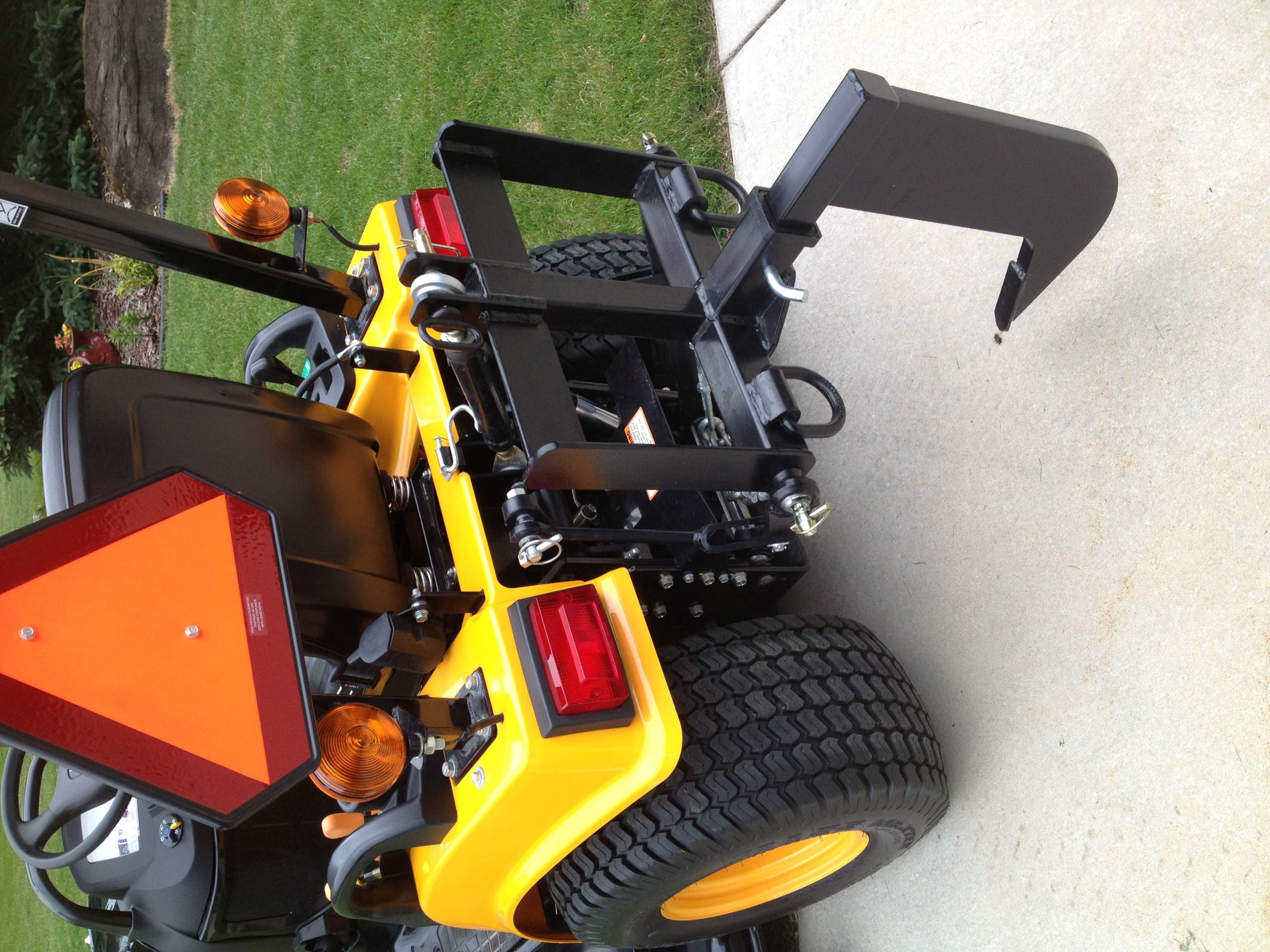

Anyone ever make a cable plow? I need to run some power to my shed. I'm going to make one this week for my rear hitch. any tips?

ok, here is my prototype. 2" tube with 1" thick mill plate knife. I'll make sure it fits then weld it up.

I was going to just put the cable in the ground. I changed my mind and now plan to put it in that gray pvc tubing. So I plan to just trench with this. If I ever want to make this into a cable plow I was going to weld a pipe with a elbow on the back side & a spool holder.
The hitch I made in the first post I also made some weights that slide on. About 350lbs worth. hopefully that will get the job done.

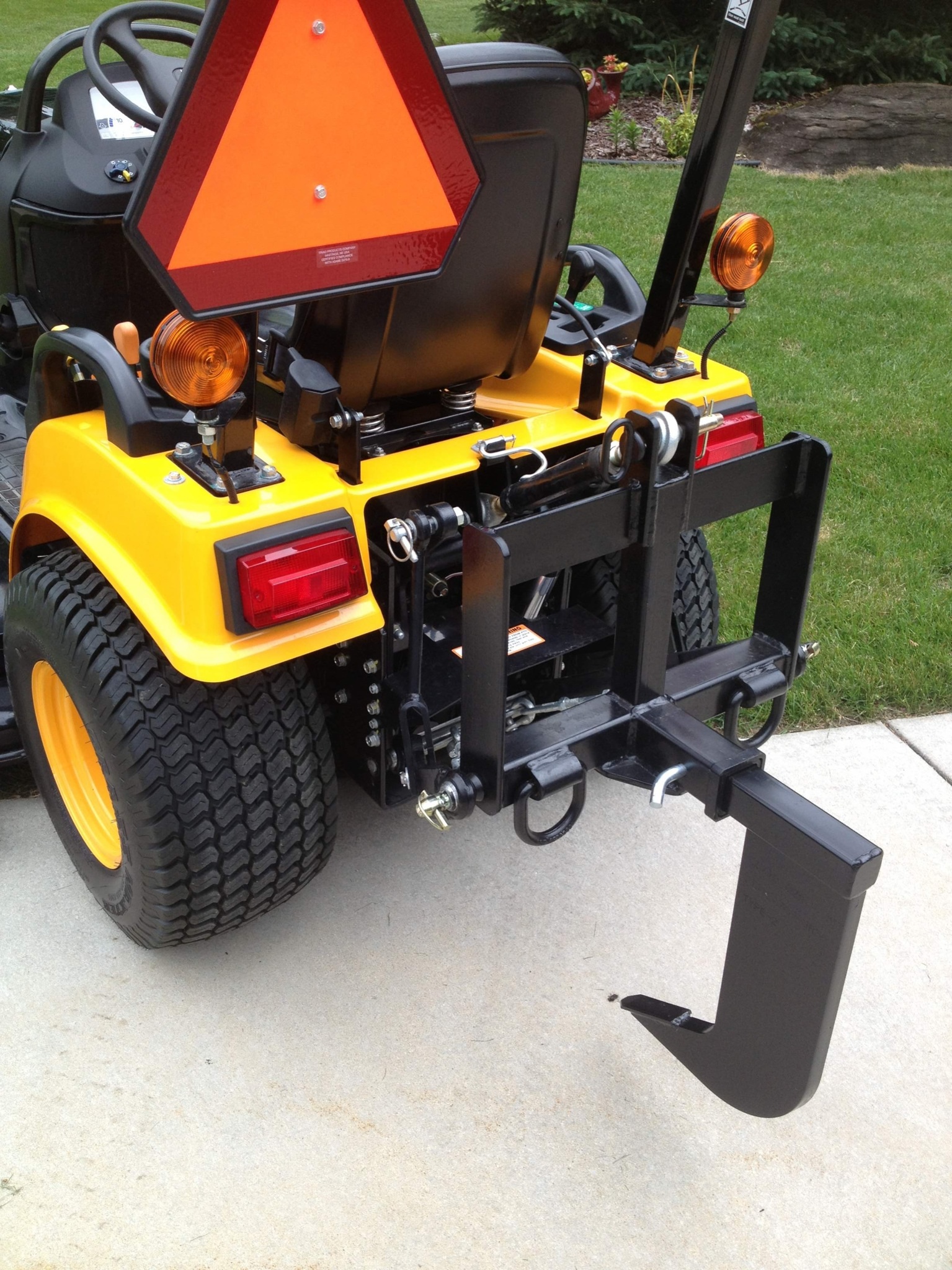

Kenny I actually stole your idea when I made mine. Figured I would add the pipe on back later....Thanks

Here is my finished cable plow.

Thanks.
Hopefully I have enough traction to pull it. I'm guessing I'll have to lower it a little at a time. I have about 350lbs of weights I made to fit on the hitch.
