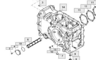

I have a JD 5055D. The 3 point hitch will raise if not attached to anything. It will raise a 230 lb boyfriend :) but it will not raise my bush hog more than a couple inches off the ground. I have changed the hydraulic filter and added oil ( although i cannot see any change in the view circles). I have not tried to take off the screen yet. Should that be my next step? Is there anything else I can try? Thanks in advance !!

I would start with the simplest tasks 1st which would include checking hyd oil level, changing hyd filter & checking/cleaning oil suction screen

I also think its your internal screen that is plugged, I had a few tractors do the same thing after sitting for 6 months.
It seems that all the gunk in the oil settles to the bottom and gets trapped in the internal suction filter screen.

Welcome to TBN - bigskyfarmga. You can bet it's going to be a job where you will get oily. If that has not already happened. Sounds, to me, like a plugged internal screen.

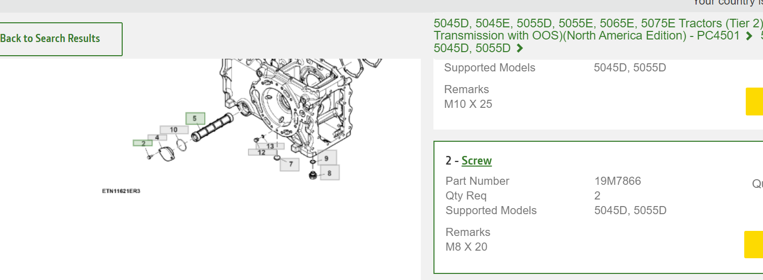

I am having a hard time finding a wrench to fit... anyone know what size this would be for the cap screws on the filter?

Retaining bolts on screen cap are size M8

Got it. It was a 12. Called the dealer and the shop said that the paint will mess up the sizing - he was right. There is junk in my screen at the end. No idea what it is, possibly from an o-ring or other seal but nothing is obviously leaking. I am wondering if I should put it all back together and refill and see what happens or stop where I am and send it off to the shop. Dang it just can't be easy.

I'd clean the screen good (check the debris good for any identifiable parts for a clue) and also change the filter, then refill and hope it solves the problem. The shop likely would do the same to troubleshoot any problem.
