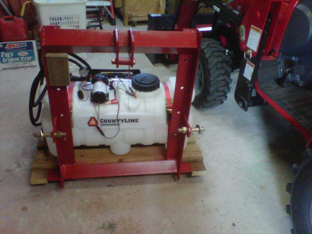

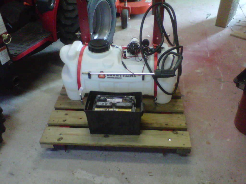

Here's one I put together with a frame, sprayer, battery. The wood frame is mounted on the frame by wing nuts so the frame can be used for other things too. I since added a boom to the wood frame for broadcasting. The battery is charged between uses. You could put any size sprayer on this. It does what I need done very well and I spray 7 acres. Could not justify going the 3pt-pto route. sprayer1.jpgsprayer2.jpg

Now that's an easy workable solution. I like the frame for the 3PH but perhaps I could mount something in the back of my gator to spray the rows. I had my fields measured with GPS and it''s a total of 16 acres. Since I'm only doing the rows it probably will be somewhere in the neighborhood of 5-6 that I will be treating. I don't want to spend a lot for just one or possible two applications. Thanks for the pics. That gives me an idea.
