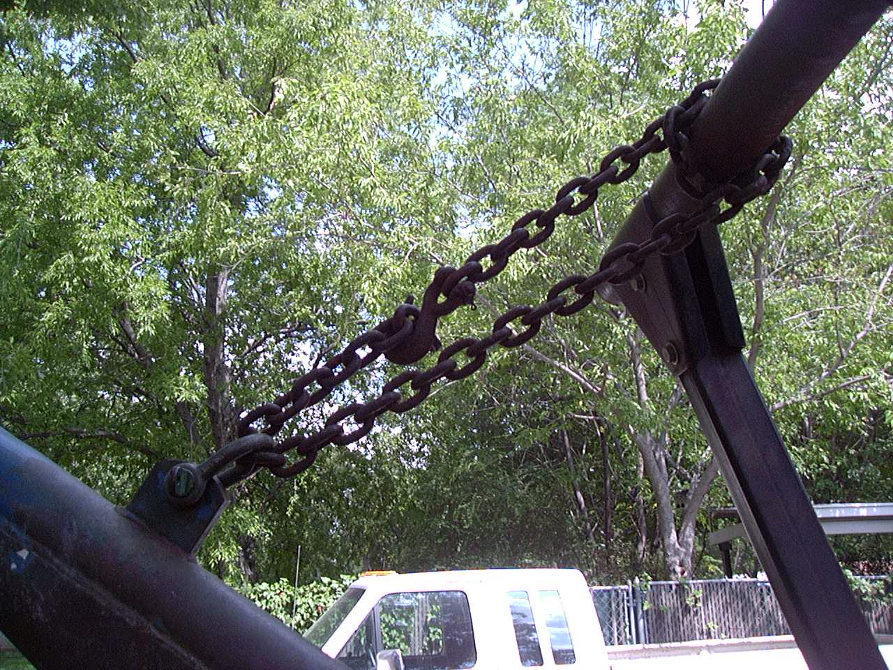

On a similar topic, I'm still using the post hole digger but when I'm simply driving the tractor around or days I'm not using it I chain the post hole digger to the bar as shown below and let the digger down. This way the digger is up and I can drive the tractor around without constant pressure on the digger.
Is this a good idea or am I causing some other problem?

Hi Sevans,
nothing in life is black and white other than death and taxes:(:(
On the up part I see that you that you take the pressure off your lift system but consider that while the tractor is running you have the pressure always on due to the nature of live hydraulic you have, so the way you hung it is good for storage when the tractor is off. I guess what I would be concerned with Is the heavy auger that is hanging from the end , where the pivot point is and the amount of the force is exerted to the chain and the ROPS while you are traveling. I hate for the tractor wanting to back flip because of where your are putting force on the ROPS. Remember always pull from draw bar and never ever from the ROPS.
my 2 cent,
JC,
ps. You have dynamic forces (associated with velocity) and static forces. Dynamic forces can be multiplied many times let's say you happily moving down the pasture and all of the sudden hit an unexpected bump causing force to ROPS magnify.
