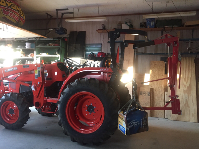

I found a used engine puller (cherry picker to some). Made a bottom plate to fit the lift bars and a bracket to hook up the top link. It works like a charm!!! You have the tractor lift along with the picker lift (that changes the lift point==pivot point of lift). It can be shortened for heavy loads or lengthened for lighter things. I've raised things over the side of a pickup bed with mine.
   / 3 point lift capacity with boom pole #12
Here's a store bought receiver hitch style. There is a leg directly under the vertical part that must be put down on the ground if picking up any significant load.
I use it to unload the pickup occasionally.
I have it mounted on a Titan 3point receiver hitch attachment here.

What sparked my question was the front loop capacity; on the smaller boom ,it is only 500lbs. That did not seem like much, given the tractor capacity
is listed as 1400 lbs 24 inches behind the hitch.
I understand a bit more now (thanks LD1)- 500lbs on the front loop, with the 3pt at it's highest lift, on the 'right' top link hole, my be at or near the tractor capacity.
I am still leaning toward the heavy duty pole, simply from a stability and durability standpoint. It is twice as heavy as the small boom though - and twice the cost. Hmmm.

In reality, the lighter one would probably be just fine. I am sure there is a nice safety factor built in as well. We have one of them lighter ones. Used it on the back of an international 444 to lift an entire loader/bucket onto the trailer when purchasing. Guessing 1000#+.
THe heavy one sure looks nice though, and has a third toplink hole as opposed to two to further taylor the lift height/capacity
