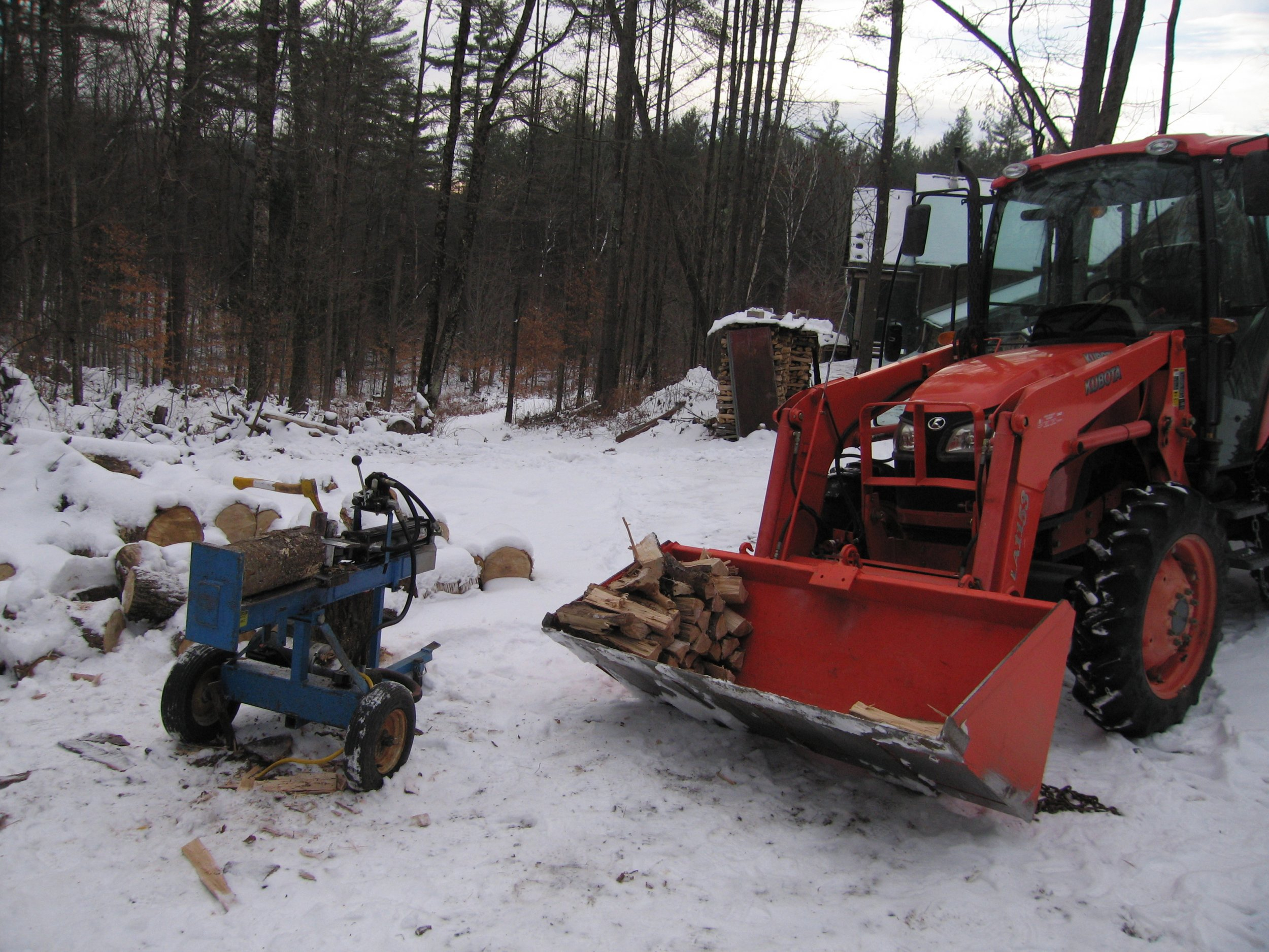

I got a 16 ton 220volt electric Ramsplitter. It is quiet and fume free.
I put a 220 outlet on the back of my shop and split everything there where I stage and store all my firewood logs
It's a poor pic but here it is.
