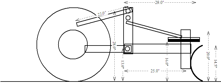

I took some measurements of my Woods 5' back blade on my B2620. Attached is a rough diagram with measurements. Click on the thumbnail to make the drawing larger and readable. In this diagram I drew it with the blade reversed. The tire you see there is the rear tractor tire.
Because you have an iMatch, I think the width of the bottom 2 points and the relative height of the top point is determined, right? I think you are asking about how to position the triangle that would make in 3 dimensional space on the blade, correct?
I hope this drawing helps. If you want more measurements or actual pictures, let me know.
Also, my blade has 2 holes for varying the position of the top link. I'm on the top hole. And my tractor has 2 (maybe 3...its a new to me tractor) positions for connecting the top link. I'm currently on the top hole on the tractor side. Adding to that, the top link being adjustable in length, there is a lot of adjustments one can make for affecting the geometry of the blade or other attachments.

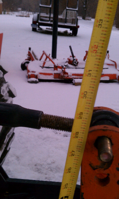

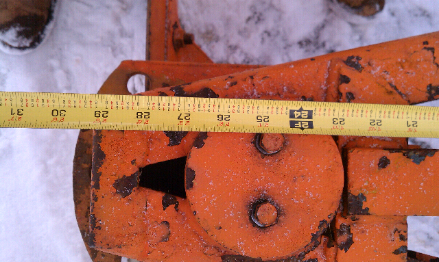

I think some actual pics may help due to my limitations in drawing accuracy.
In the first 2 pics, the blade is on level ground. The center of the bottom point is about 13" above ground level. The center of the top link is about 27.5" above ground level.
The 3rd picture shows the blade raised to max for my current setup with the blade in the reverse position. It shows about 12" of ground clearance and the blade to be about 14.5" tall. The clearance height can be adjusted quite a bit by changing the length of the top link, and where it is attached on both the blade and tractor.
In the 4th picture, the other end of the tape is on the cross bar of the A frame. It shows the center of the pivot point to be about 25" from the front of the frame.
