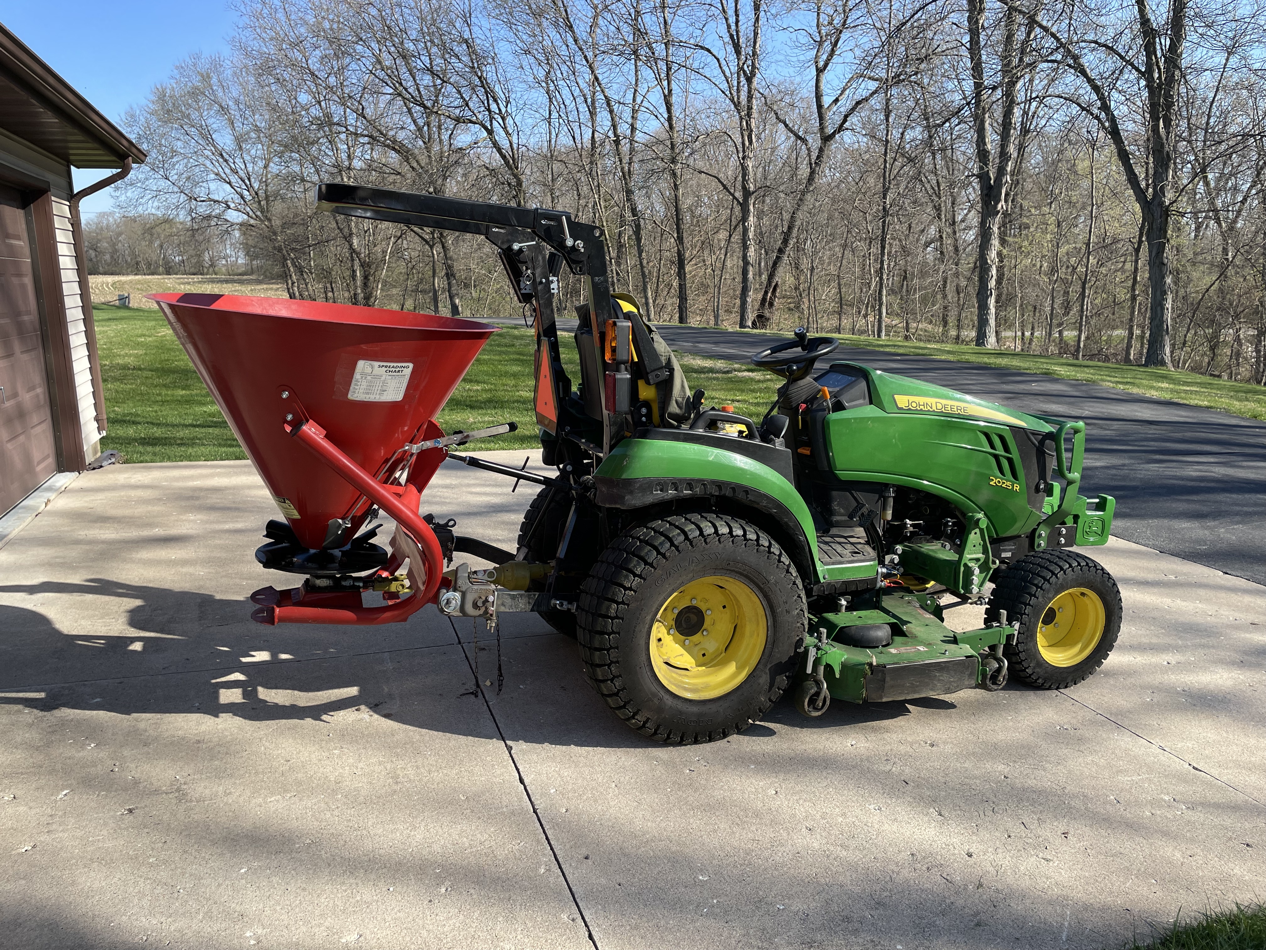

I had a Fressori spreader on my old L3430. I had trouble reaching the control lever after I installed Pats, so I made an extension with a bent piece of rebar and clamped it to the lever.
Still works with the cabbed tractor if I open the back window.

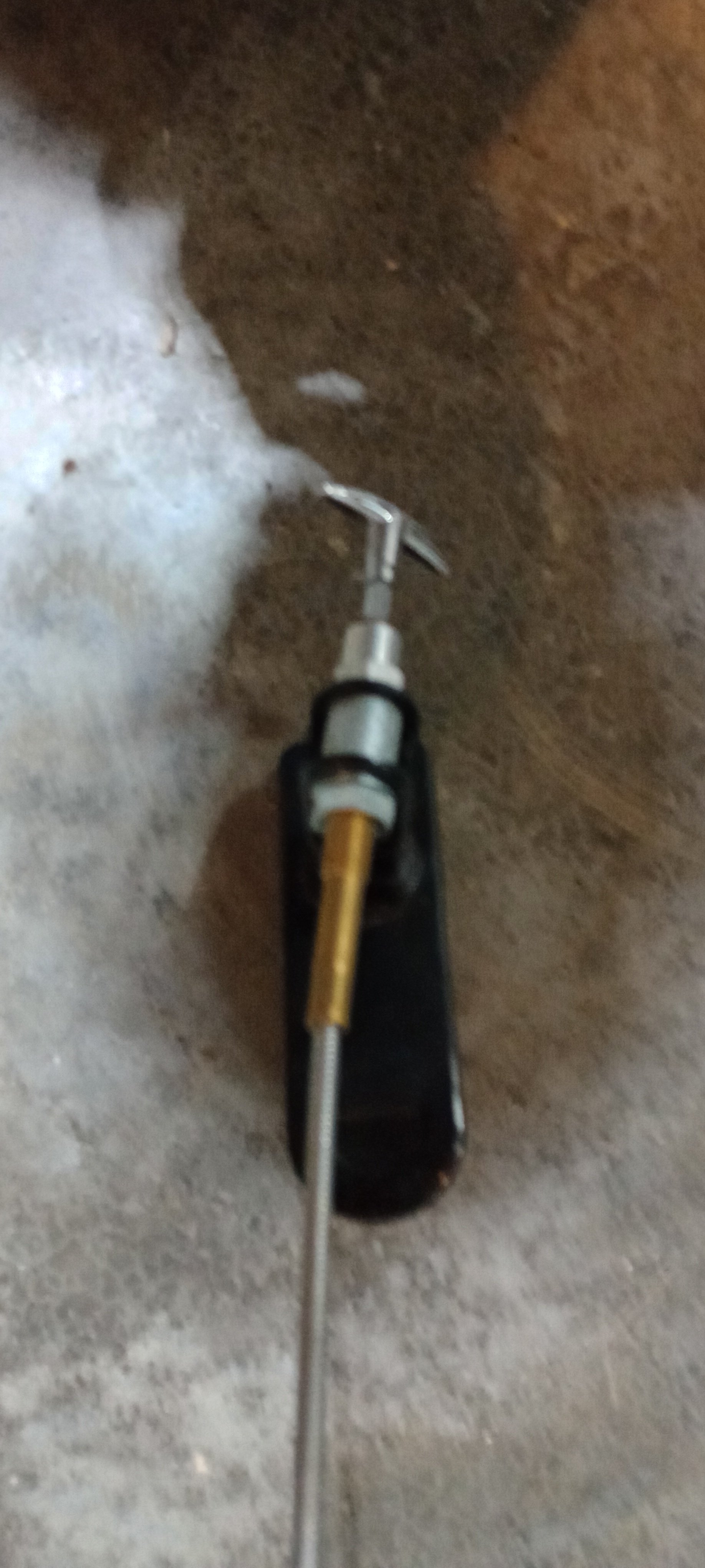

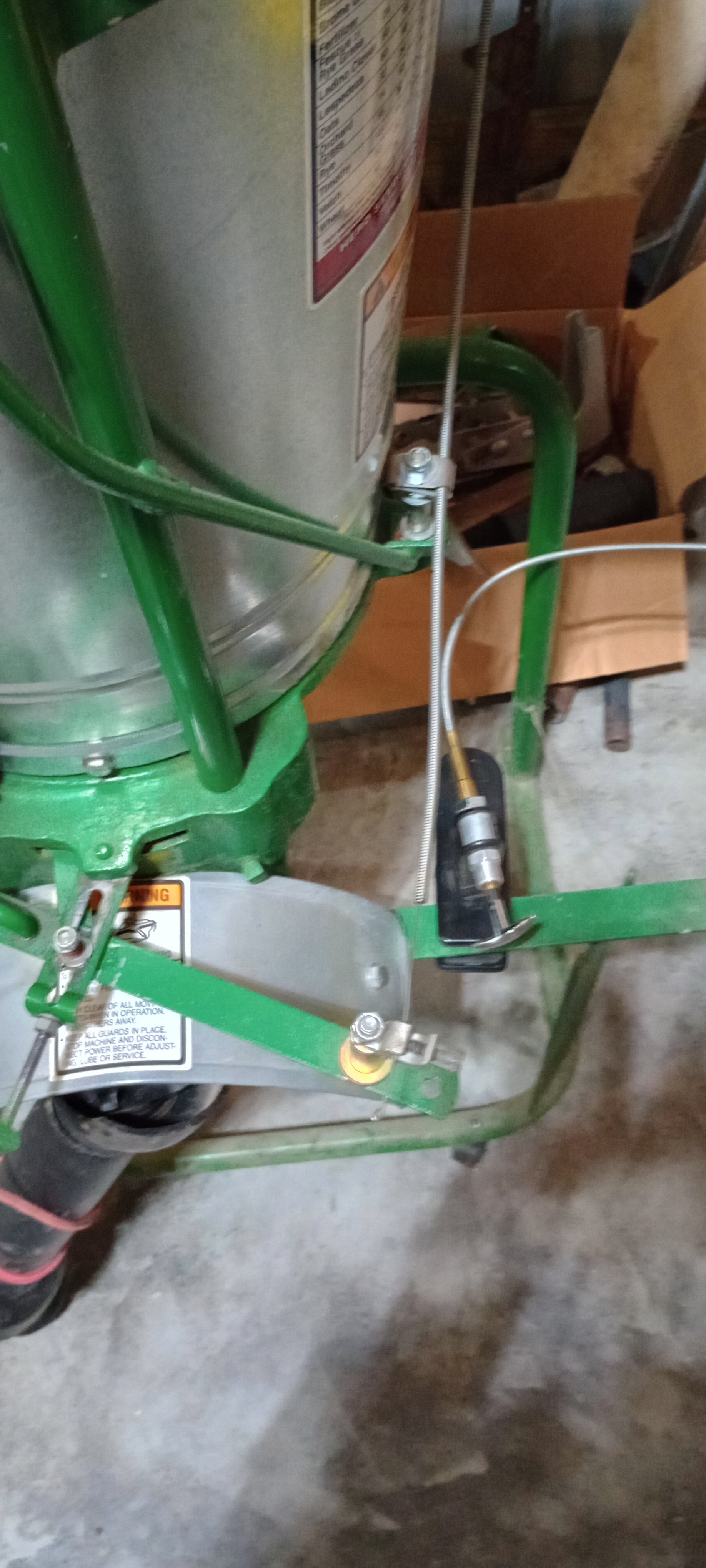

Another option is a throttle lock cable. I use one on my herd spreader, open the back cab window feed it through and close window. Works like a charm. You can pick one up at any auto parts store.
