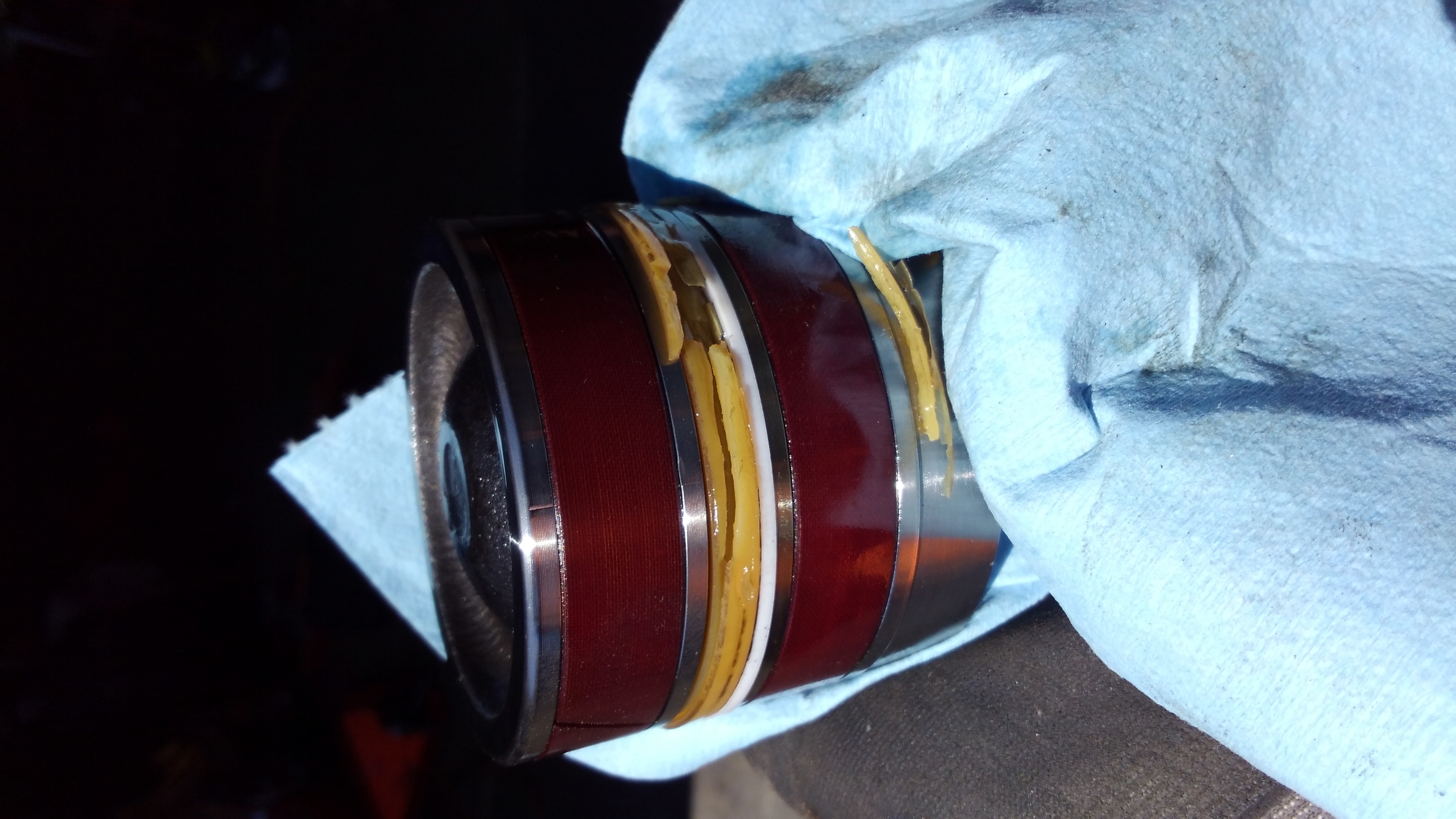

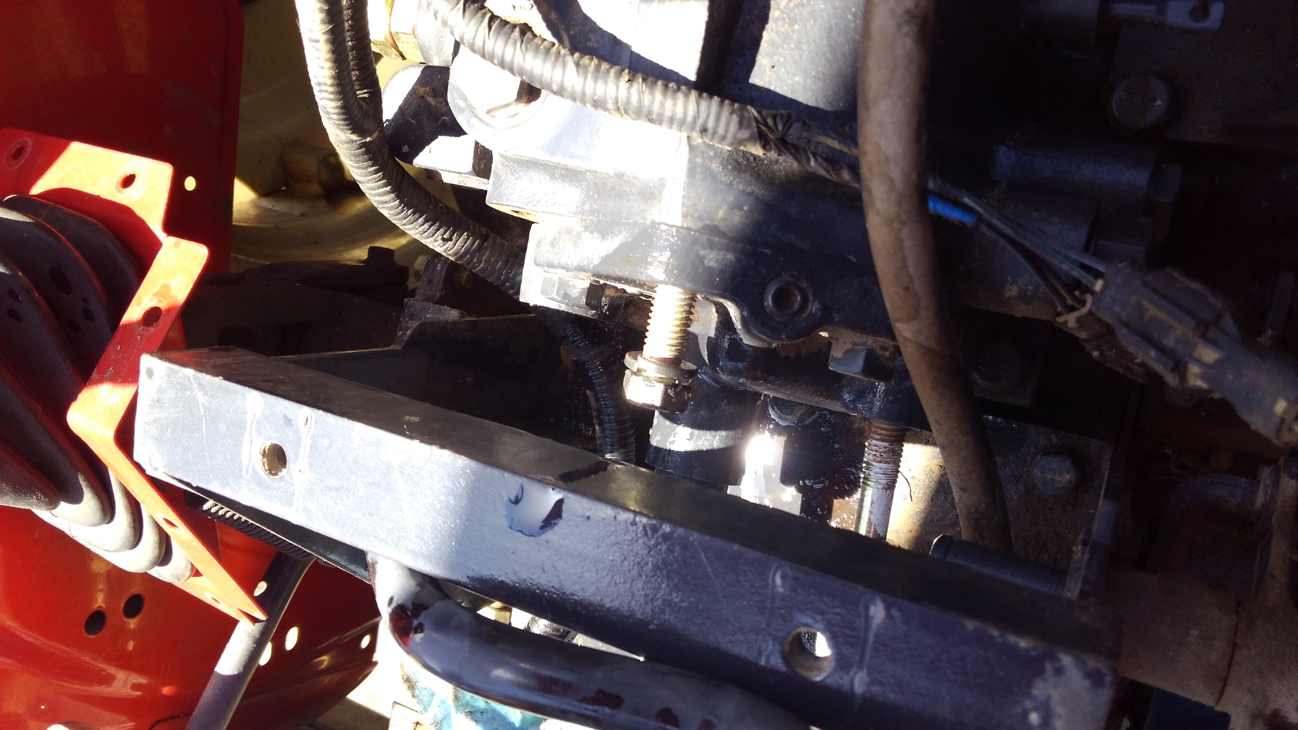

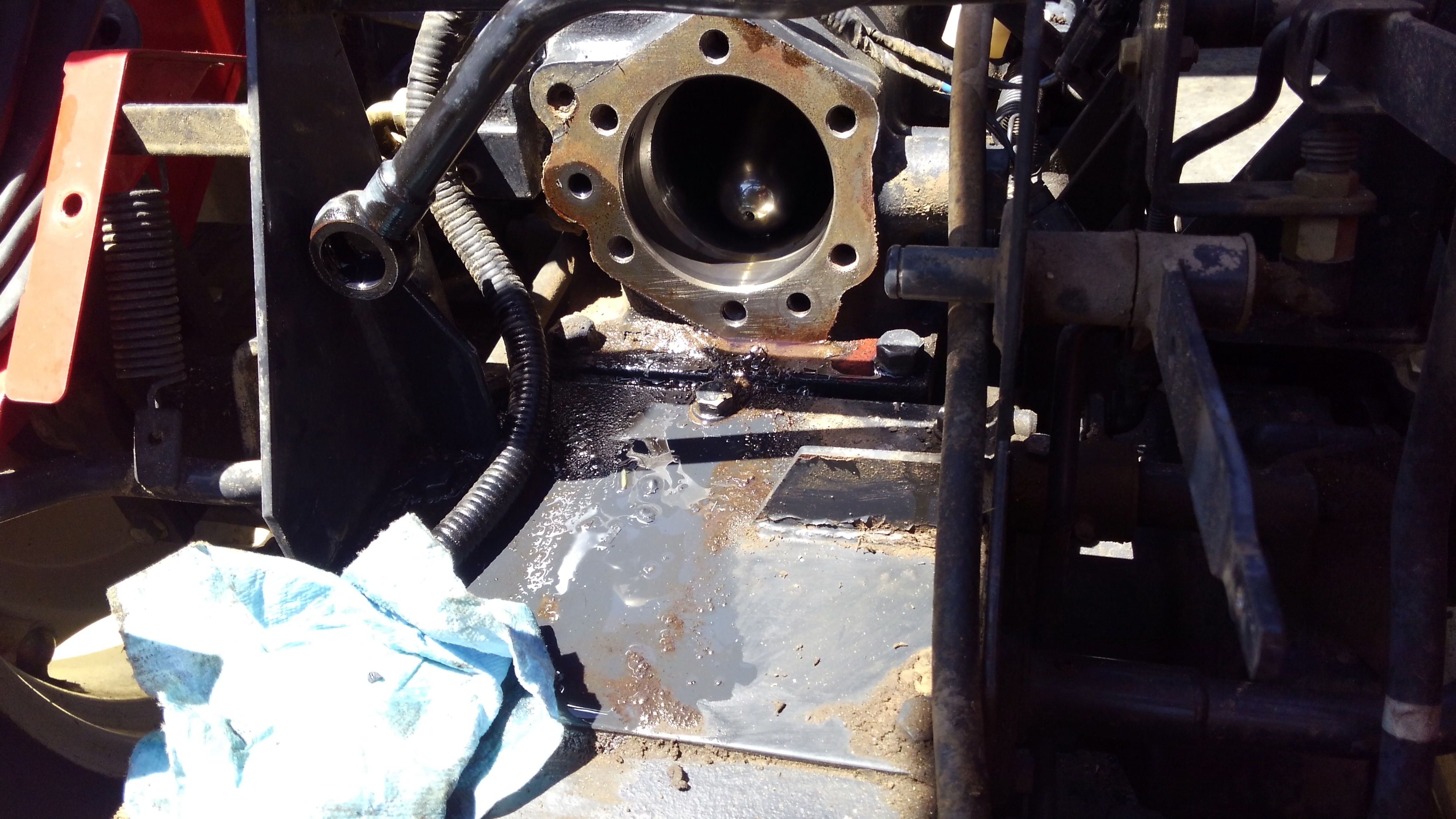

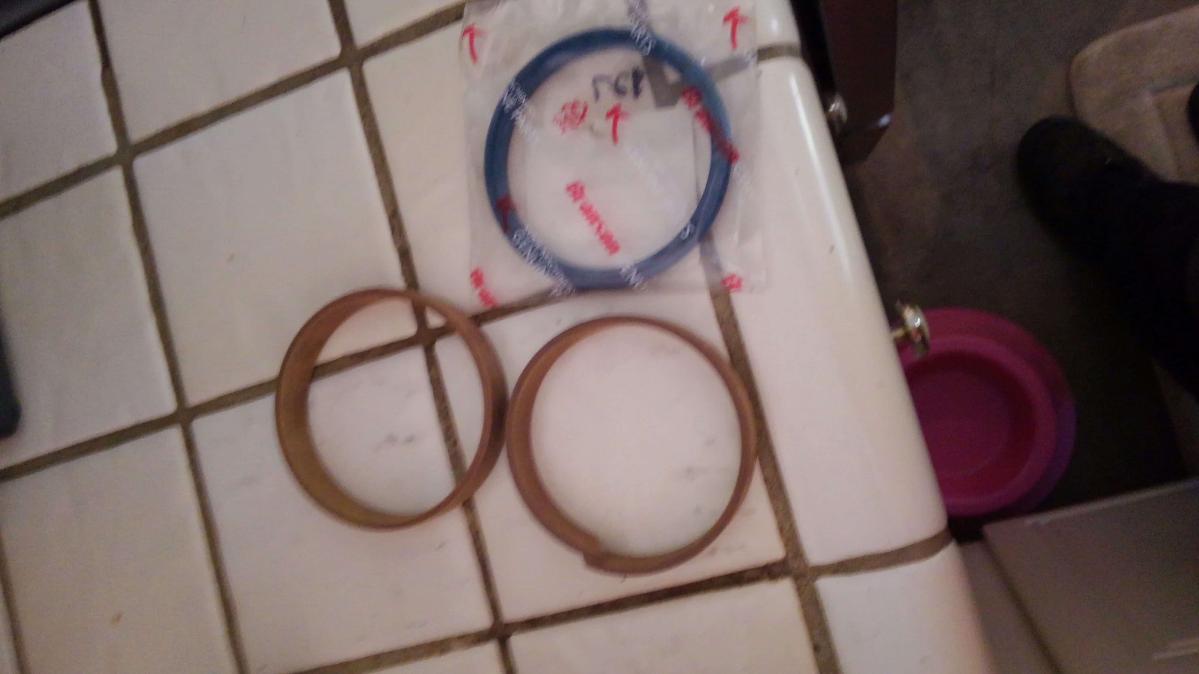

Got it done, wasn't too bad. Just like Dave mentioned. Took everything apart to access the top of the rock shaft, the cover you need to take off is the one with the 3pt valve attached to it between your legs. The seal Dave mentioned was of course obliterated. So once the cover is off, just bounce the 3pt arms up and down to push the piston out, remove the old seal and guides, replace with the new ones, and reinstall. Simple process really.

$120. The Branson seal had $27 written on it. Either way, just glad its fixed.

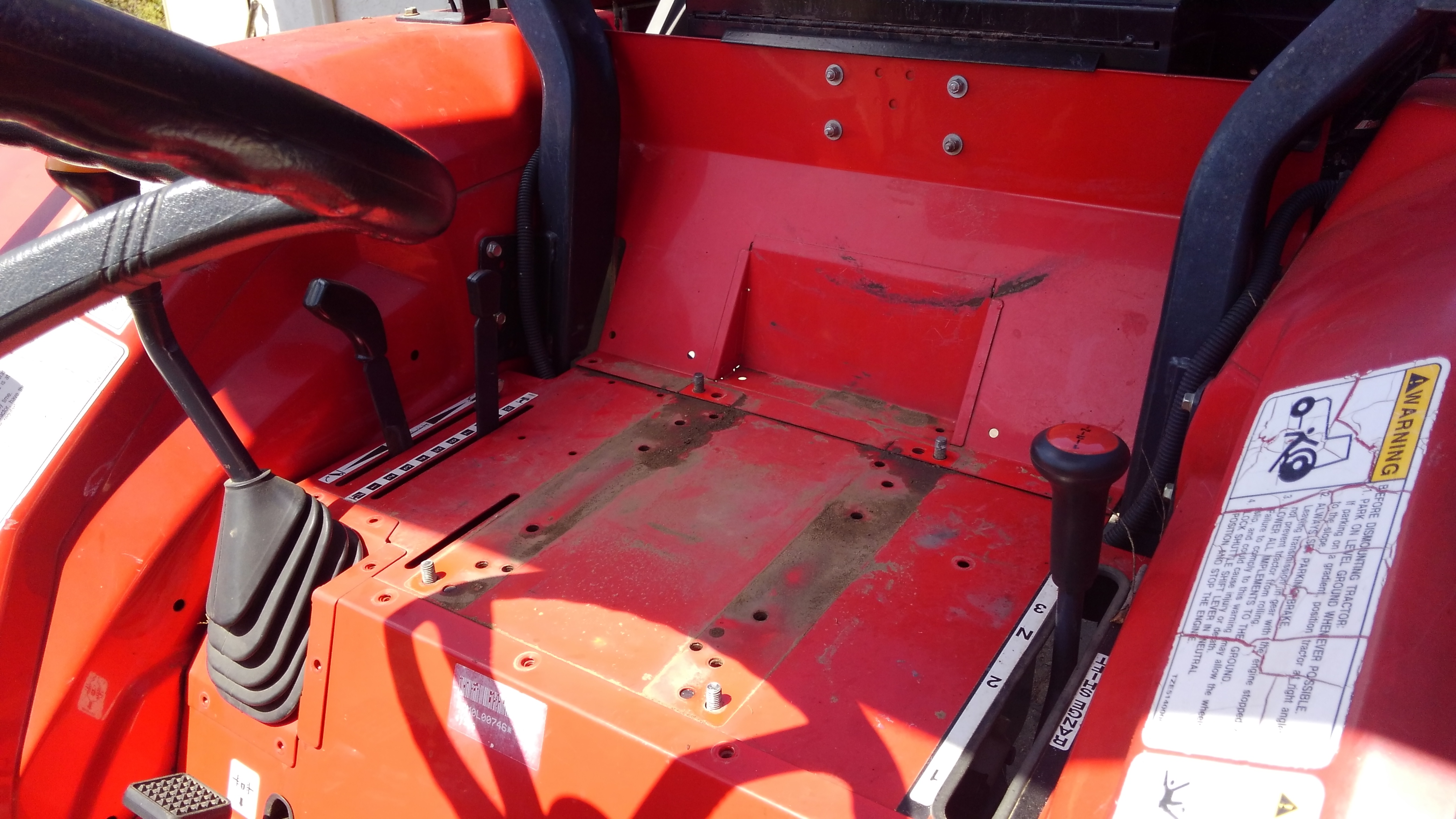

what exactly did you have to remove to access it..?

I removed the seat, plate beneath it, and the plate the covers your MFWD and PTO lever, then finally the bracing that holds the seat.
How is that done ? by hand lift and lower the arms?
Yes, just grab the arms by hand and bounce it up and down (not violently, you'll see it coming out slow with each up and down motion)
