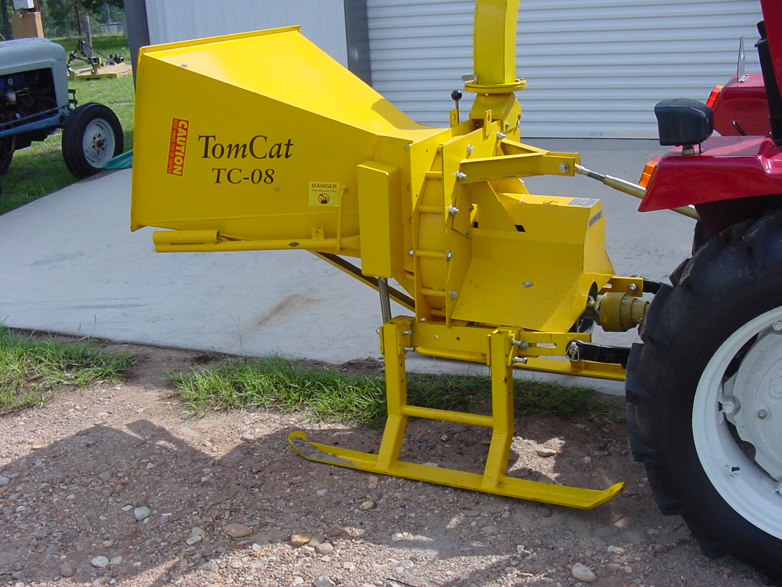

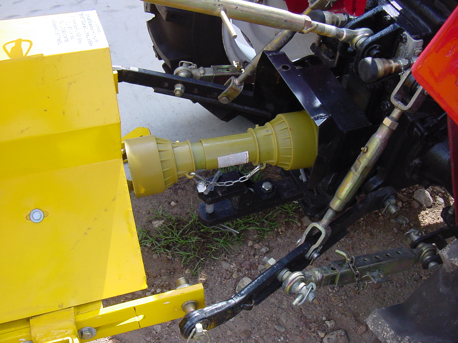

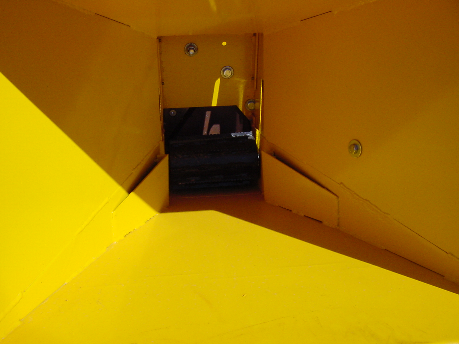

I have sold the Jinma woodchippers for years,no major problems.We now sell a unit we branded as TomCat that uses 95% of Jinma parts but this factory made some changes for us that the customers asked for,1- 360 degree discharge chute,2- adjustable leg height,3-upgraded feed roll driveshaft,4- some plates inside chute to help keep the vines off the sides of the feed roller,8" capacity.We also keep all the parts in stock.I have put them on several 20 hp tractors you just wont get the full 8" chipping capacity,they weight 850 lbs so it may be a little big for your tractor.My personal opinion is they are a great value and you will not find anything this size that will compare in price.
