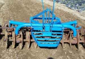

/ 3 pt disc
FWJ,
know anything about ford ferguson disc? I have located one of them also, from the pic it looks similar to MF with handles to adjust, but the rear has a big basket/rack looking thing on it?
/ 3 pt disc
Here is my attempt to post a pic.
Ford ferguson 6ft disc
[/IMG]
/ 3 pt disc #9
Same disc..... The Ferguson model became the MASSEY Ferguson #25 after the merger. The weight box on the painted blue disc would bolt right on the MF#25 in the last picture. You'll see the brackets right next to the lower link pins. The weight box was an option from the very first all the way through 'till the very end of production on that disc. Not real common.....and they can tend to get in the way on some smaller tractors.
Here's what I started with.....This is a 8'-10" MF #25.
And here's what I ended up with. It's now a 7'-6" version. I removed the axles, cut them down 7-1/2", rethreaded the ends, re-installed with one less spool and one less disc blade per gang, then cut down the scraper bar to match. You can do the same, only remove even one MORE set per gang to build a 6'er.
