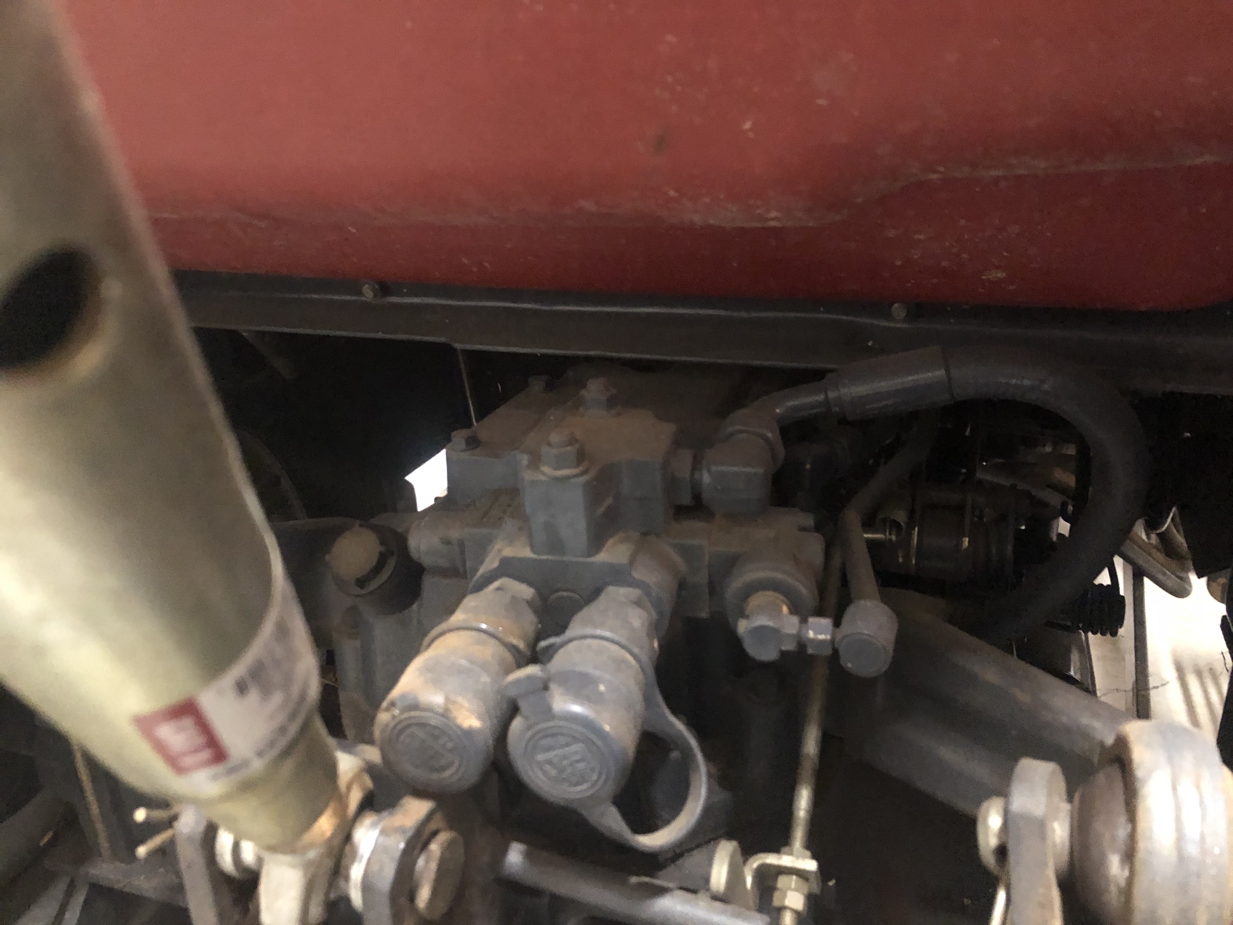

Here are my remotes and the excerpt from the manual. It suggests holding the lever in push or pull position will cause the oil to travel through the relief valve and cause it to overheat. There is no detent on the lever or proportional valve that I can find. If I use a bungee cord will this cause the oil to heat up or will the oil flowing through the splitter act as a heat sink?
   / 3 pt Log Splitter #34
The manual is talking about holding the handle into the on position, when it's NOT hooked up to something.
SR
   / 3 pt Log Splitter
#35
Got it, thanks SR
