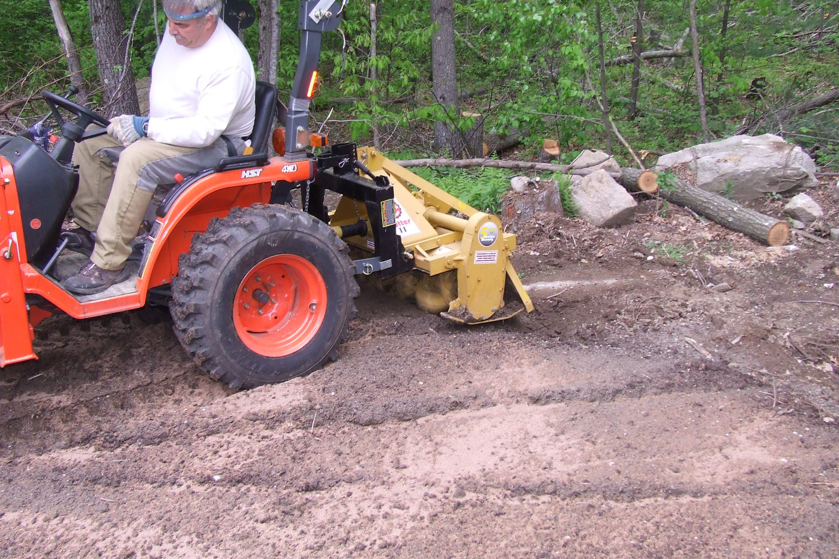

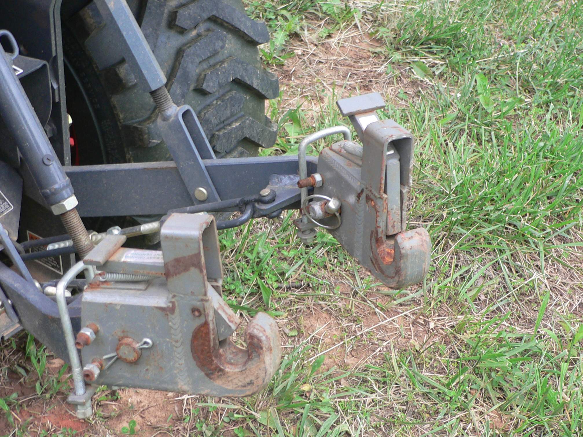

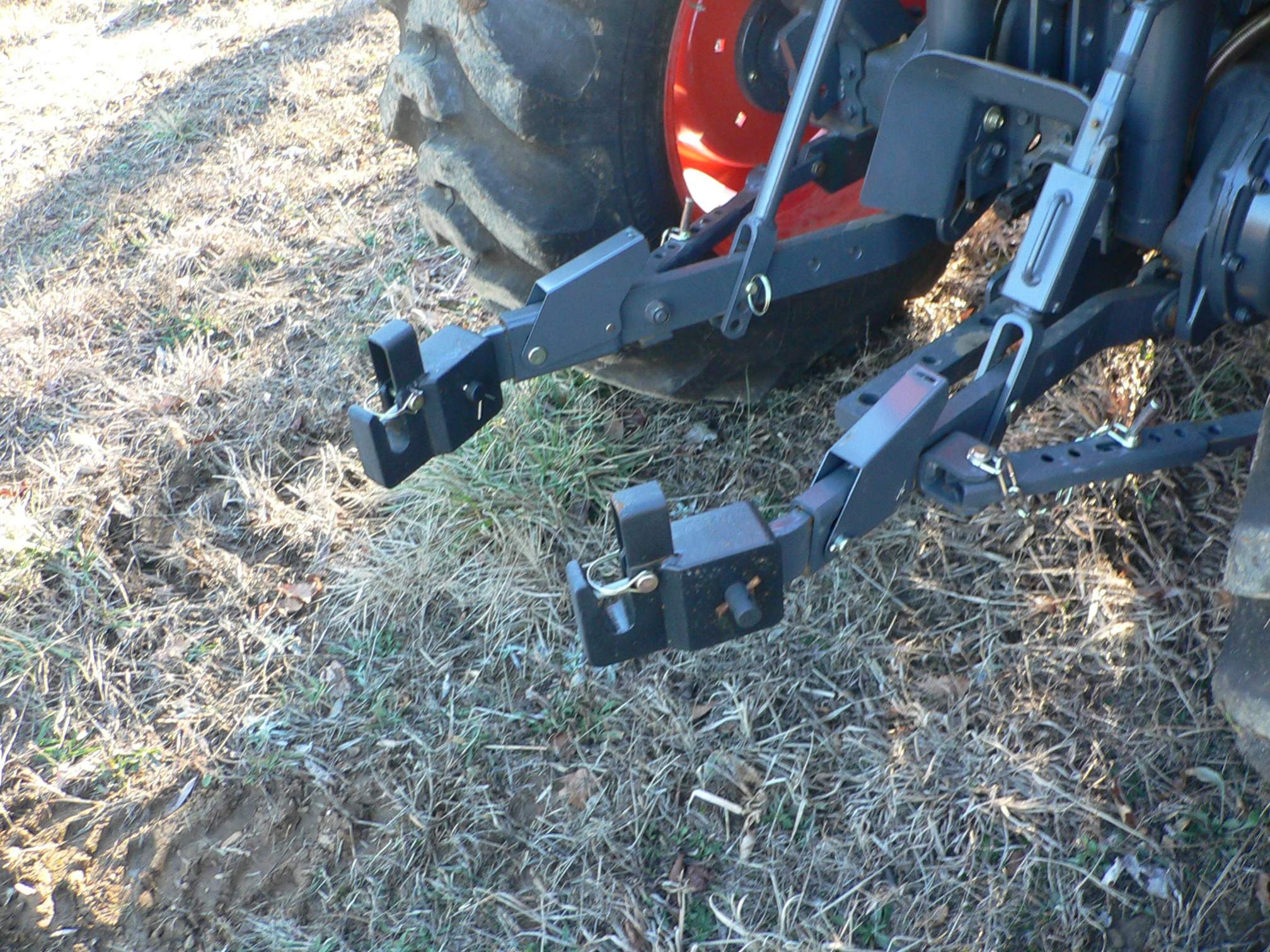

These 3ph quick attaches make hooking up implements alot easier. Pat's and the no name ebay ones. Best money I've spent on tractoring add ons. Some people drop implements on roll carts which are great if you have a concrete floor to roll them on, I don't. Always drop implement on flat and level spot. Last week I helped neighbor attach the Kubota tiller he bought from me. Had to unhook it (he had arms attached but couldn't get drive shaft in) and install drive shaft first then attach arms. Also a strong helper is good but 3ph QA with roll cart makes it almost easy.

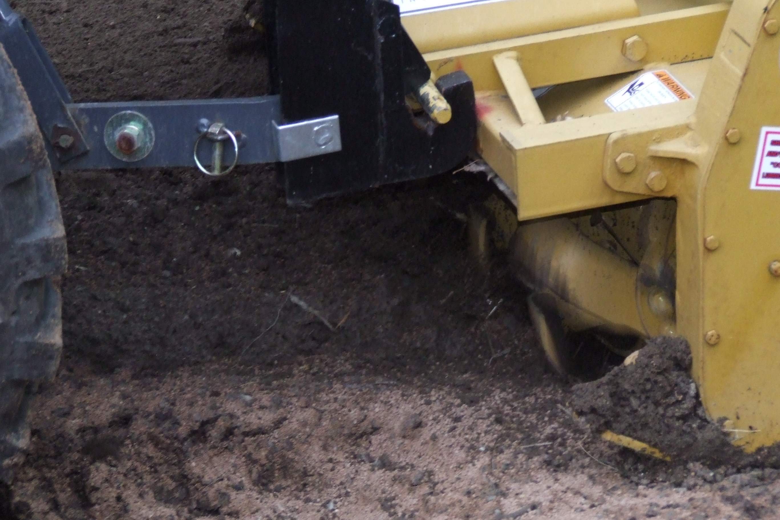

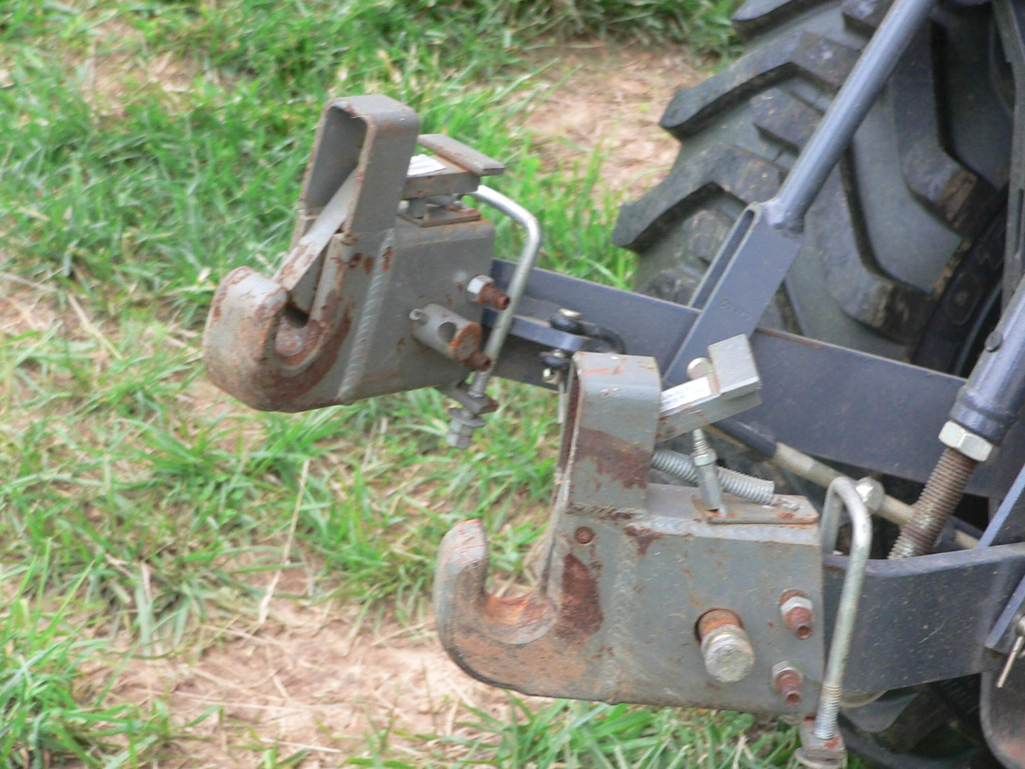

My tiller works great on my HF quick hitch. I didn't have to cut down the PTO shaft and the connection is simple. I had a little grinding to do on the quick hitch bottom hooks so they wouldn't jamb between the pin and frame. Usually, when I can't get the bottom hooks to reach far enough, I make sure that the top hook isn't too far out. I know that sounds way too simple, but if you get the top hook to engage just before the bottom hooks slide up to the pins and then LIFT with the 3 pt hitch, the tiller will swing and drop into place. (Use the top link to bring the top hook closer or farther away from your tiller.) My shaft will hook up after the connection is made and help avoid dropping the split, greased shaft in the dirt. That NEVER happens!:rolleyes:

I don't get how one guy does not have a problem with the arms going in. I don't have a problem with that because I use the 3ph quick attach, it just lifts up under the implement pins. that's problem #1 with me. Is there some say of holding them out to the width of the tiller/box scraper hitch brackets (of whatever they're called . . .the things I put the ends of my pto arms into)? I used a piece of tree limb yesterday until my wife showed up and helped me. You can cut a board or pvc pipe to proper width for each implement then notch it to fit over arm and stay in place.I try to keep those things as tightened down as possible (I don't keep mine tightened down as tight as possible so I have no problem with this)and don't like loosening and tightening them each time I hook up.

Looks like you need to order a set of 3ph quick attachs.
