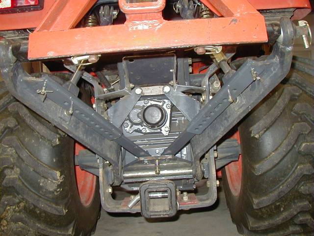

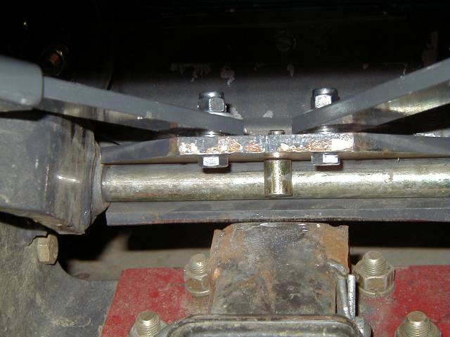

Got a set of Pats Easy Change and replaced the turnbuckle PITA with telescoping stabilizer links and made life a lot easier. Do a search on Telescoping stabilizer links and you'll see how easy it is to switch from the turnbuckles, cost about 60 bucks for the parts. Here's one link that I found,http://www.tractorbynet.com/forums/...ng/49403-b7610-3p-stabalizer-replacement.html all you need is the two tubes with the holes and the two bars that slide inside.
