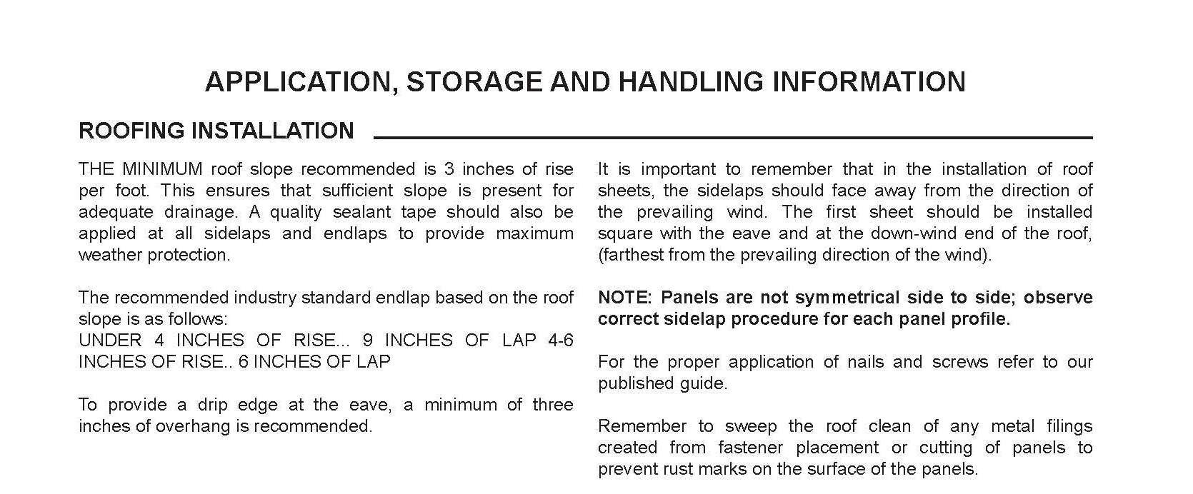

I think everyone here is giving lots of good information and references so you should be in good shape on sizing. The only caution I would throw in is to be careful on the roof slope, with snow loading. A shallow slope will leak a lot quicker and the snow will not slide off so easily. Your plan looks like a 1 in 8 slope. The metal roofing companies will tell you that they are designed for a 1 in 4 slope as a minimum. If I were doing it, I would raise the front by another 1.5 feet and, if I felt ambitious, add an overhang, sloping back down like one of the examples posted, to provide a little more protection.

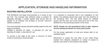

Interesting. I'm attaching a sheet from a roofing supplier that says 1 in 4 is minimum recommended. I guess there are different approaches.
