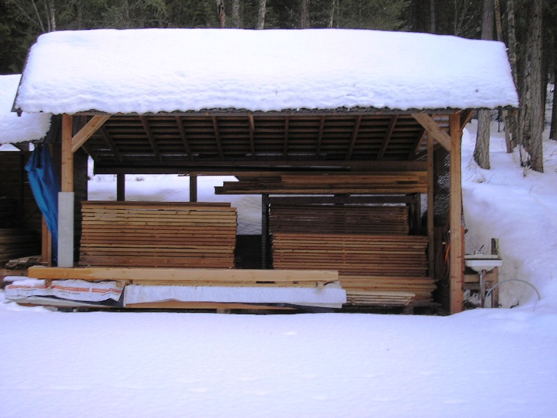

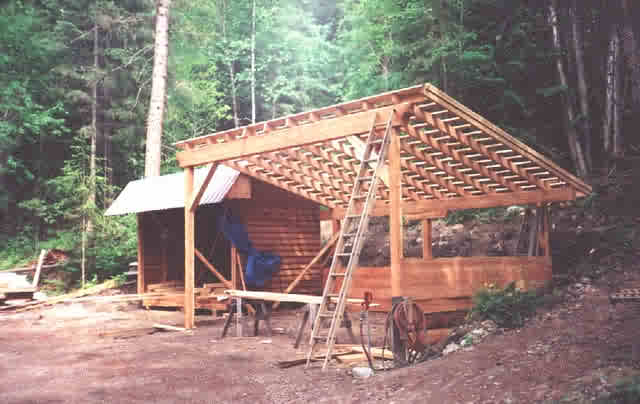

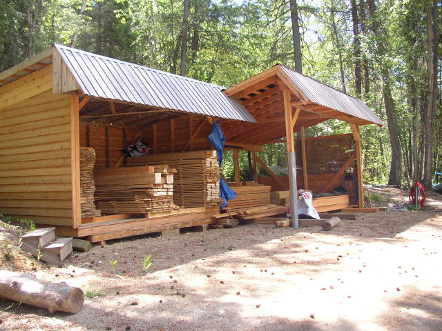

This shed is 14' deep ,16' between posts in front 6x12" beam,ruff 2x6 rafters 2' centers full 1x6" strapping 12" centers 12' high in front 8' at back approx. 3/12 pitch. Building is 10 years old now and had over 5' of heavy snow a few times no sags & no leaks. Metal roof with heavy felt paper under still gets condensation with the right winter conditions twice so far.

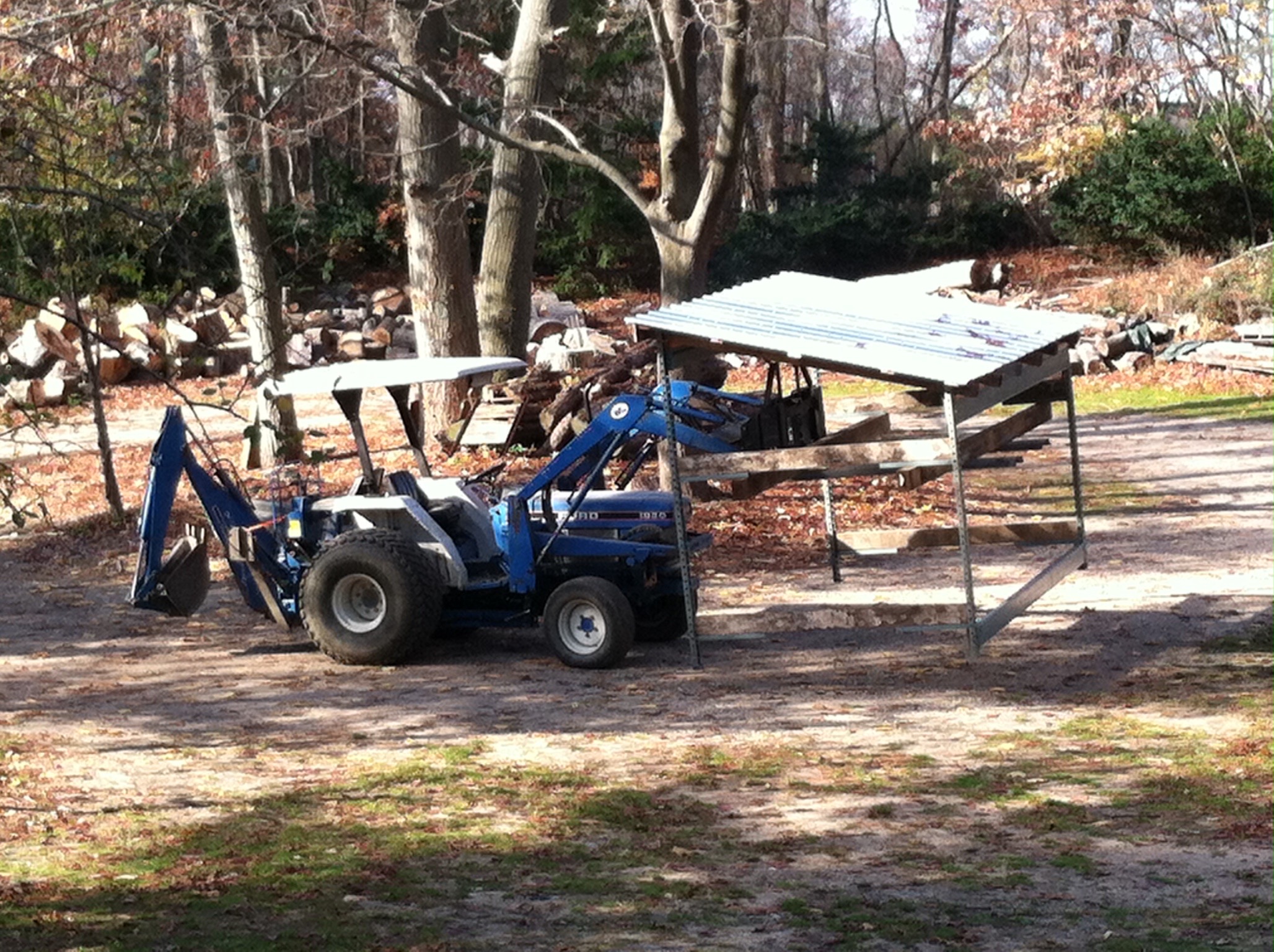

My woodshed is just a shed roof, one slope. Any pics of how to frame the front small roof.

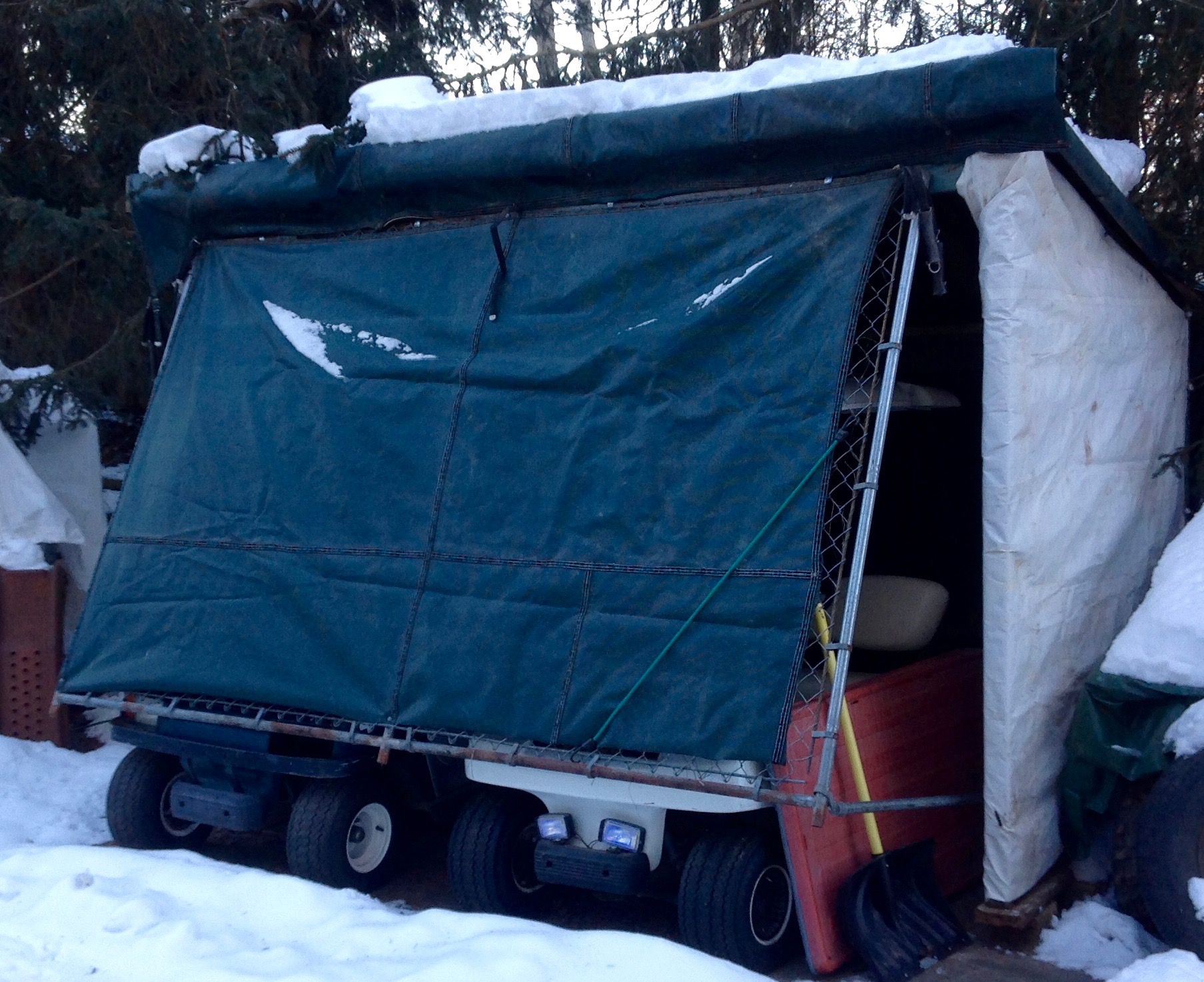

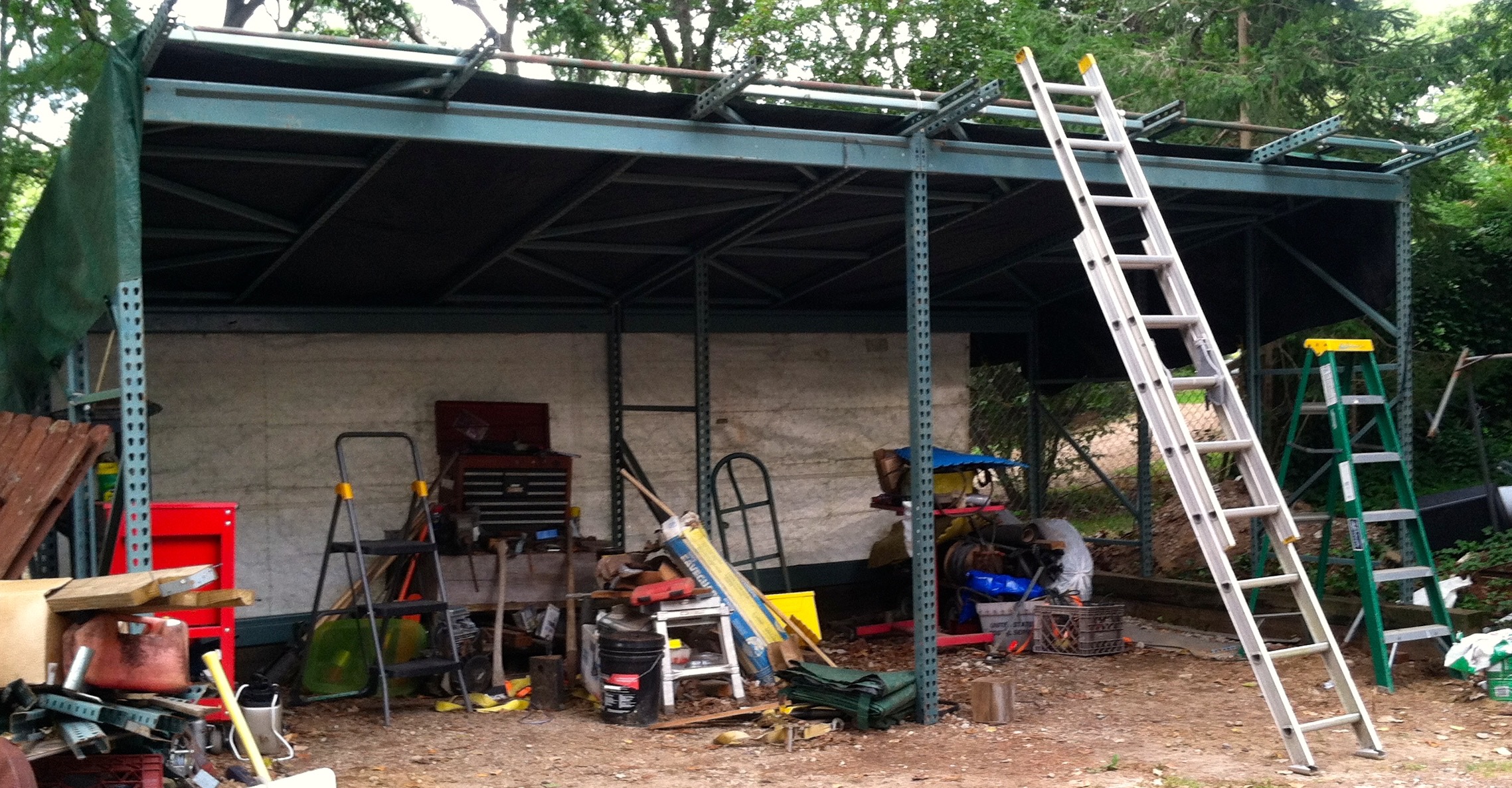

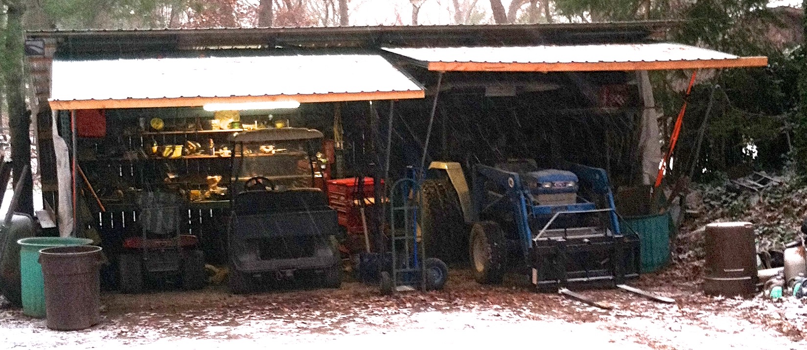

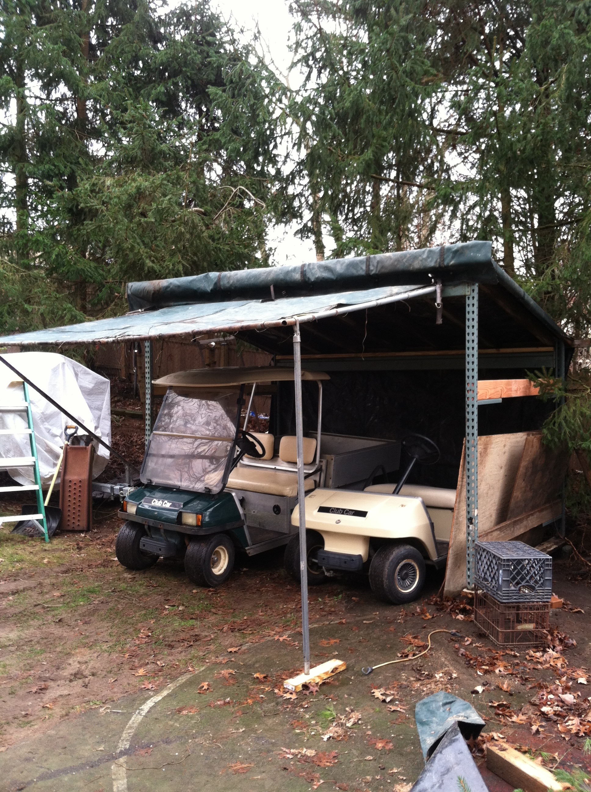

I built several very similar to this
first was for tractor over winter but eventually added a fold down awning for big snowstorms in winter.
shed is 10 foot deep and 22 ft wide 8 ft high at front and 6ft at back.
lagged down to double height 6x6 at bottom
awning adds another 7 ft of shade in summer
smaller one is 6 ft deep and 11 ft wide they are working out great
