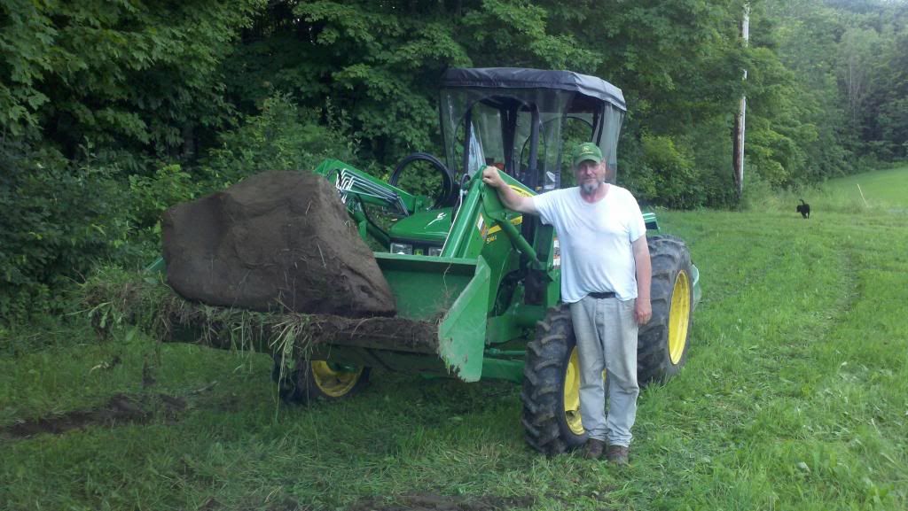

My 5045E is perhaps not a good comparison but it is a long way up from your present tractor. the 553 loader lifts 4000lbs, They are using a different model on new production but capabilities are similar. The 3 pth lifts 3000lbs. Get the telescoping draft links and at least two rear remotes with one plumbed up to a third function on the loader. Bare machine weights 5050 and the loader weighs about 1500. the 72" bucket alone weighs 450. If you do much loader work you will want the rear tires loaded. it is just a matter of safety and stability. and in addition to that if your doing heavy lifting like wet manure you need 2000 lbs on the 3PH as counter weight to take strain off the front axle. Stay off the lawn and the septic tank covers with it. Check the brakes before you take delivery as some have an over travel issue on the first pump. Also check all your radiator hose clamps early and often along with rim bolts until everything gets settled in. I really like mine, and a 5075E should be great for your needs.
