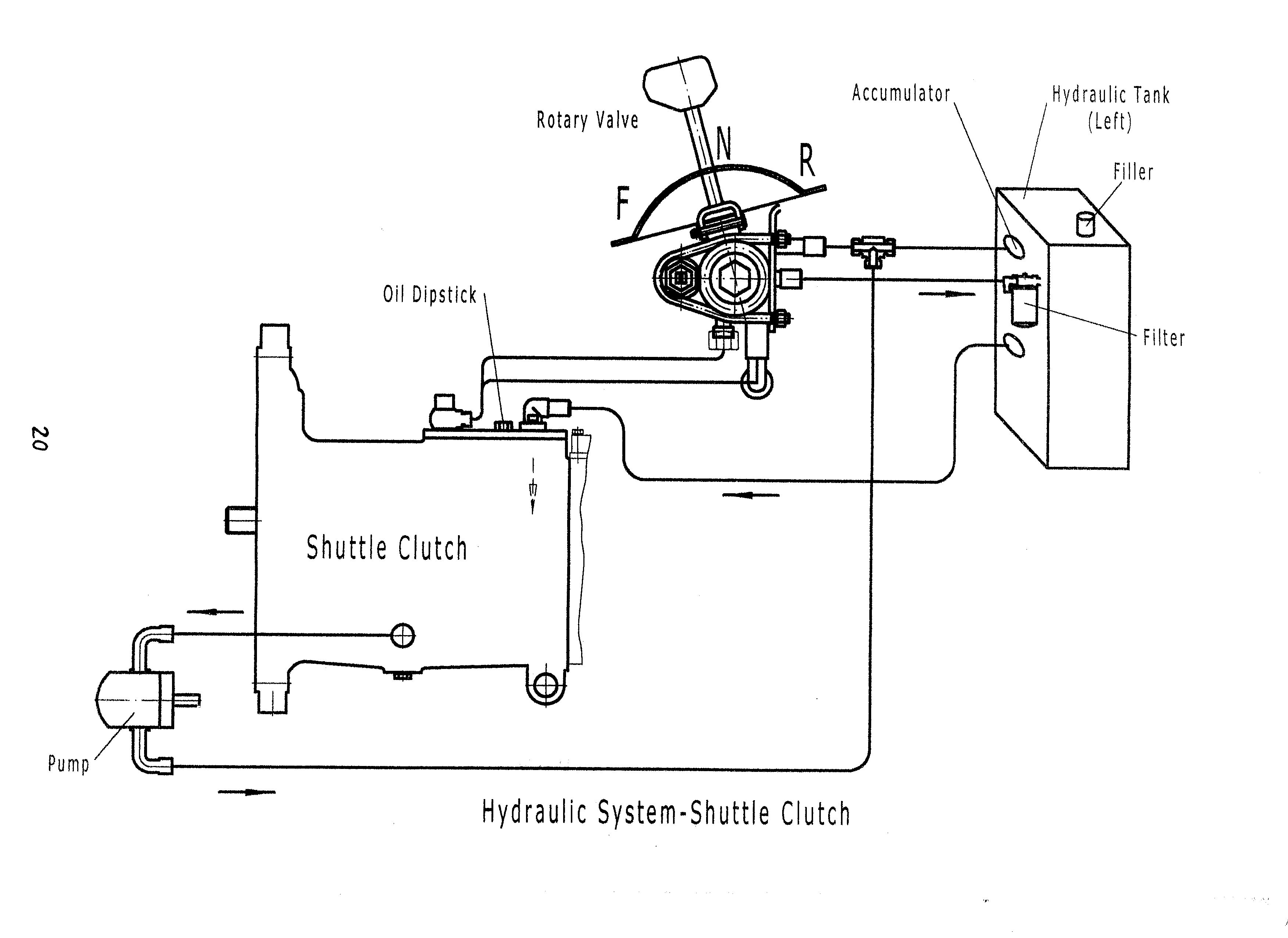

Ok have a new problem. Does anyone have the hydraulic hose diagram location for the shuttle shift lever on the left side while sitting on the dozer. I used toap to label the hoses and oil soaked the tape and they fell off. Any help deeply appreciated. Thanks
   / 30hp Chinese Bulldozer Parts #57
Does your machine have an accumulator? I think I may have asked you this before. Best way to label hoses is to take pictures with the labels on them.
   / 30hp Chinese Bulldozer Parts #58
Ya I used a metal stamp on the right side controls. Not sure but there are 4 lines that connect to the forward and reverse control. 2 lines on the actuator lever cylinder and 2 lines come from the right side controls. Wish I did take pics for backup but didnt.
   / 30hp Chinese Bulldozer Parts #59
Ya I used a metal stamp on the right side controls. Not sure but there are 4 lines that connect to the forward and reverse control. 2 lines on the actuator lever cylinder and 2 lines come from the right side controls. Wish I did take pics for backup but didn't.
Here ya go. Hope it helps.
   / 30hp Chinese Bulldozer Parts #60
............. and 2 lines come from the right side controls.
Wait, what? Don't you have two hydraulic pumps on the engine? Are you getting the pressure source from the tractor hydraulics?
