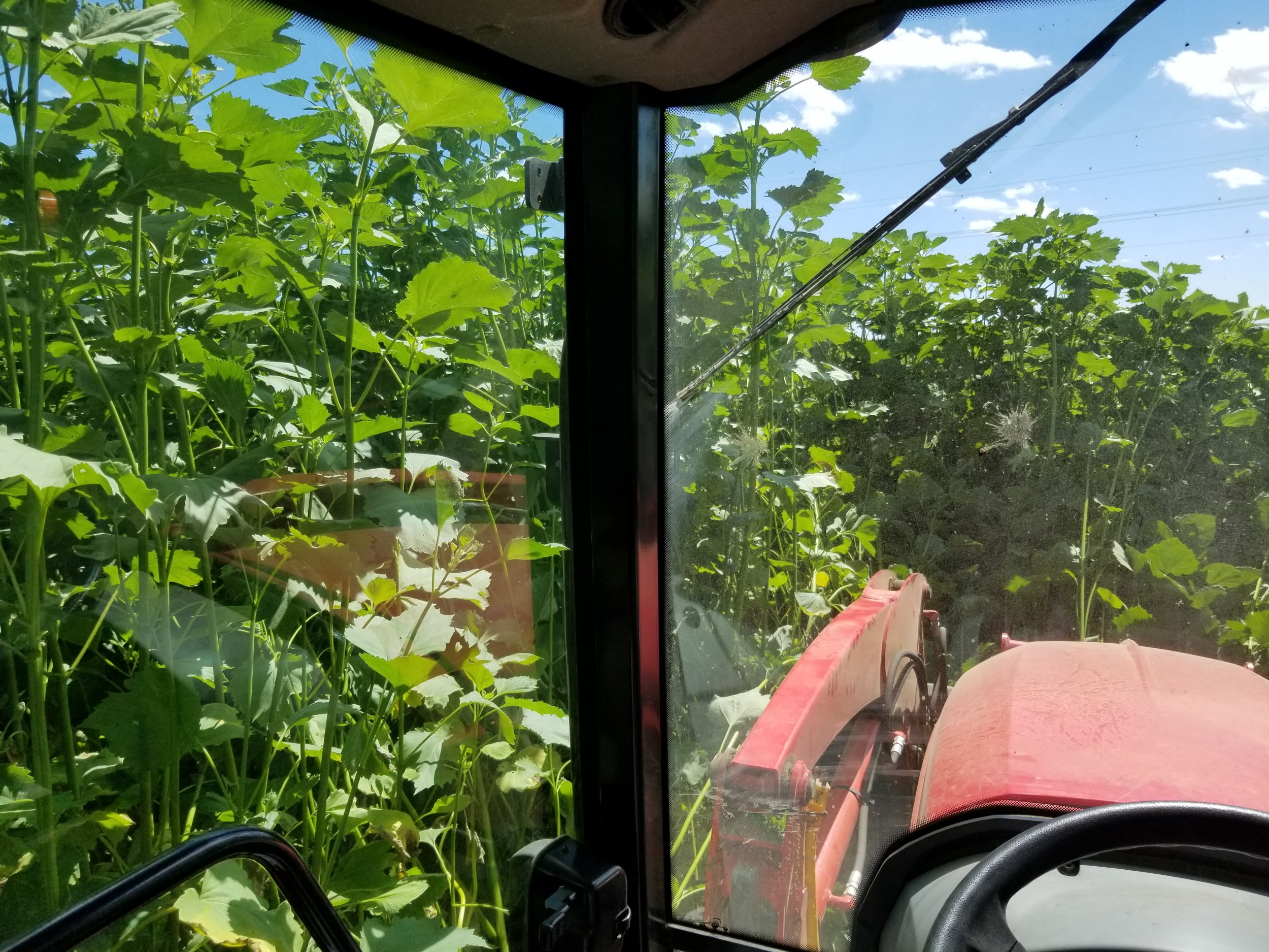

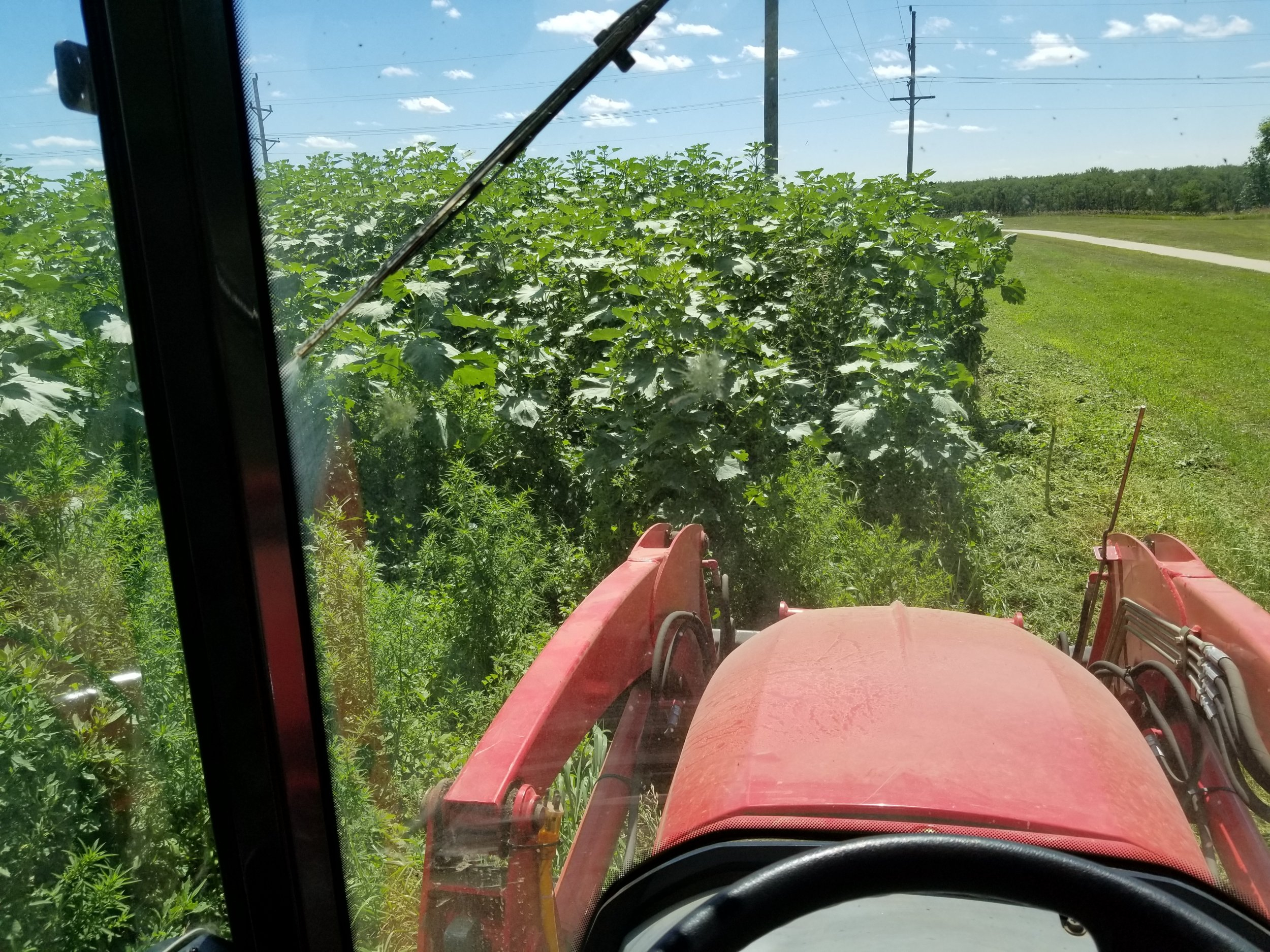

This is me cutting a field with heavy dense weeds that were taller than my tractor cab (8 feet) in some places, and taller than my hood in all places. I was literally pushing down a wall of weeds with the loader that were so thick, you couldn't see through them. My ground speed was slow right here, because I couldn't even see the ground, and was playing "blind man's bluff" with the bucket on my FEL. I'd say my ground speed was "a quick walk" as speed was concerned.
I'm taking full width passes with the cutter.
Only issue with heating up, was these fluffy little bastages (and similar) getting packed into my grill and radiator/coolers.
With enough of these little satanic fluff balls flying around, I don't care what tractor color or hp you have. They will find your radiator, and they will choke it's air supply off.
