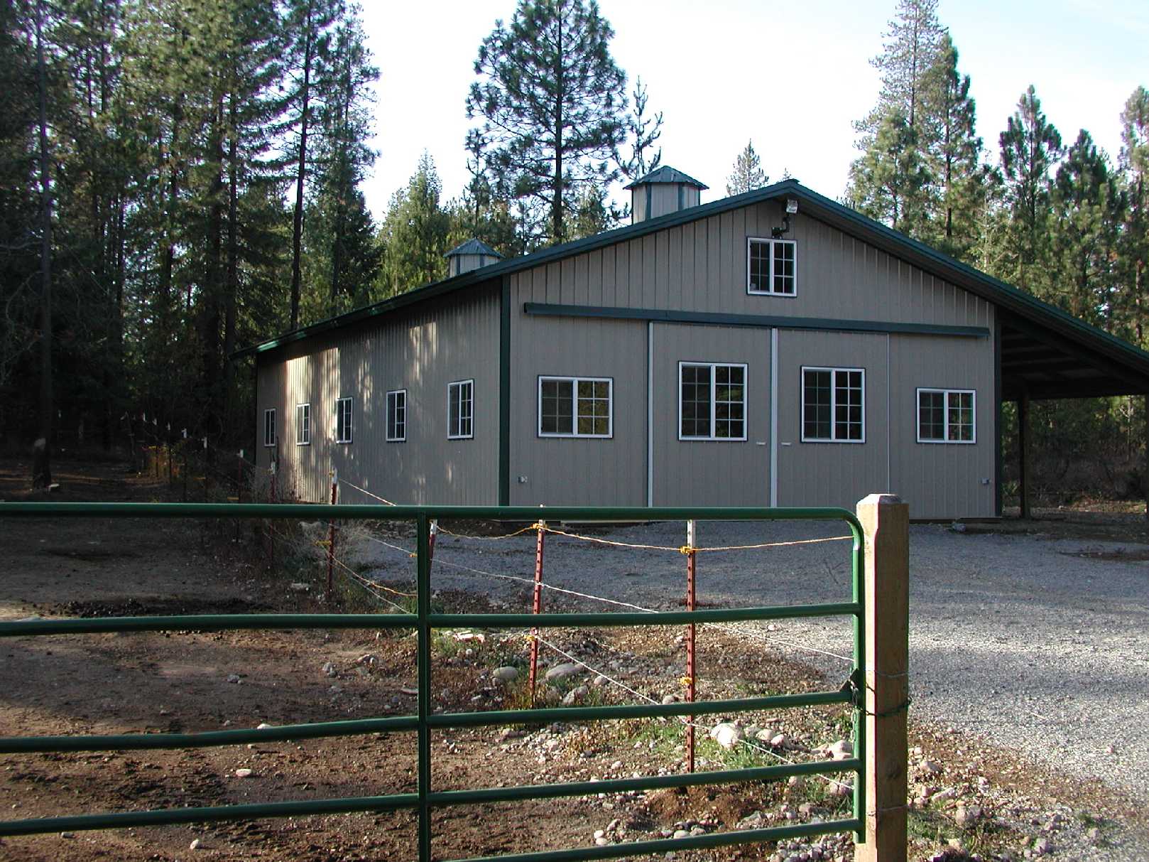

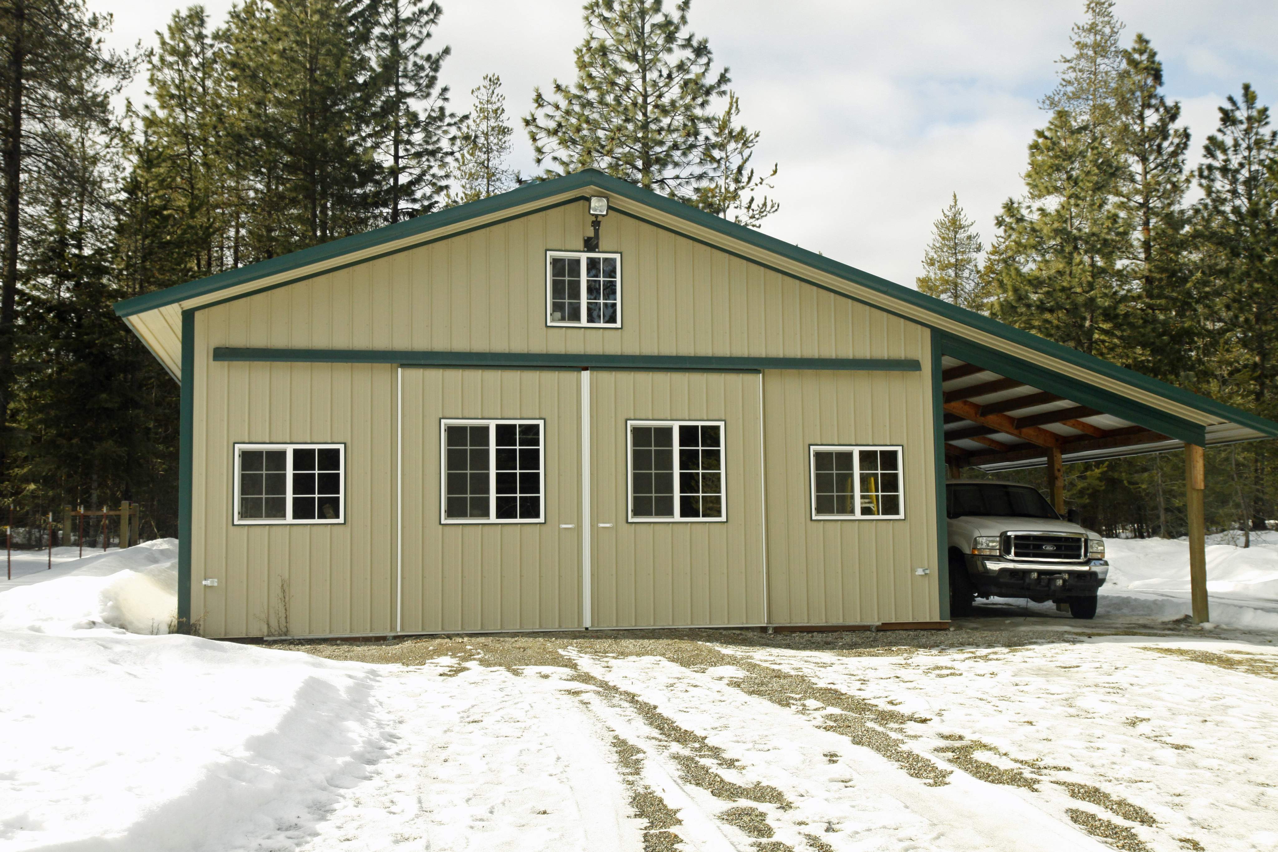

I built my 30x40x12 for $10,000 + an additional 2,500 for the slab about 10 years ago. I know the prices have risen...but 25K seems alot.
4 years ago (during construction BOOM) I built a 30x60x12 with a 12x20 lean-to, 12 windows, 2 roll up 16' doors and one set of slider doors. this ran about $32,000 complete with slab.
right now construction cost are at a 10 year low.
