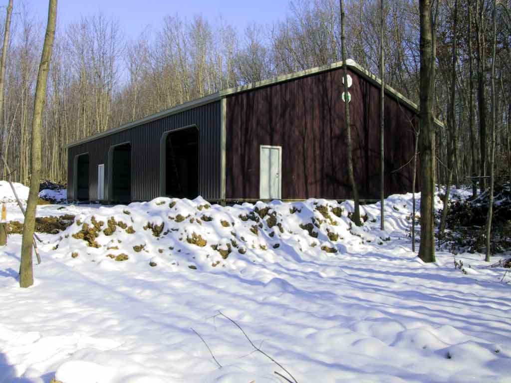

   / 30X50 barn #27
For concrete Cleary quoted me under $3 per s.f ($2.80 I think) when they were putting up our barn. That was for 4" slab, 3000 or 4000 psi with 10 ga. wire mesh I believe. Each additional inch of thickness was 35¢. They sub it out of course.
The cost on the barn shell itself was around $28K - $29K (over budget by about $1200 I think due to some problems they encountered.)
The barn is 42' x 72' x 13' with three 12' x 10' Clopay insulated commercial overhead doors. 3-ply 2 x 6 poles set on 8' centers with around 40 psi snow load on the trusses/roof.

   / 30X50 barn #28
RSWyan, that's a very nice looking building.
