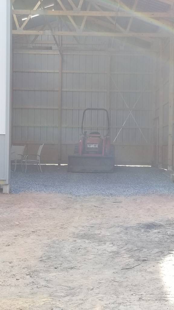

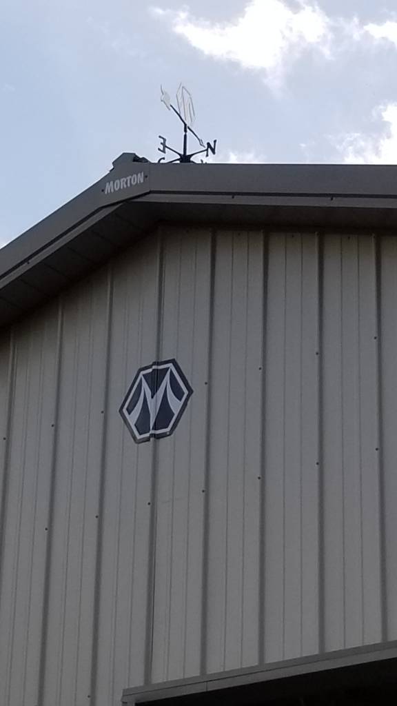

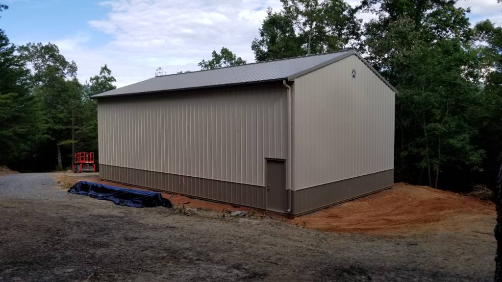

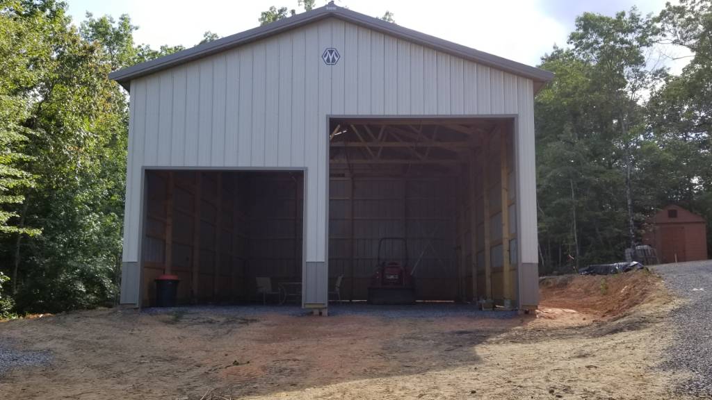

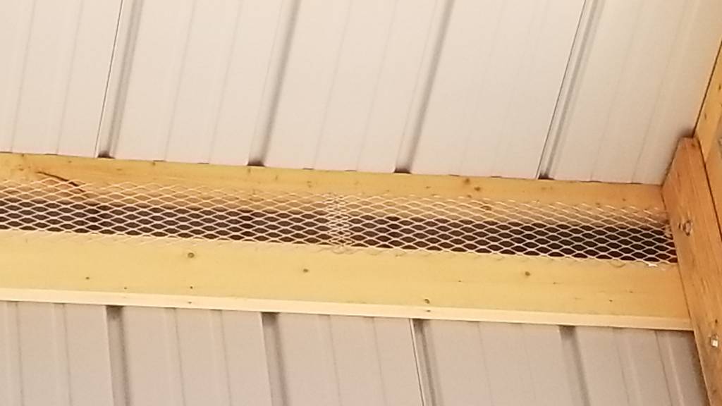

Tractor finally has a covered home, no more tarp covers ! Bird nest wire all the way around. The weather vane was a Morton barn warming gift. All the framing lumber is Spruce and the posts are laminated SYP. Doors will be installed tomorrow. It got baptized today with heavy thunder storms. No leaks....but sure was noisy ! 20180808_083526.jpeg20180807_171803.jpeg20180807_171647.jpeg20180807_171615.jpeg20180807_171553.jpeg

Nice!! Congrats.
   / 30x50x16 pole barn construction #87
Bada Bing Bada Boom!
   / 30x50x16 pole barn construction #88
Looks like you need a bigger tractor!!!!
