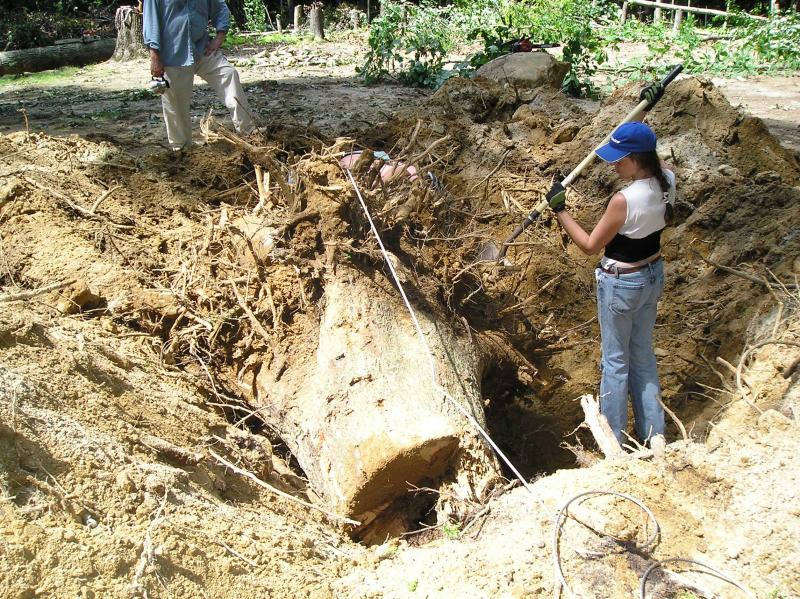

I'll repeat what's been said" keep digging". Here's a big one from last summer. Had to dig deep, then push/pull till it loosen'd and pushed it over.

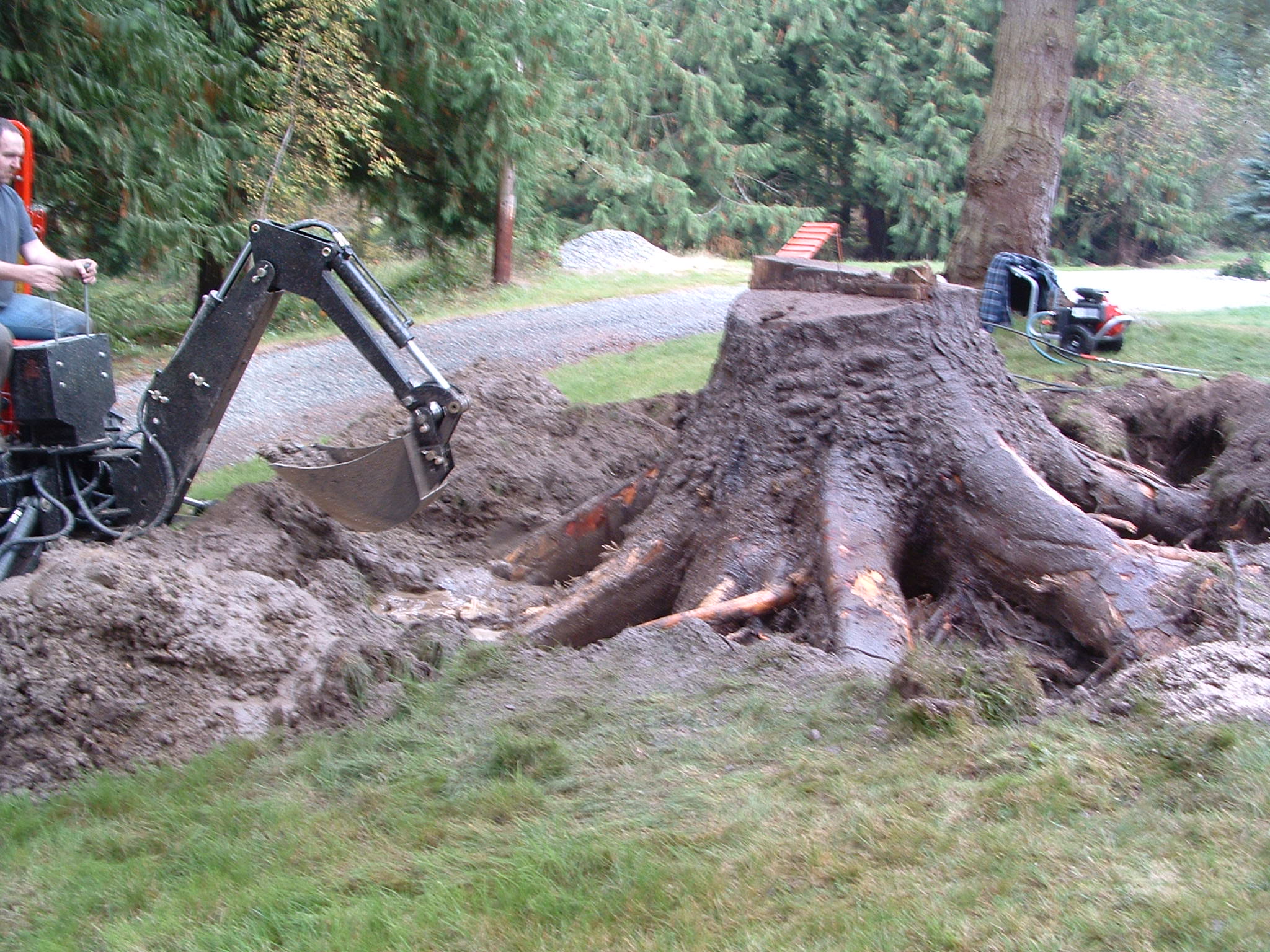

I just did one a little larger than that last winter/spring/summer. It was about the same distance from the house... One thing that worked well for me was to dig a real deep hole as close alongside the trunk as I could get with the backhoe bucket. I actually did this on two sides. Then I took a pressure washer and used that to wash away the soil and rocks into the pits. This really helps to expose the roots, and gets you some clearance under the trunk to get at that tap root. The problem with roots is that they often grow around and conceal rocks, so chainsaw work is very frustrating. Another problem is the weight. Don't be deceived by that stump. That is the wetest wood on the tree and that stump you have probably weighs in at over a ton. You can expose and clean the roots with the pressure washer and more easilly cut them. But then you have this 2000+ pound stump setting in a basket of it's own root stubs. You just are not going to be able to move it any appreciable distance untill the tap root is cut, as it has to go up and over the roots.
The tap root is usually encrusted with rocks and in my experience VERY difficult to cut. I actually had the best results burning thru the tap root. The cleared space under the stump makes a natural oven. I used a 4" radioshack 12VDC fan connected to a 4" piece of round metal ducting about 3' long to feed air under the stump and into the heart of a very small but fiercly burning fire. A 12V car battery will power this fan for about a week, so you can easilly use a vehicle battery to run it. I kept this fire pushed up against the taproot and occasionally broke away at the surface of the root with a long metal pipe to help the burnthru. It has to dry out some before it will burn thru, so even this takes a while. Did I mention be patient:) Mine was a little bigger and probably close to 3000 pounds. It took many hours of work over several weeks to free it. It was also all my 30 horse 4WD tractor could do to drag it up and over the root stubs. It would not drag well, and it was right at my loader limits to roll it over and over to get to my burn pit. Here is a pic of the monster. Our house is about 15' from the right hand edge of the stump.
Good Luck.

Lots of good input so far, thanks... I am considering using the pressure washer technique and I also have 9500 lb winch on a Jeep and snatch strap that I could use it that would make a difference. But, first I'll continue digging tomorrow...
RonMar, that sure looks larger and has more side roots to boot.
