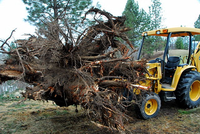

When you have dug to the maximum reach of your hoe, all the way around the stump, and given it a good pull with the winch and added push with the tractor, and it still doesn't come out, then consider burning it or blasting it. Dispite being so close to the house, by the time you're at this point, you won't care if it takes out the house, you will be so frustrated by the stump. Hang in there, as it has been mentioned several times, persistance is what gets stumps out!! Getting in a hurry and trying to speed things up tends to break equipment and hurt people. Take your time, and keep digging! When the stump is ready to come out, it will just fall over in the hole, and you can drag it out via the ramp you have dug on one side of the hole to get your tractor into the hole with it!

I'll repeat what's been said" keep digging". Here's a big one from last summer. Had to dig deep, then push/pull till it loosen'd and pushed it over.

While leaving the stump taller would have helped, not cutting any of the tree is even better. The canopy on top of the tree will take it over nice and easy. Just dig your hole around the base, and then push it the way you want it to go. Depending on soil and roots, some trees go down with just a small trench on two sides, others need allot more dirt taken out. Either way, there is no tree that's too big to take out this way.

If it was out in the open, I may have tried something like that. Here is a picture of it where it fell. We took it down in Feb. As you can see on the left, there is a group of 3 similar sized Ponderosa Pines where the branches in the crown are sort of in the way, and on the right is the house. I only had a window of a few feet left or right where I could drop it. Fortunately, it fell perfectly where I wanted. Turns out that we removed the deck anyway to re-do it...
Well, off to do more digging. I think I'll try using the forks too...

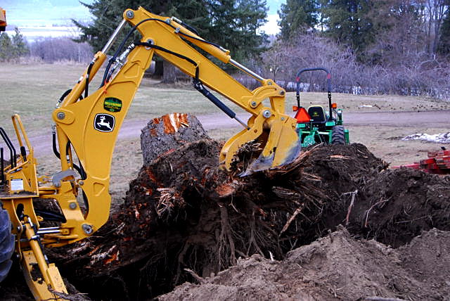

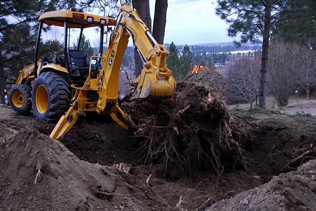

Success!!!
I did not need to use the pressure washer nor a winch. Just kept digging at it. But, it was heavy. I had to drag it out of the hole with the BH. Only then, was I able to maneuver the forks close enough to do any sort of lifting. That is as high as it would lift. That was fine because I did not want it any higher. It tried to tip me over from there when I turned it around on the slight slope of the driveway....
