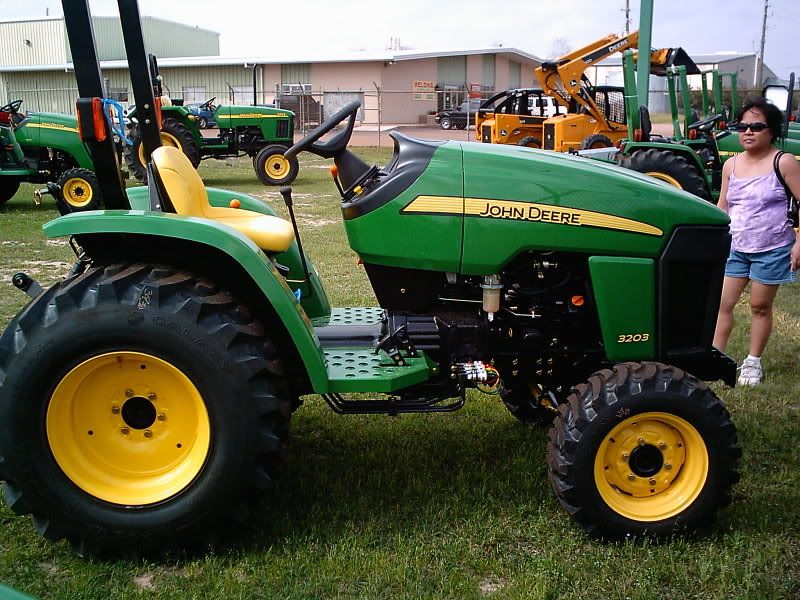

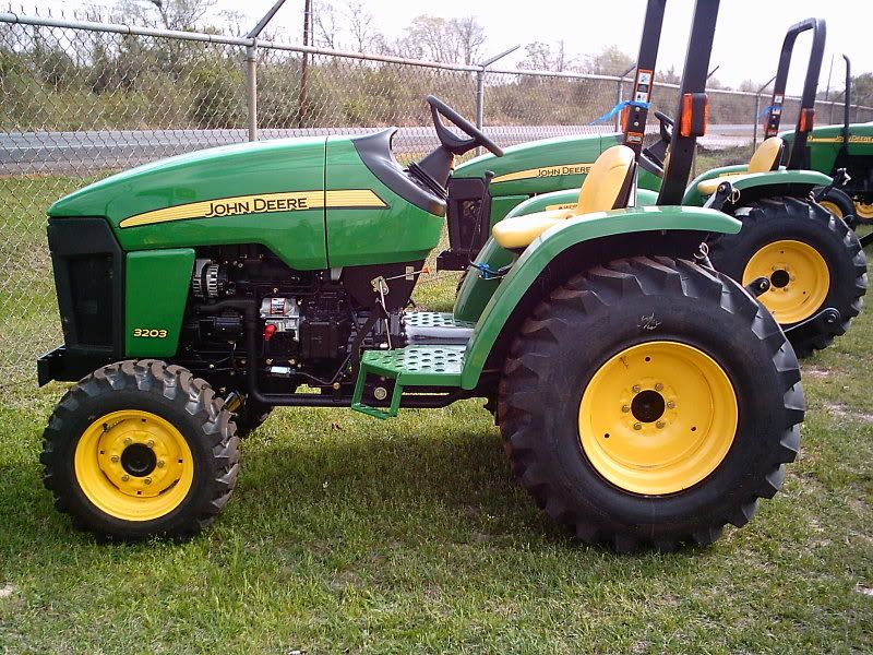

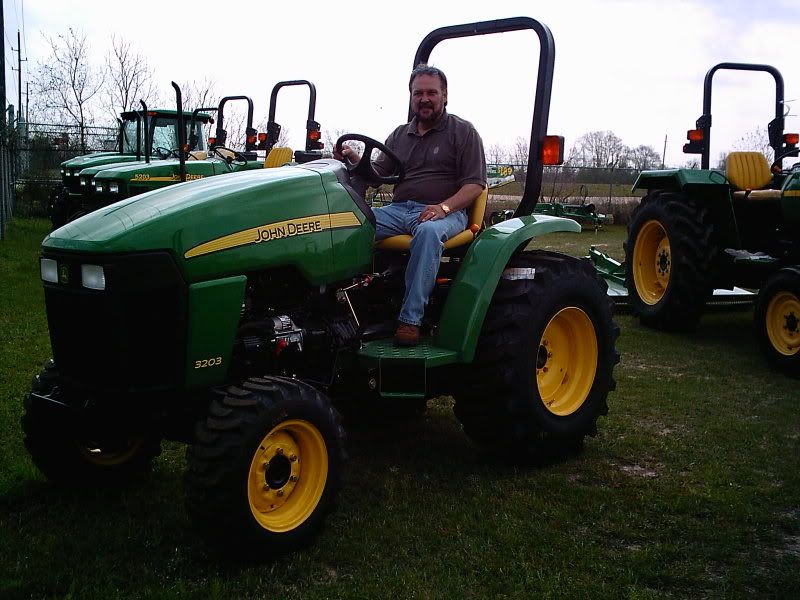

</font><font color="blue" class="small">( I took some pictures yesterday, (Saturday, 3/11/06), and I'd swear we both took a picture of the same tractor at the same Deere dealer (Katy TX). )</font>
Yup. Next time I'll give you a key for some moving shots. /forums/images/graemlins/laugh.gif
