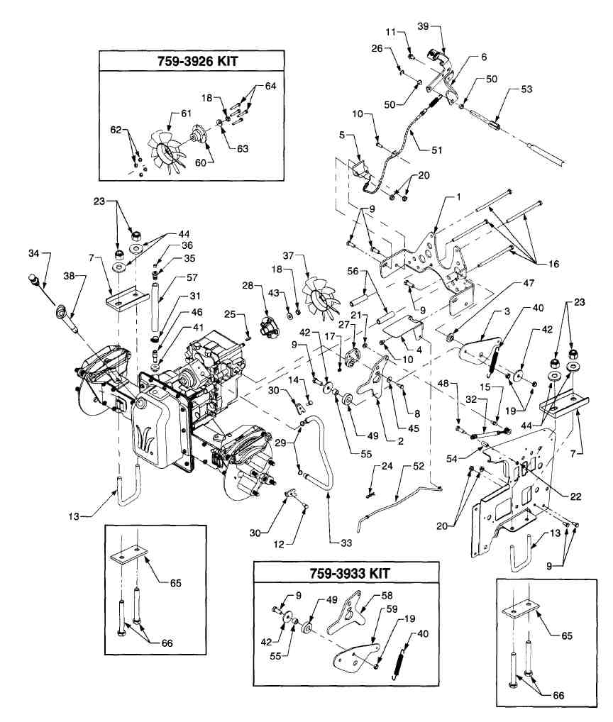

Well, I figured out where the broken spring came from - it was between the front control rod shaft and the cam clutch (PN 732-3118 and rf no. 34 in the parts diagram). So now I think its failure may be unrelated to the hydraulic problem, but occurred when I pushed the forward and reverse pedals to test the hydrostatic drive. I'll get a replacement and then go through the air-bleed procedure I saw in another post on this forum. This was by cycling the F an R pedals with the tractor started and the free wheel mode lever pulled out.

You might try part 60 in the attached picture. (assuming kit 759-3926 is installed) If you noticed there is no key (part 25) in the kit. The pump adapter is held on with friction and lock-tite. If it loosens up, the hydro input shaft does not turn and no hydro action at all. If you don't have the 759-3926 kit and have parts 25 and 28 installed, the shaft must be turning, so, you are looking at more serious problems.
Definitely try the filter and add proper compatible fluid. Drive system plus or compatible (search the forums for a lively:D discussion on compatible fluids).
:mad: DO NOT USE HYTRAN!!!!! :mad:
Also, make sure that the pump bypass lever is not pulled out at all.
If you still have no forward/reverse, power steering or lift then the hydro is not pumping for $ome rea$on. (That's not a typo. It starts to get expensive at this point.:eek: )

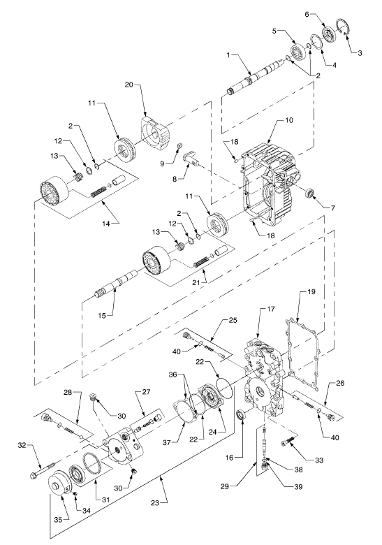

On a similar front, in the attached figure,
can the check, relief valves and/or plugs (#25-30) be used to figure out if there's anything going on inside the pump? I know it sounds dumb, but could someone undo one of these, disconnect the spark plugs and turn over the engine, then look and see if there's a puddle. I don't know what the fluid path is like, but is there a point that, if fluid doesn't come gushing out when the driveshaft is turned, it means that the pump is dead? If I know which way fluid flowed around the filter I might even think you could make a similar check there.
Yes, it's crazy - would it work?
/ 3225 Hydraulics Problem #11
thunderbirl said:
On a similar front, in the attached figure, can the check, relief valves and/or plugs (#25-30) be used to figure out if there's anything going on inside the pump? I know it sounds dumb, but could someone undo one of these, disconnect the spark plugs and turn over the engine, then look and see if there's a puddle. I don't know what the fluid path is like, but is there a point that, if fluid doesn't come gushing out when the driveshaft is turned, it means that the pump is dead? If I know which way fluid flowed around the filter I might even think you could make a similar check there.

Your charge pump is broken. It is number 24 on the parts diagram. Replacing this unit requires a complete teardown of the hydro unit which can be removed from the differential, but the entire assy. should be removed from the tractor first. I bought my tractor with this unit broken and repaired the whole thing for $108 for parts(inc. filter) plus $30 for 6 quarts of oil(Mobil1 15w50). I heard rumblings that if you approach CC directly, there may be an unspoken extended warranty for this item- DO NOT ask the dealer- he will say NO(would you work for less than half the money given a choice?). This IS the problem with your tractor the longer you run it trying different fixes, the more havoc you wreak inside the hydro unit!!! fix it now before you run it any more.

The pump is cerainly a key suspect. The item #24 in the drawing posted by thuderbirl (post #10) is called the gerotor & housing assembly. It is part of a larger assembly kit #23 called the auxilliary charge pump kit. I got a price of $75 from Messicks Farm Equipment for part #24, and $193 for the assembly kit #23. Apparently, efiero50 got just the gerotor part and reused the O-rings, etc.
I also talked a bit to a service guy at Messicks, and he shared the opinion that the charge pump was a key suspect. The two pumps inside the transmission itself are used for drive function only, so my lack of lift and steering makes the charge pump the more likely culprit.
