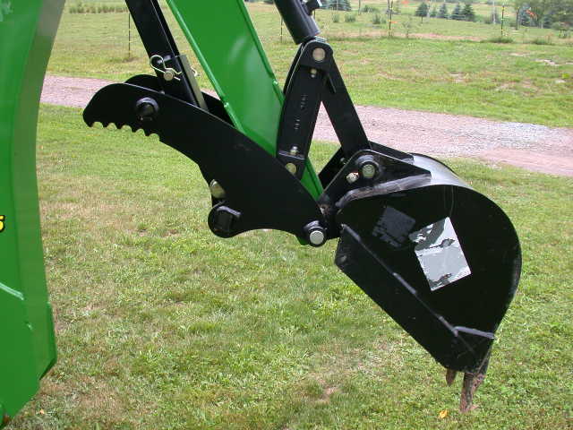

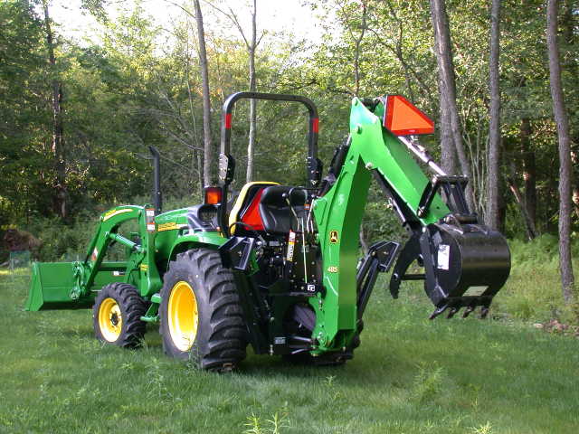

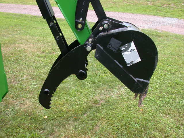

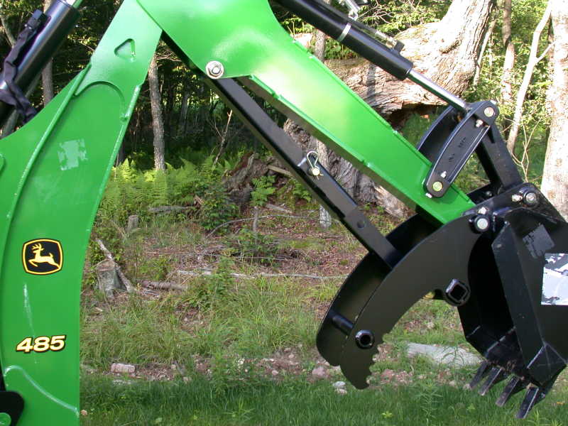

I have the thumb, when I bought it the guys on TBN advised I get the thumb too, it was pricey but JD doesn't give stuff away!
What I like about the thumb is that in the fully retracted position it doesn't impede the bucket but when you work were you're lifting rocks or debris is keeps the boom arm from getting beat up. On my 46 hoe I was always wedging rocks and things between the boom and the bucket to lift them, the boom got pretty beat up.
When you see it off the tractor it looks really big but once it's on it looks just about right. When it came in I was at my dealer's and we both though that was too big for the tractor but it's not, it works really well and I go through our Catskill hardpan with relative ease. I can't imagine there's a job I can't do. This year I'm digging holes for more solar panel mounts, a root cellar and mounts for my windmills.
Thumb min and thumb max.
