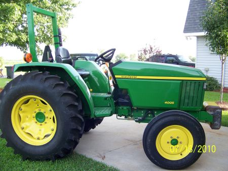

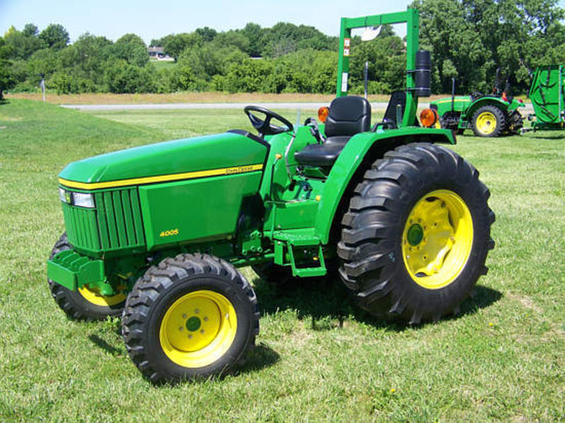

Though I have yet to drive one, I believe that the tranny is a collar shift with the gear stick in the center line of the tractor.
Here are two pics for both 4wd and 2wd.

No...a collarshift is a type of gear transmission. The lever location isn't really relevent (although the collarshift transmission levers I've seen were located as you wrote).
I must admit, it is a bit confusing though...
   / 3320 vs 4005 Longevity
#20
Was just trying to clarify the difference in the layout from the tractors I have seen with those posted earlier showing a side location for the gear and range control sticks. Not sure that was a 4005.
