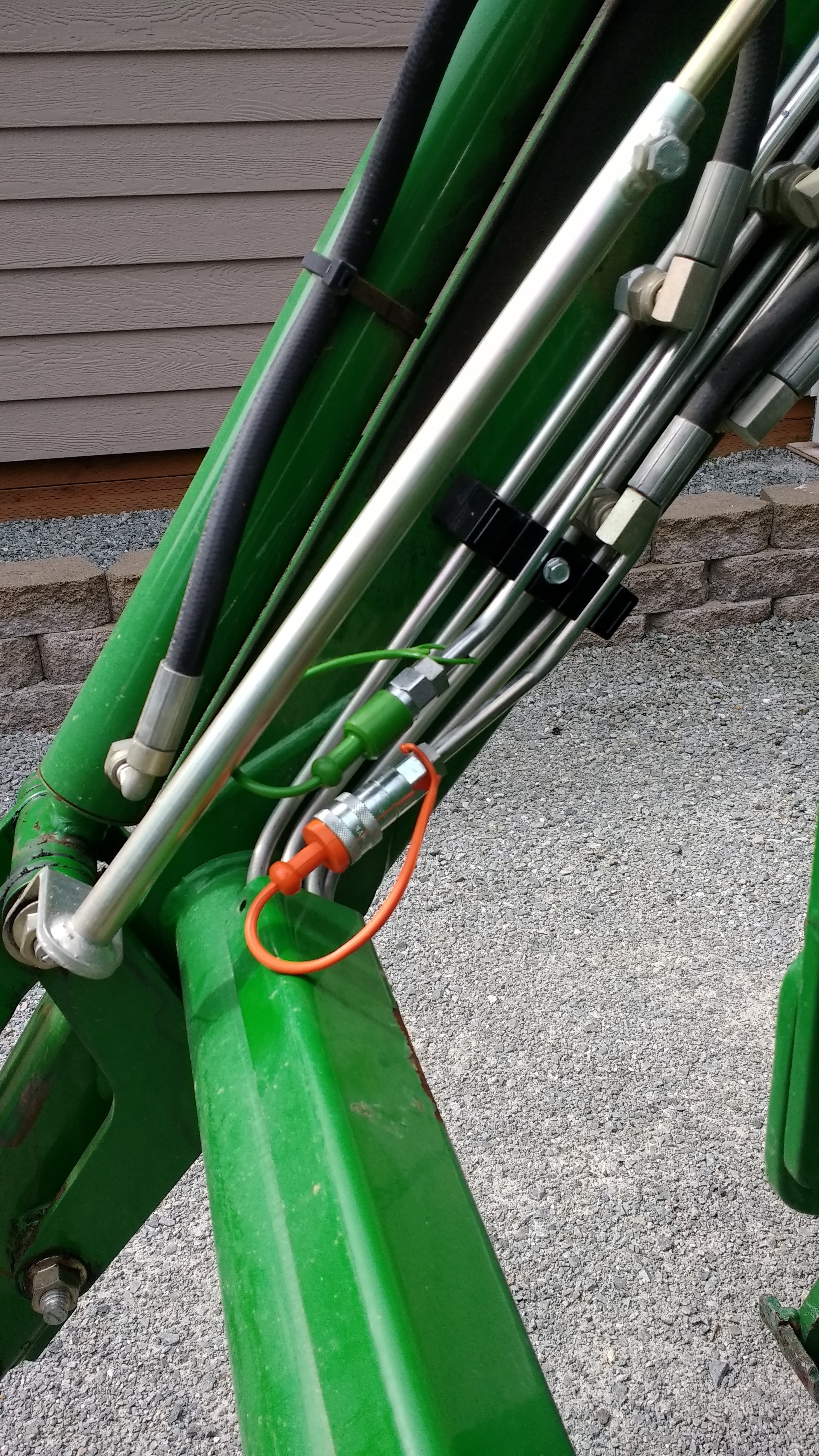

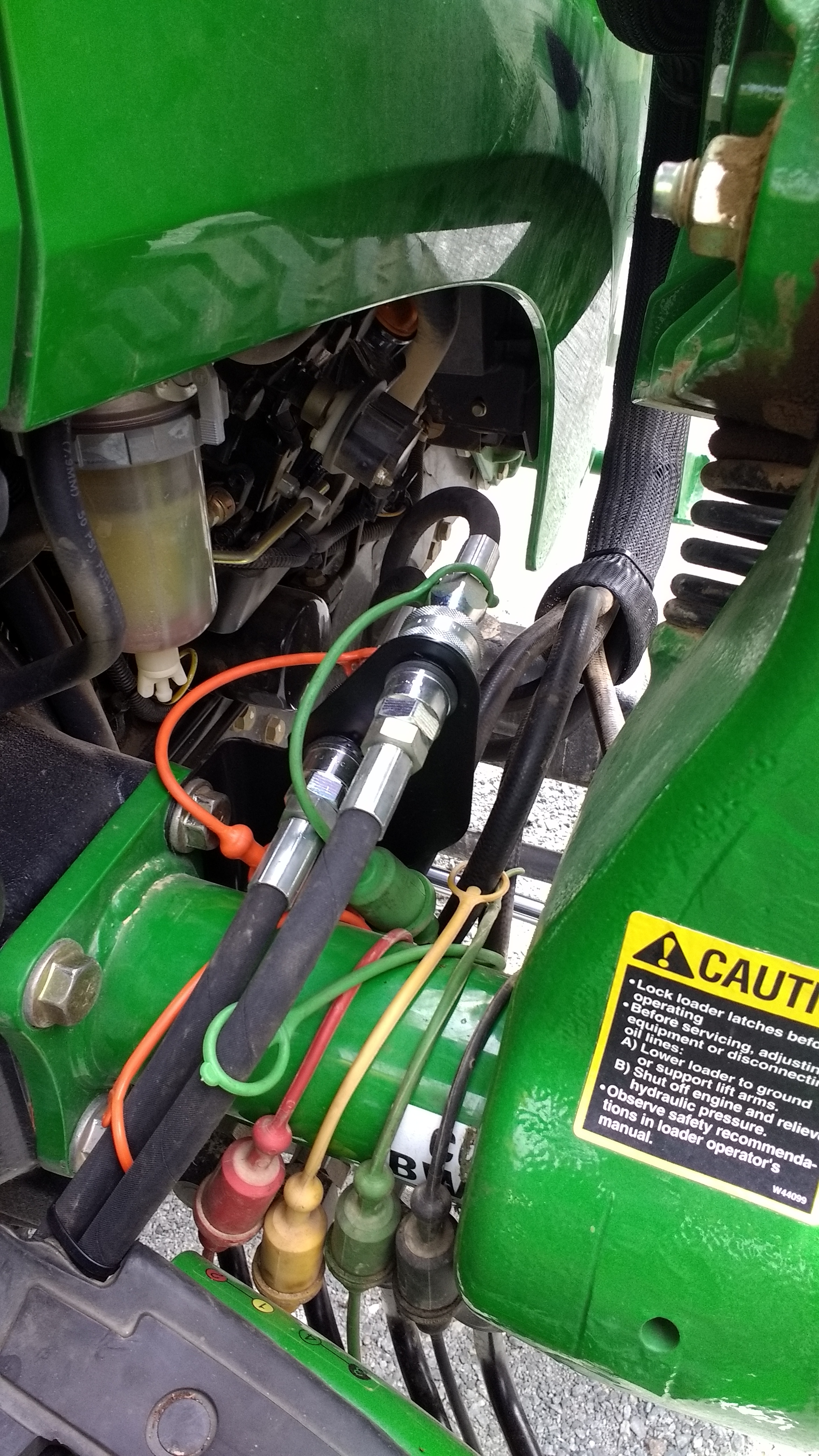

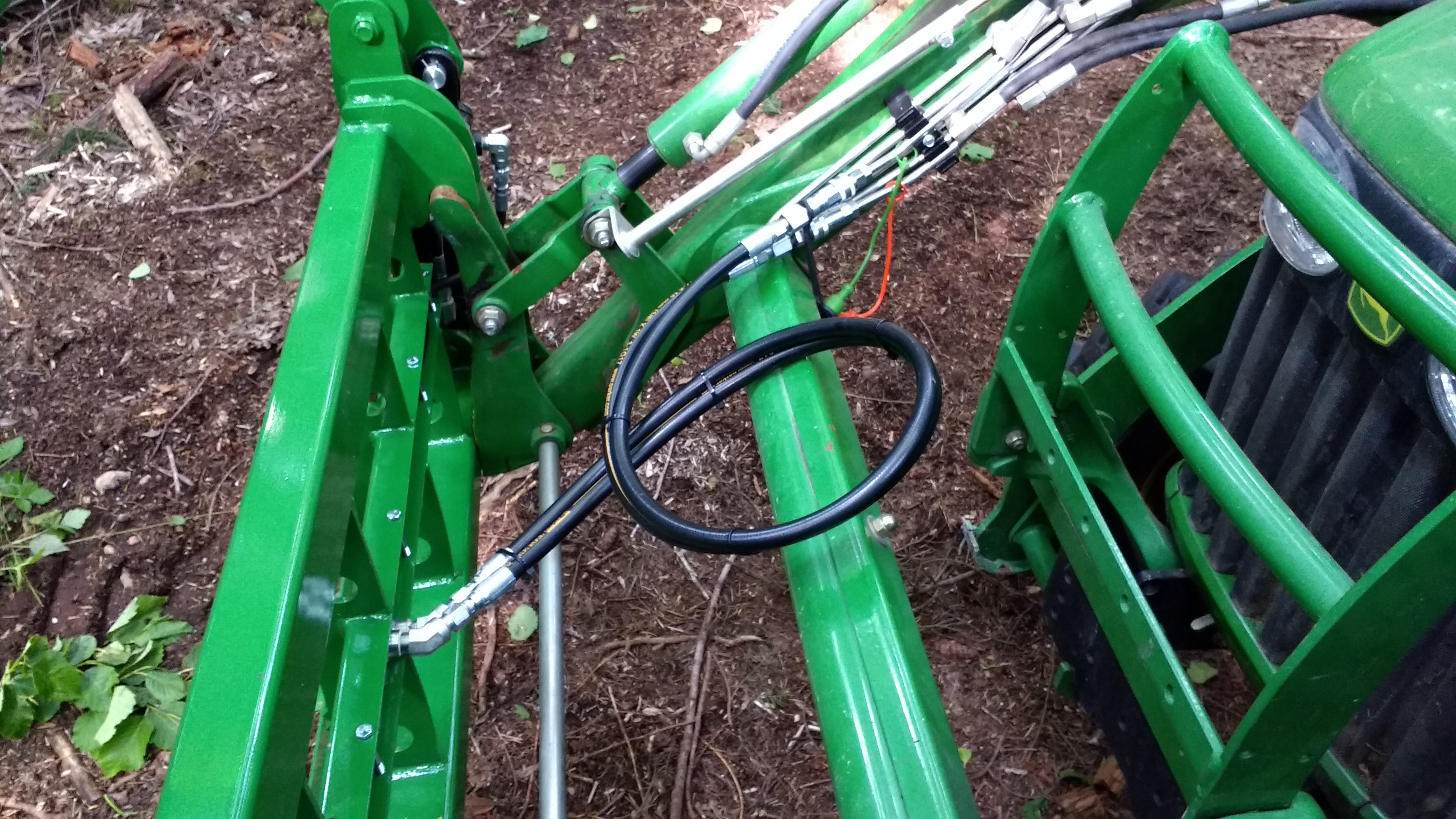

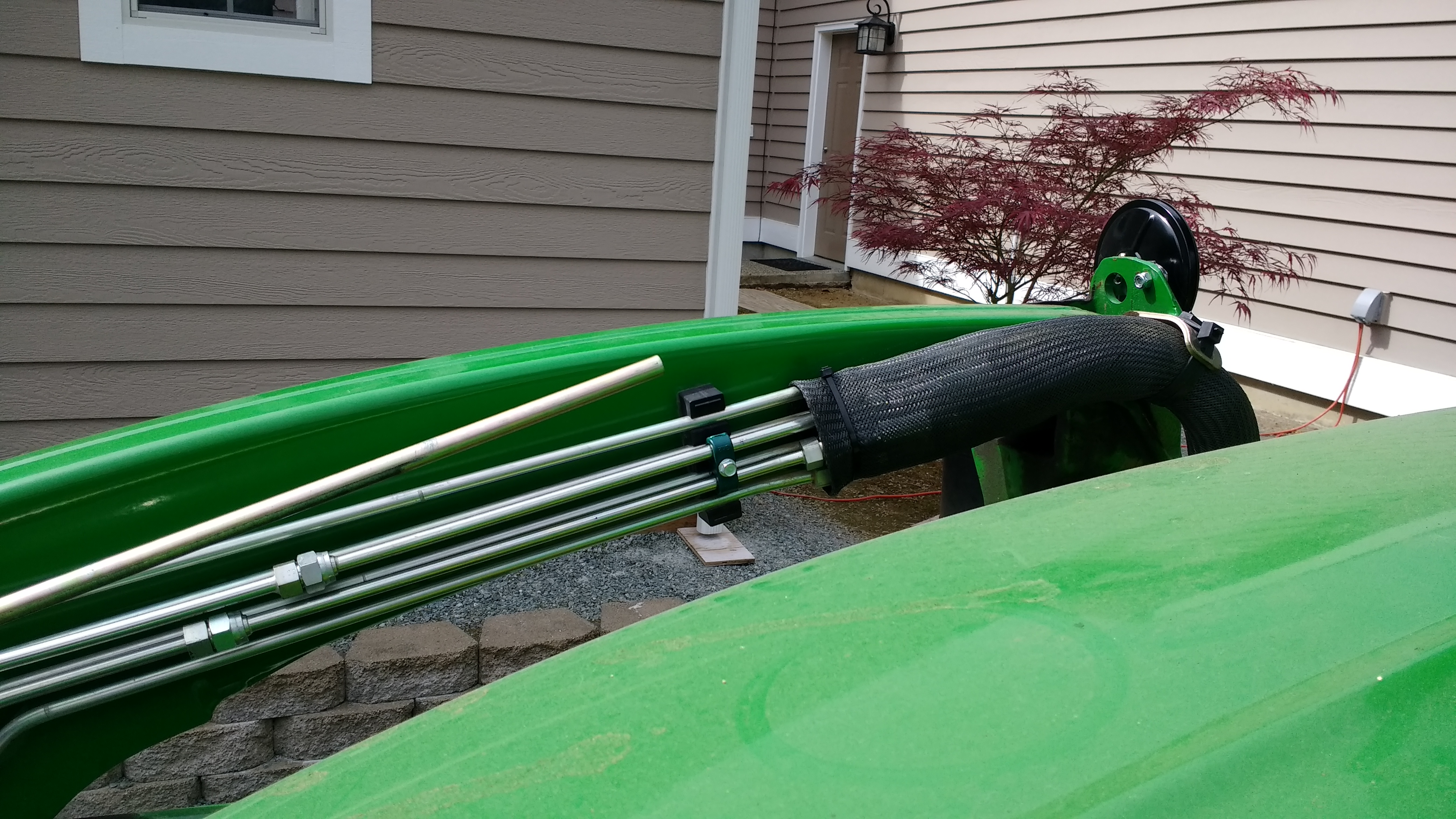

I have a 2008 3320 and once asked about adding the button style third function control and was told its not possible for the pre 2011's. So I added the Deere 3rd function kit with the mechanical lever and haven't found it to be a problem as its very close to the joystick. Here's my set up using the Deere oil line kit going from rear 3rd function outlets to the loader.
The 3rd function outlets are the 2 lower right ones with hoses attached, the power beyond is the looped hose outlets to the left and unused port with dust cap to the far left. The other four with colored dust caps are from the electric diverter valve for my top and tilt.
