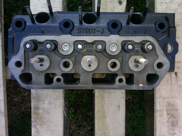

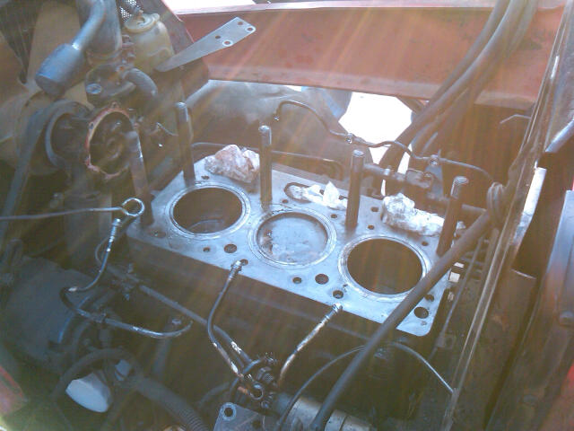

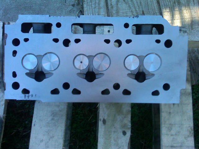

I am really disgusted - Got The new connecting rod, rings and bearings put in this morning. Head installed compression Gage hooked up - 300lbs. then it would not get over 200. hooked up the air line to it - backed off the rockers- air coming through the exhaust port. I pushed on the top of the valve a couple times - no change. I am walking away from it for a while.

Here's a good Guess #2 cyl. If I remember you sent that head out. Not your Fault. S_ Happens. But again back to replaceing the Rings. You would have known the Rod and would have known of the potential problem. Bent valve Crack in the head etc. If it was one of the grumpy Old men I worked with I would have to take a good look behind me to see how much I had left if that left the shop.Lol. IMO they need to correct the prob.and a new H.gasket. Remember the Squeaky Wheel gets the Oil. :mad:
/ 336D injectors #87
I would crank it up and see what you have after it has run for 5-10 min. You could have some carbon under a valve, etc. I think you are almost to be completed with this job.
/ 336D injectors #88
Carbon build up on brand new valves and a freshly clean vatted head. NO!!!
/ 336D injectors #90
Your Joken Right? Dirt dust or rust in or on a new Clean Head and cylinder. And big enough to prevent a valve from seating? Come on:confused2:

Being i was so close to getting it running I decided to go ahead and start it up. Ran good, middle cylinder firing and running smooth. After about 30 mins running it developed a knock in low RPM . I tried taking a video bu having trouble getting put on the site. the knock goes away with increased rpm. Seems to have a lot of pressure in the radiator but the pump is working and water is circulating, I did install a thermostat- it did not have one.
