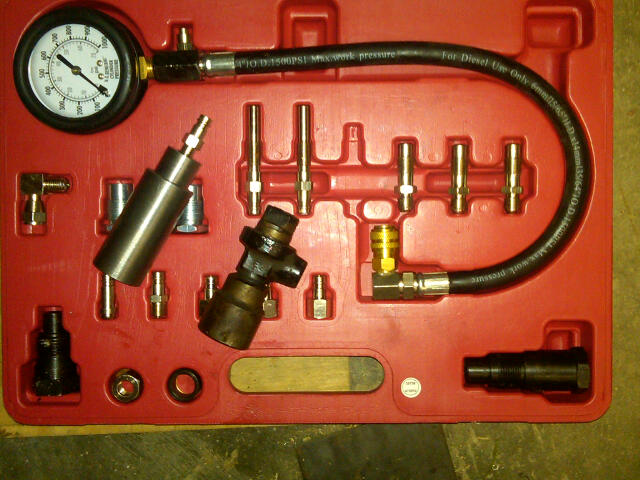

Tried to check compression but my Gage from Harbor freight will not hold pressure, that's what get for going cheap. Got every thing but the exhaust and the intake back together before the rain started. Could snow tonight, can't complain, its been a mild winter.
/ 336D injectors
#53
Finished butting everything back together and started it. Middle cylinder is still not firing. Have 460 Lbs compression in the front cylinder, 250 in the middle, and 440 in the rear. Hooking up air to the middle it is very hard to hear where it is escaping, if i bump the cylinder it changes the sound of air. If I put the valve cover on it muffles the sound which leaves me to believe it is the cylinder sleeve.
Thought on how to proceed?

Reworked head, valves properly adjusted. Sounds like ring blow by. All your liners even at top of block?

I don't see how the sleeves could be passing air pressure in a manner that the valve cover could muffle the sound unless the head were cracked. I think it is more likely your valves are not properly adjusted or installed: if pressure is coming out the valve cover, the only way that could occur is if there is an unintended opening from the top of the head into the cylinder. It seems more likely that your valves aren't correct than there is a substantial head crack under the valve cover.
/ 336D injectors #57
Put some ATF or Trans fluid in the Cyl. and pump it up. It's Red and can easily be seen leaking out at the leak. Don't see it coming out of the Valves or the Valve Guide Seal your going to have to pull off the oil pan and look for the ATF leaking out through the Rings on the Piston and or leaking Down the Cyl. Wall. Again thats why I use Red ATF if you don't see it be ready to get "P,O" your be pulling the Head off again. Been there Done it :mad:

I beleive the air I am hearing is coming from the openings for the push rods, when I put the valve cover on it muffles it.
The Red atv sound like good advice, I will try that ASAP/
