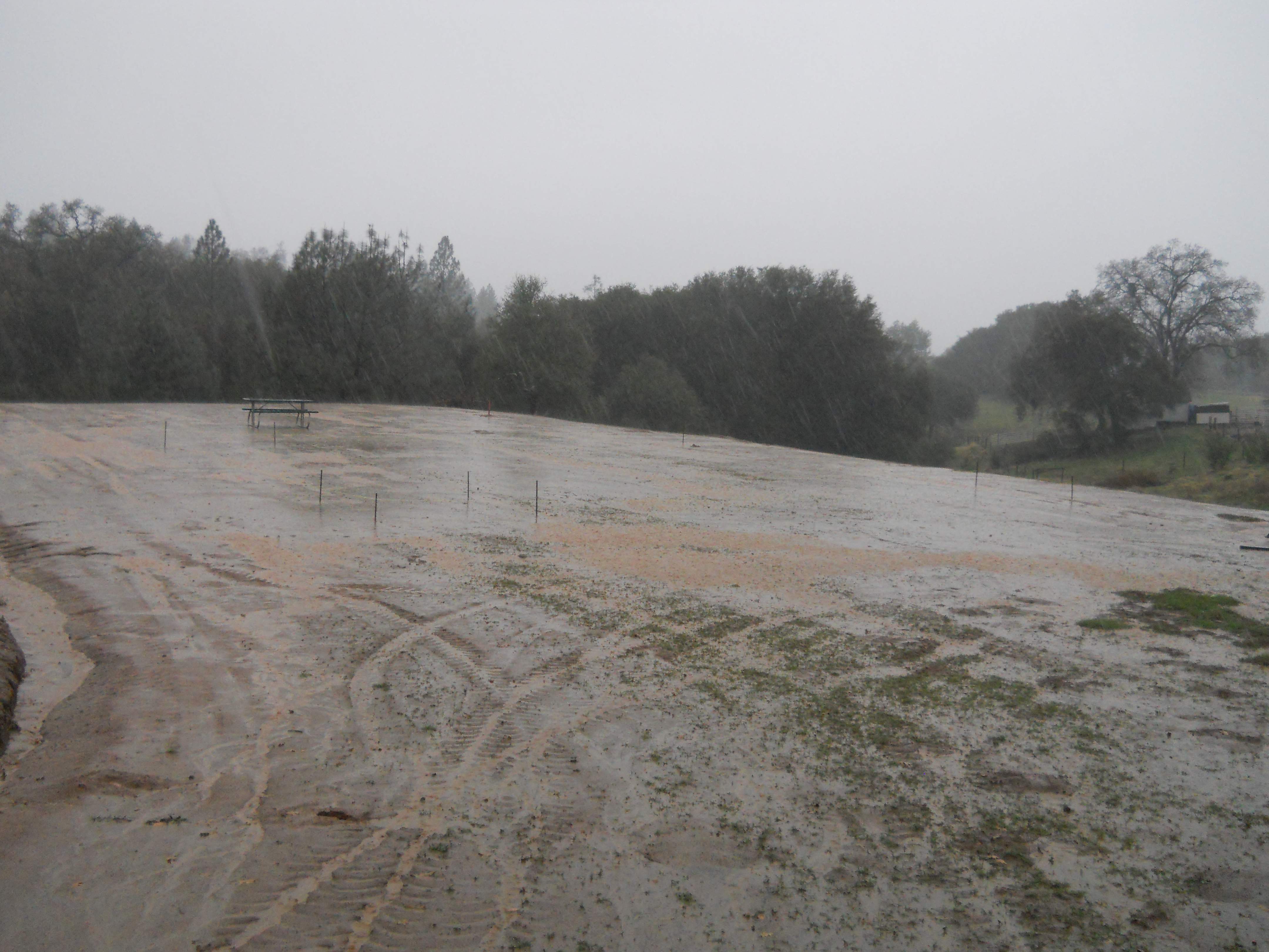

After waiting for the barn material to arrive, we layed out the footprint. The lumber
package arrived right before the rain. We are hoping to catch a break in the weather
mid week.
Steve

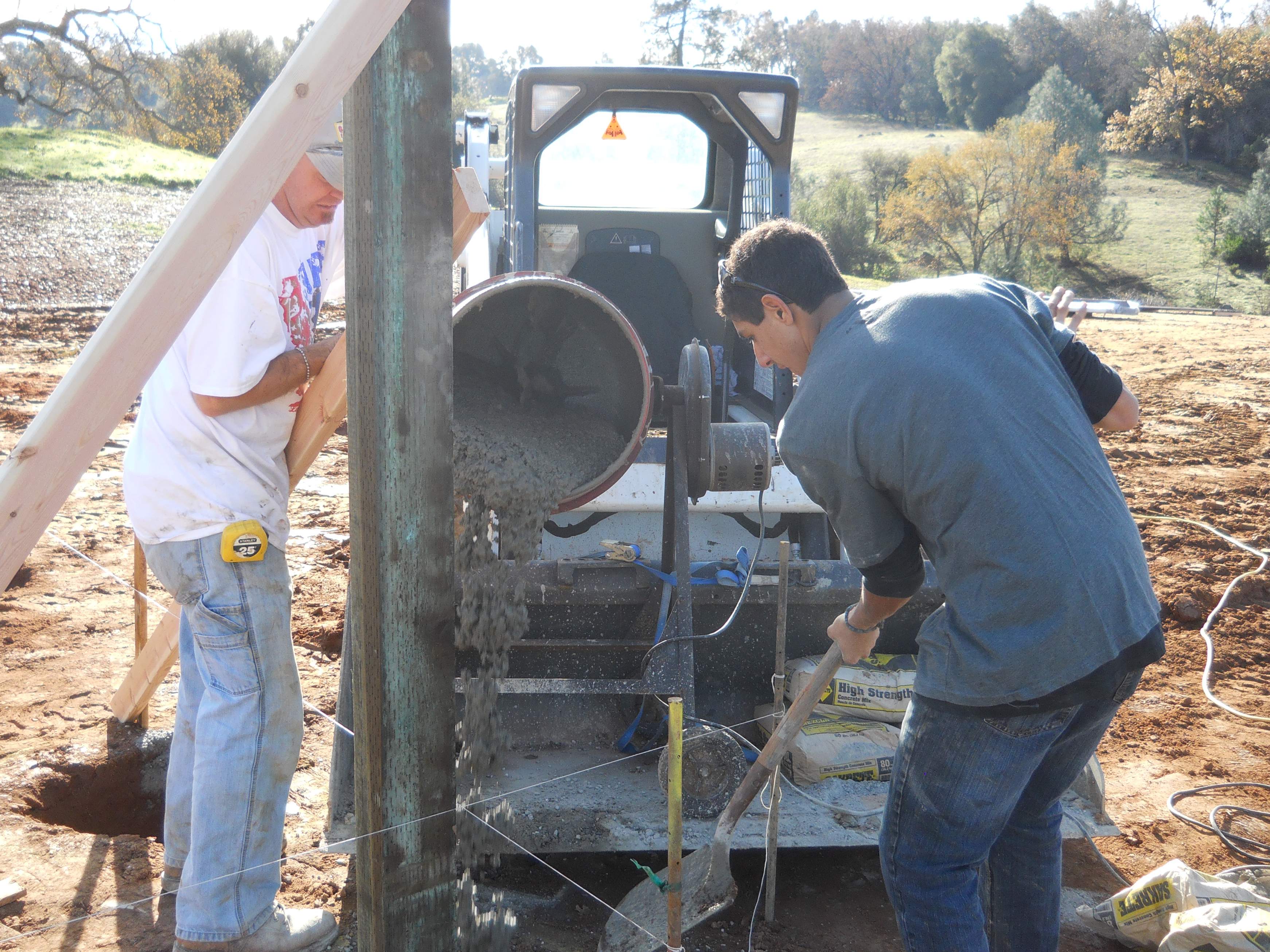

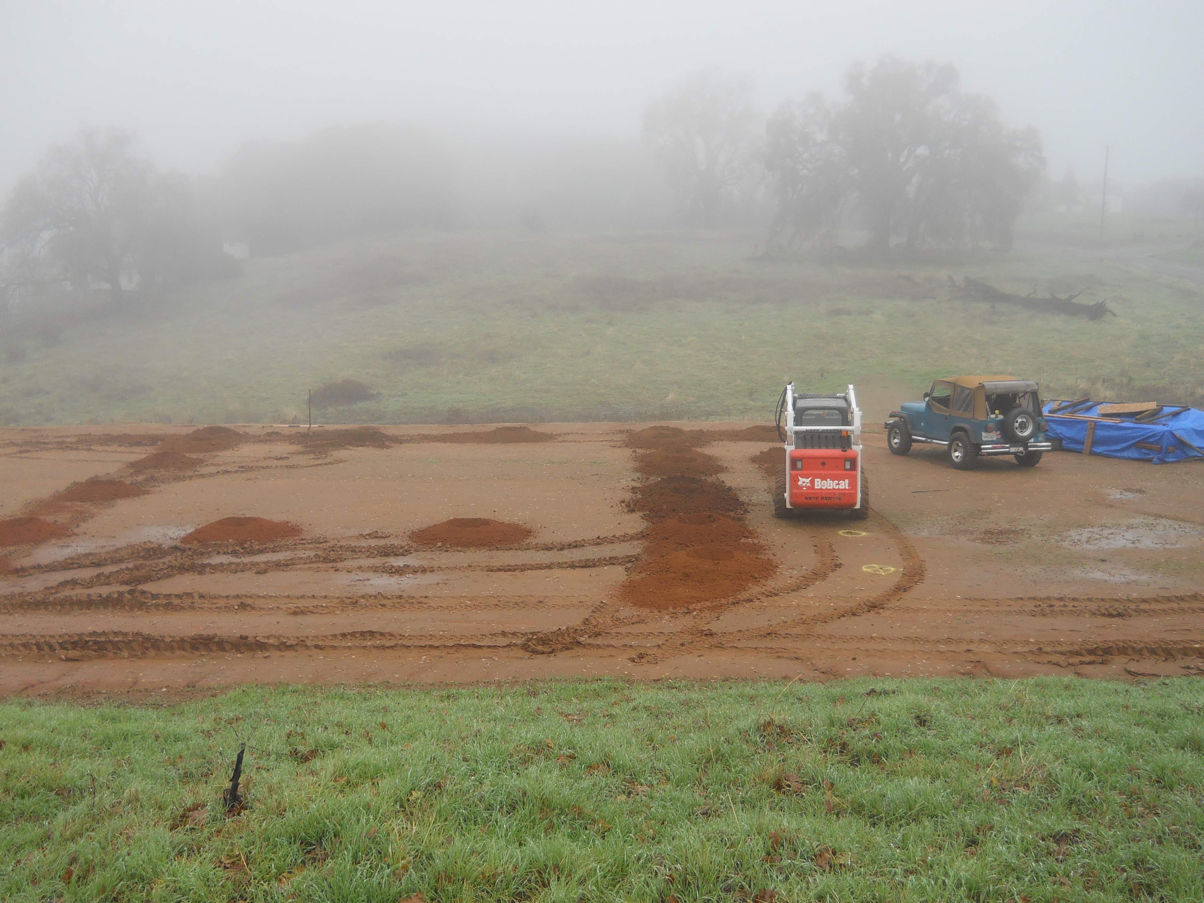

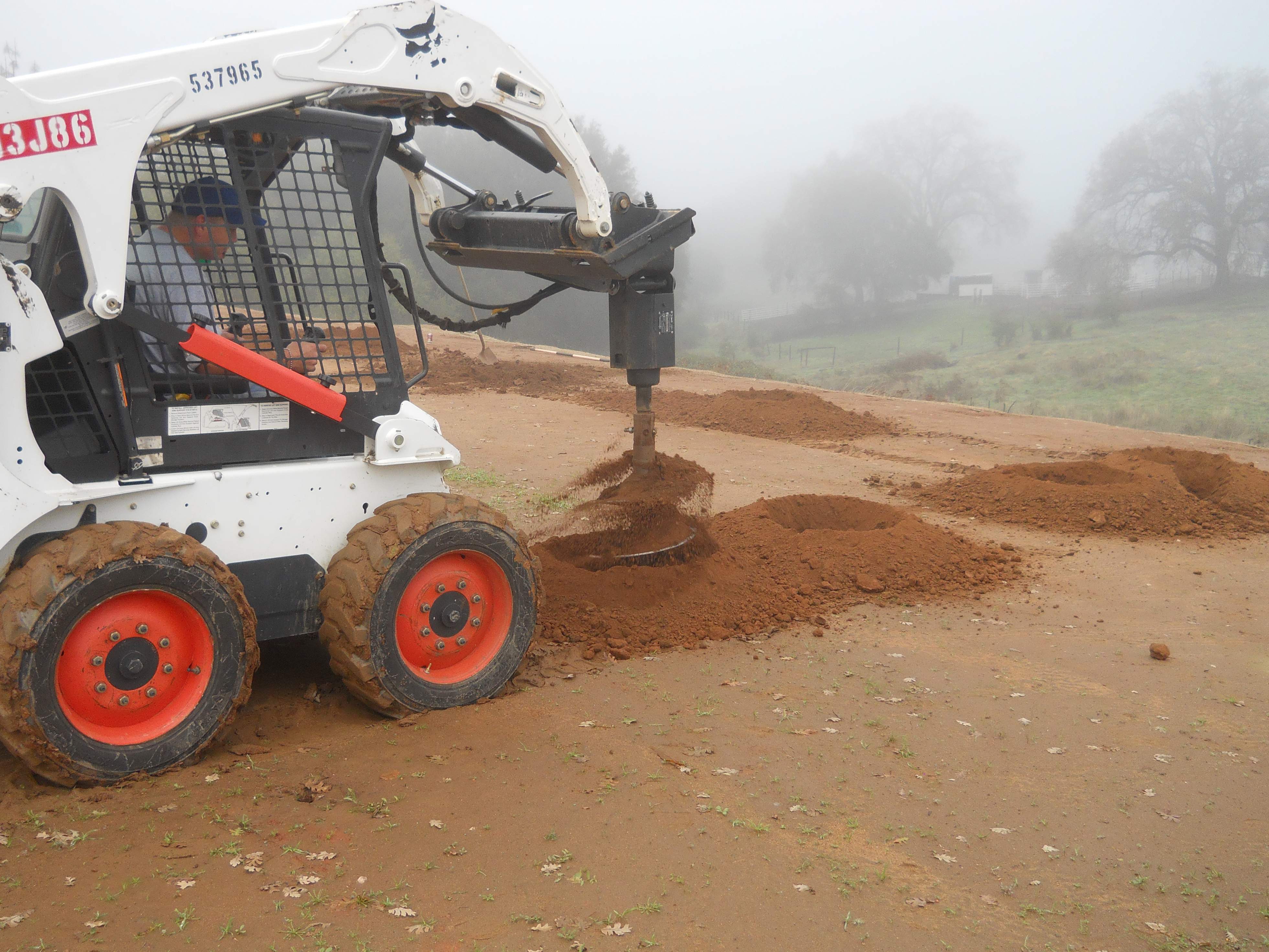

After a week of rain we were blessed with fog. Holes are dug and Saturday we
set poles.

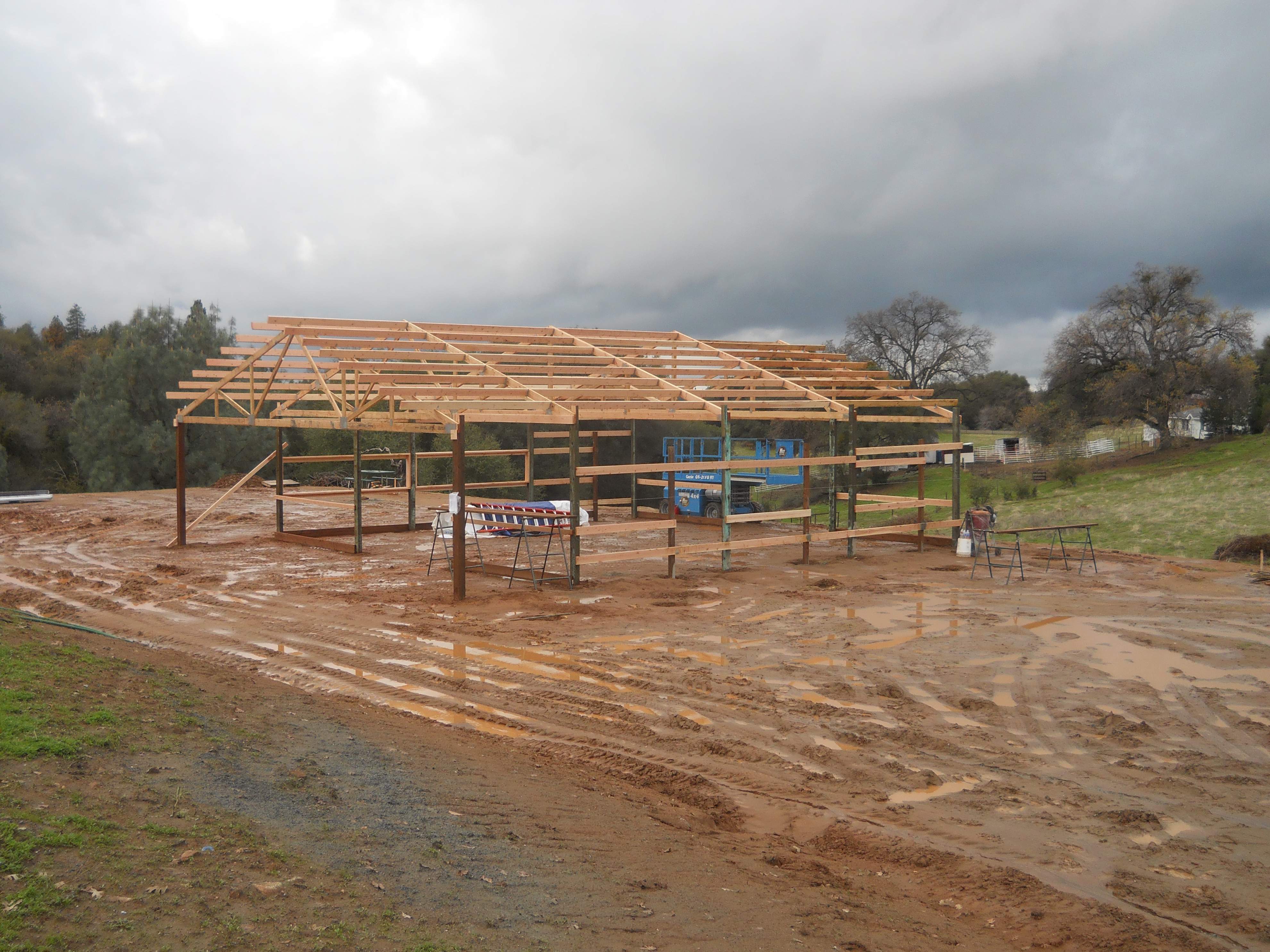

#14

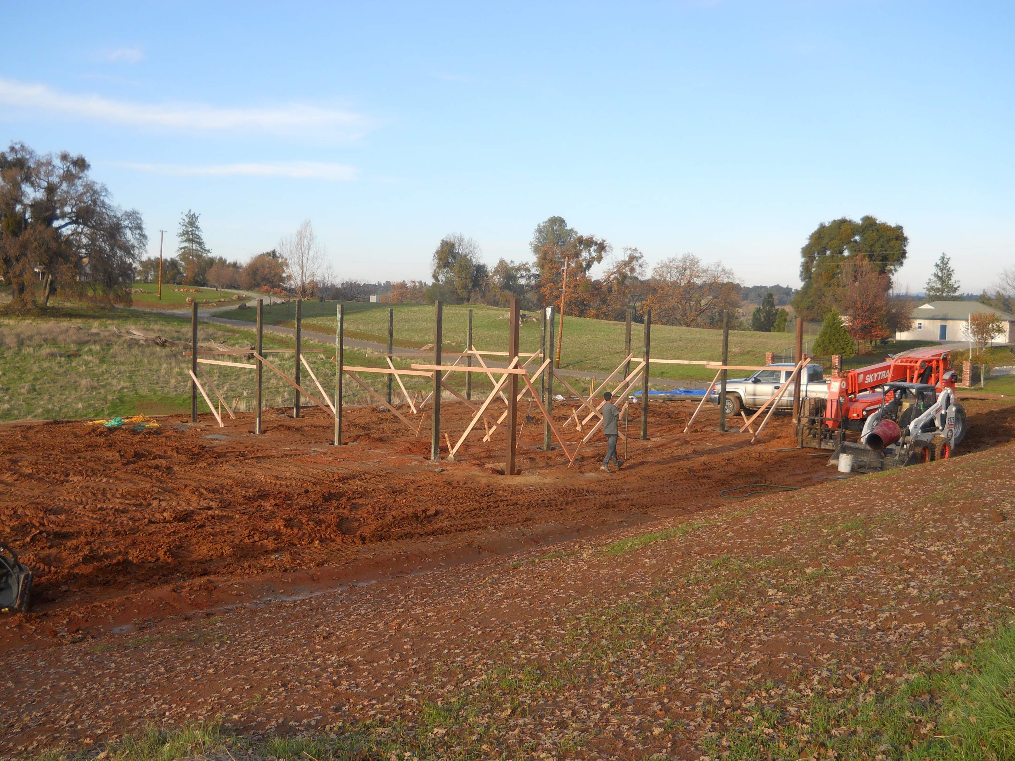

Bearing poles set, ready to be notched and trusses.

Thanks Eddie, the reason I needed a 6000# high reach forklift is because we are unloading
semi truck deliveries. The ''kit'' has been farmed out to a steel, lumber, door and truss
vendors. I rented the forklift for our use but have spent 6 hours unloading trucks so far
due to mud and power lines.:thumbdown:

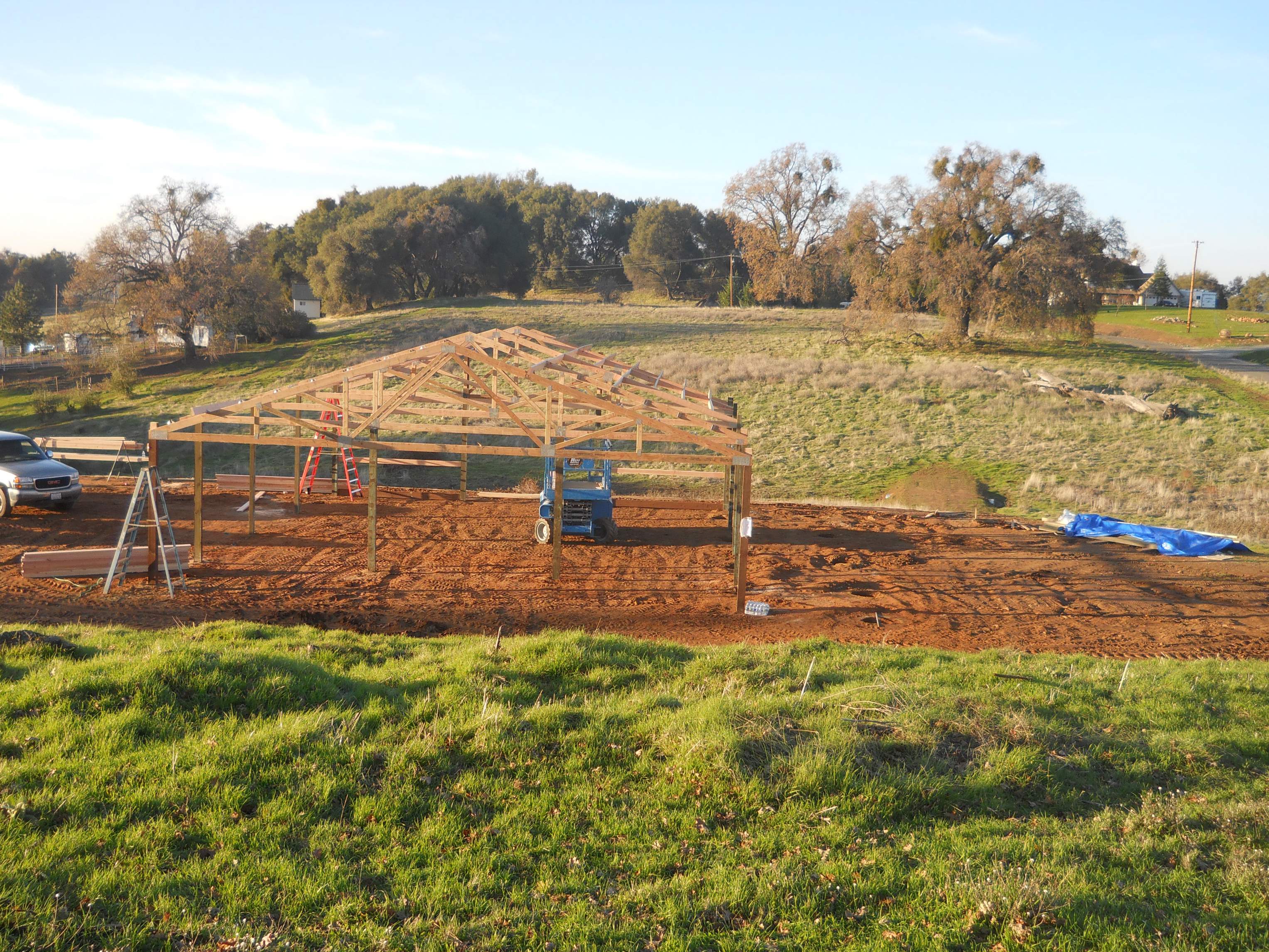

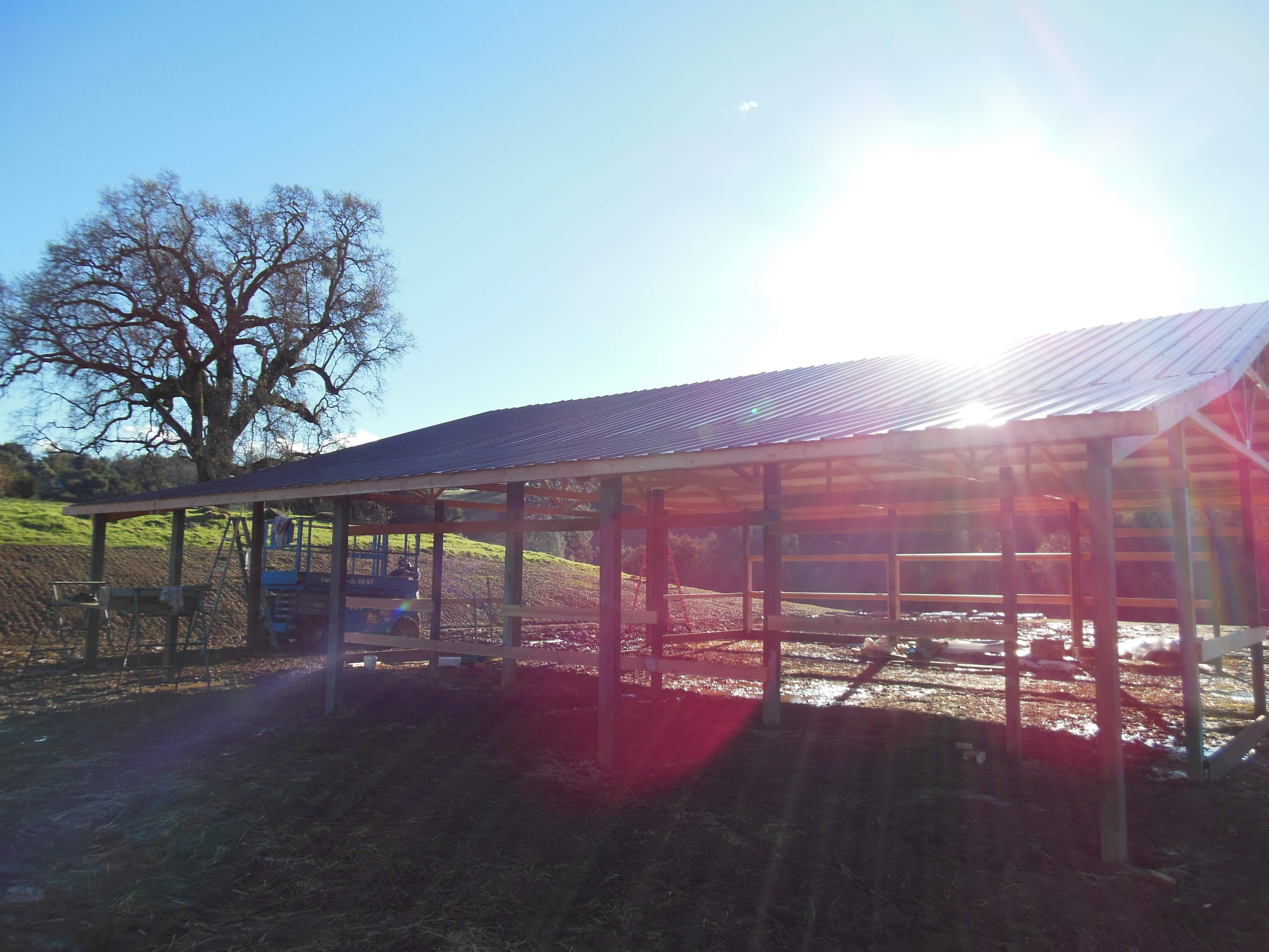

#18

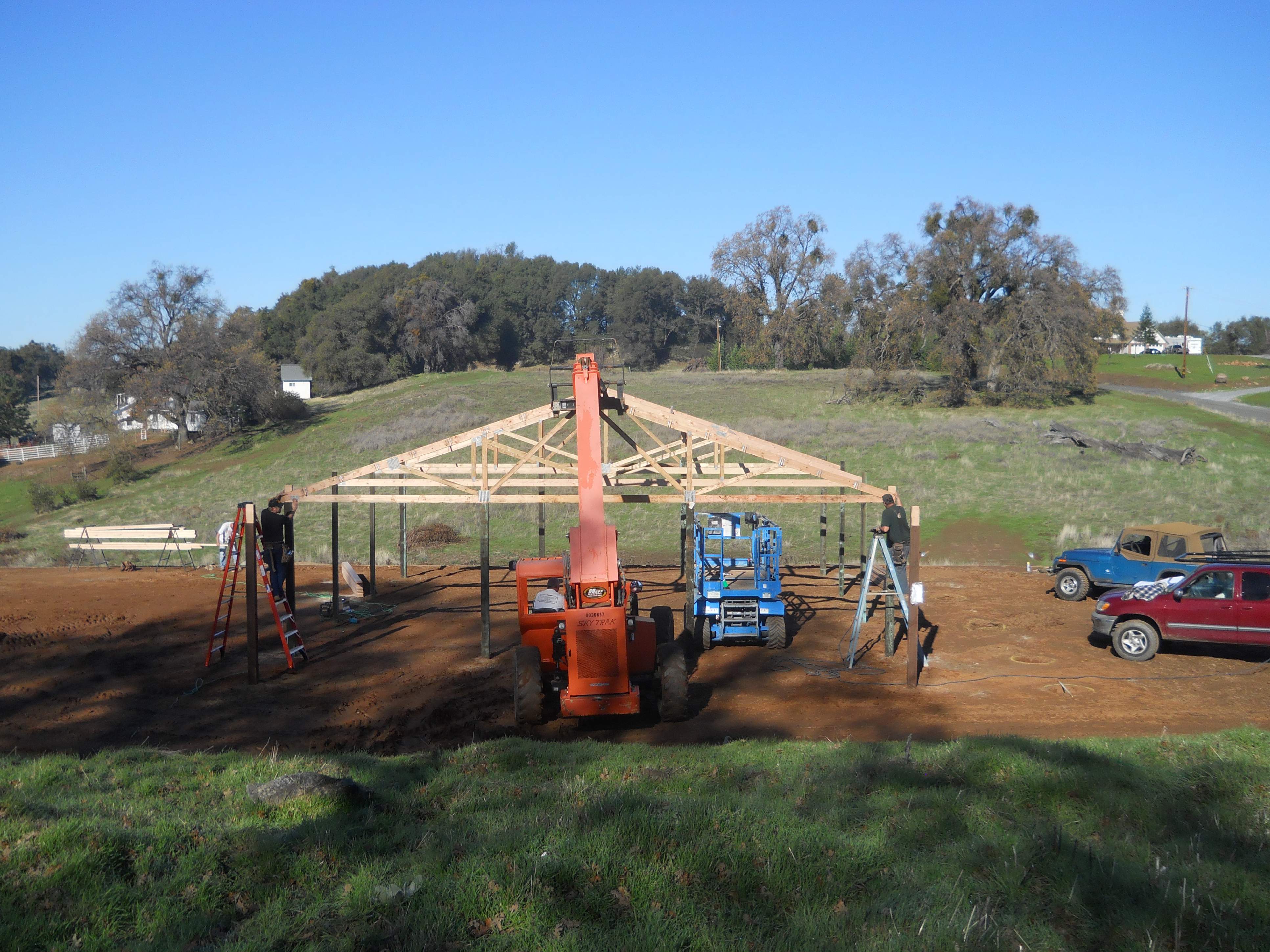

Installing trusses and purlins. You cannot beat December weather in the motherlode.
   / 36' x 36' horse barn #19
Can you believe that one local company that builds pole barns insisted on 16" centers for trusses and had never heard of purlins. I couldn't decide if they were ignorant or just trying to sell more trusses. ???
   / 36' x 36' horse barn #20
"builds pole barns" or "would like to build pole barns"? :laughing:
