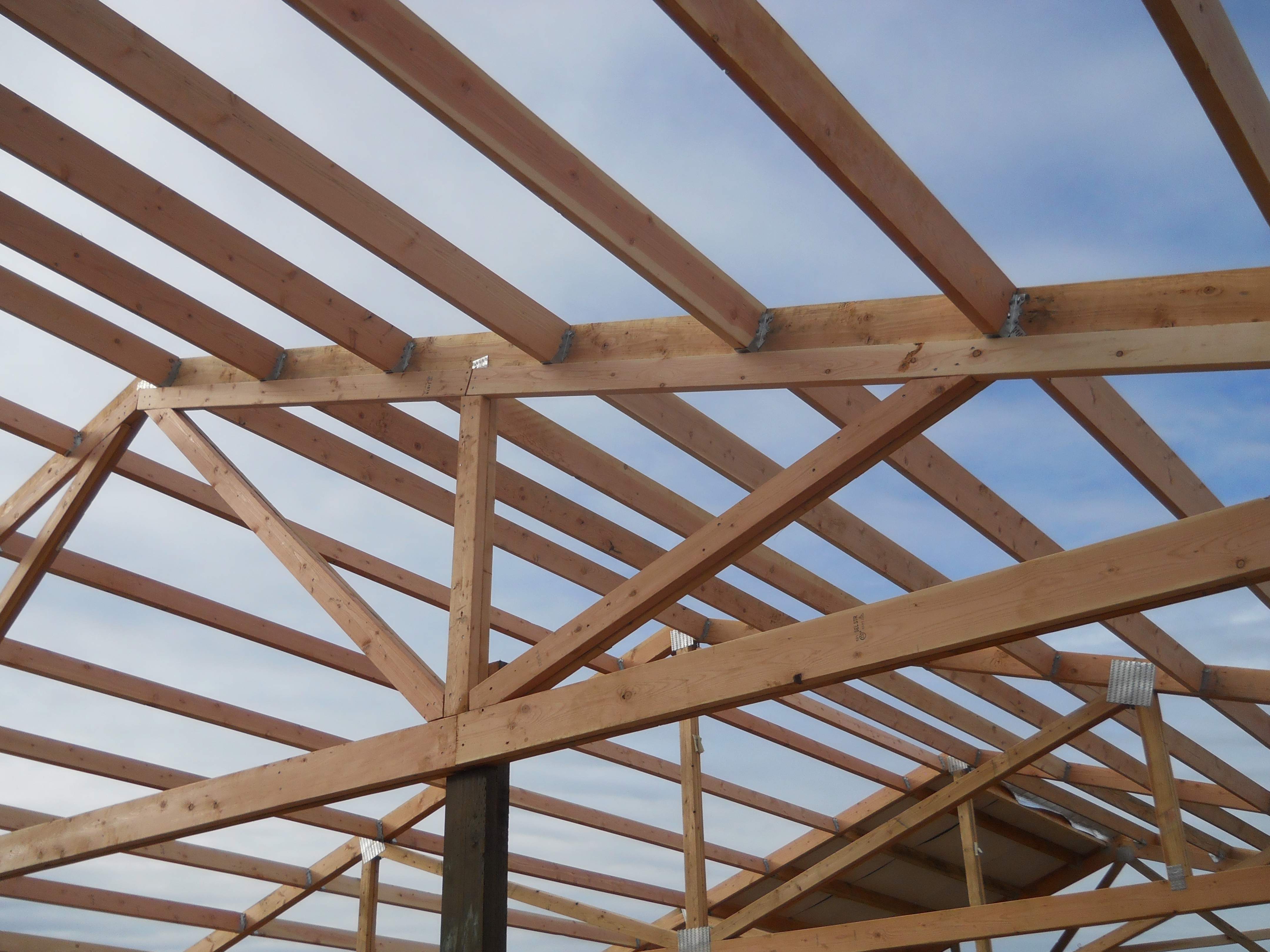

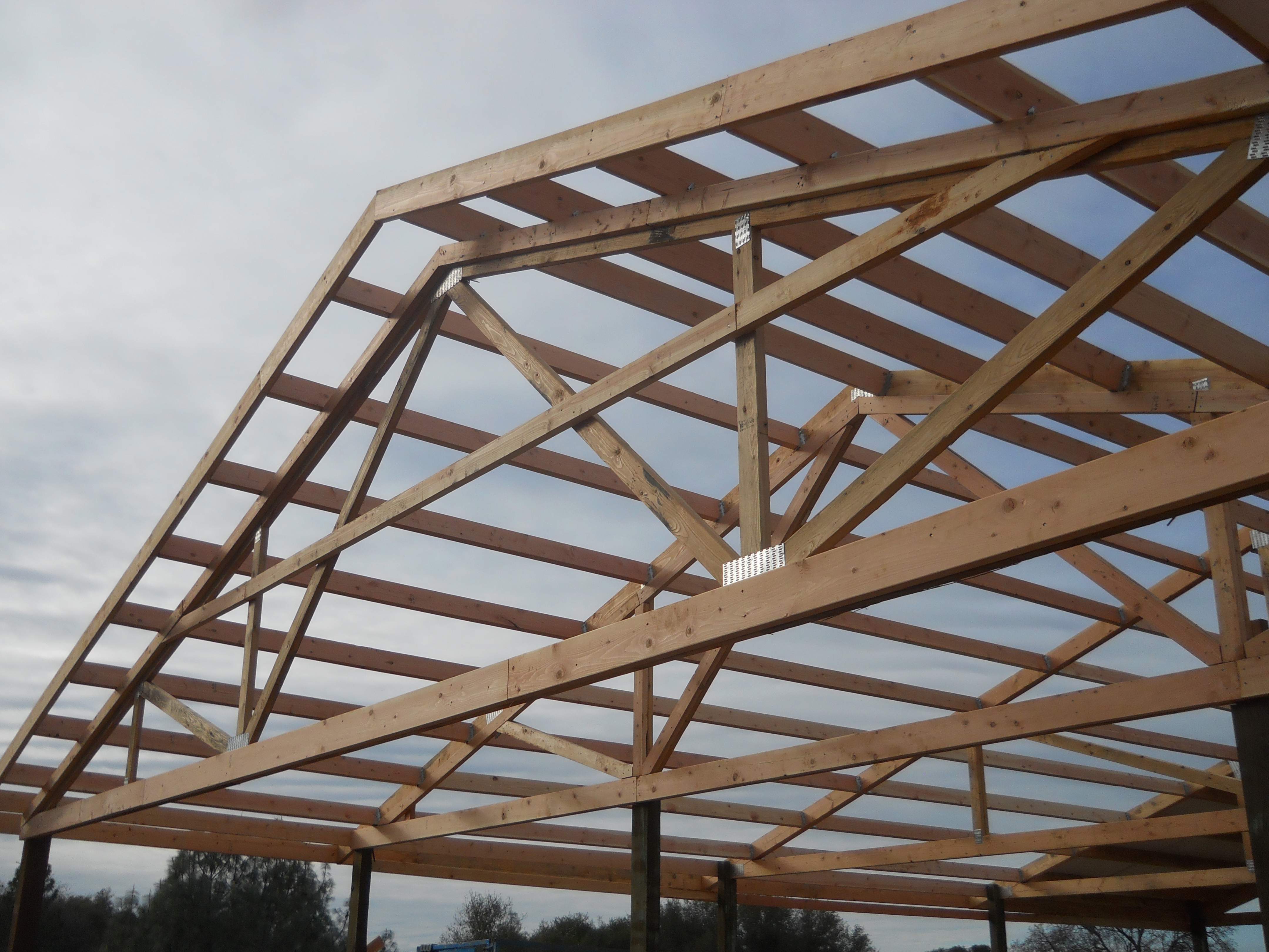

I didn't notice the double trusses either. But when I looked at the picture, I realized that the front porch truss is different in design. That surprised me. With more bracing, it's stronger then the others. I'm curious why. The trusses over the end walls make sense, and the trusses over the span of the building make sense, but I'm lost why they designed the front one like they did.
The double truss is something else I've never seen. My expereince is to put one truss on the post and one in between the posts on a double 2x12 header notched into the top of the post. I recently read in Fine Home Building that bolts are no longer acceptable for live loads on decks and that notching a post is the only way to do it. I've been notching my deck posts for years and really like how you have the load of the truss on top of the posts. Nothing is stronger then that!!!!

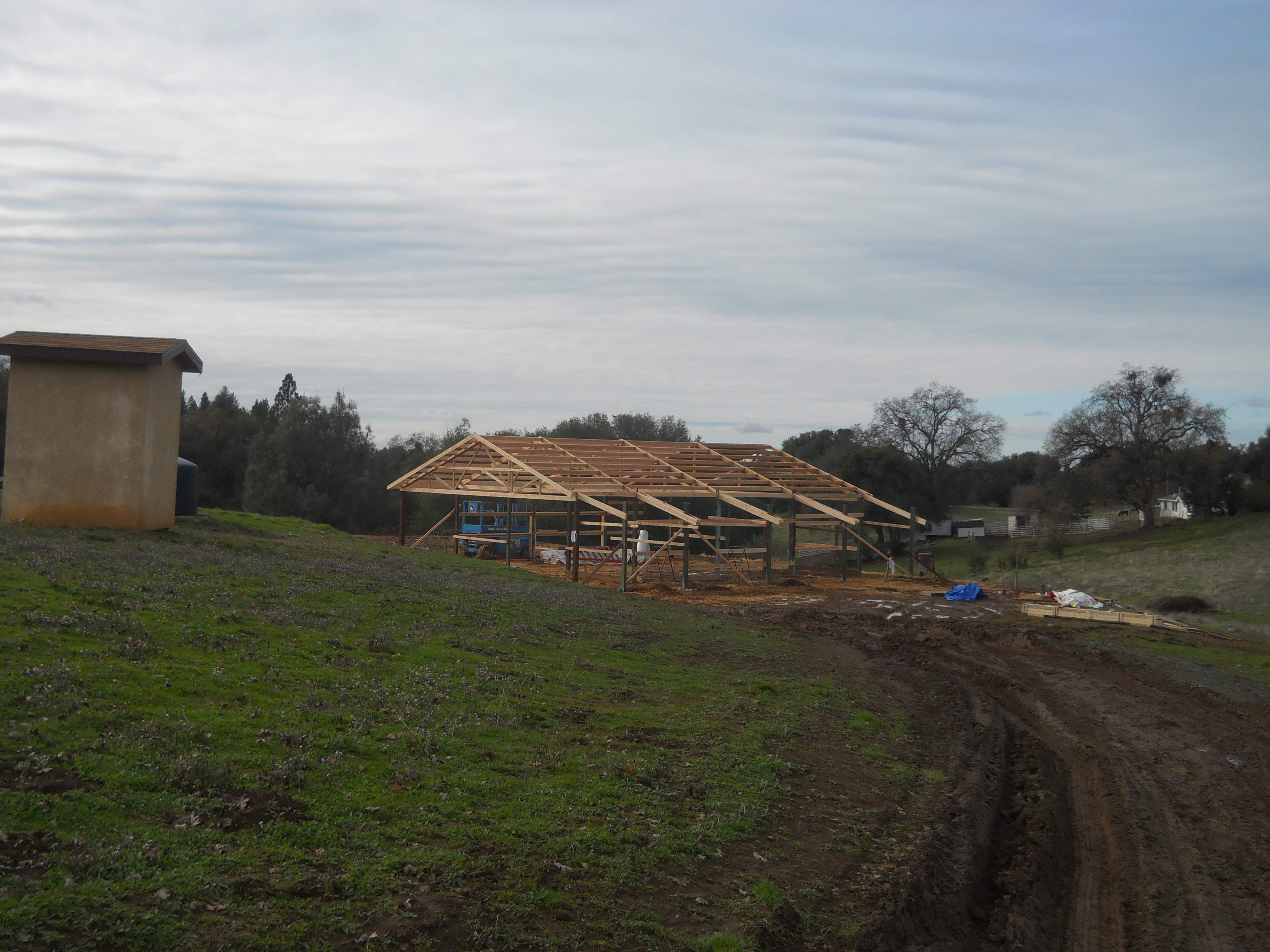

A few more pictures Friday 12-14-12 Fry barn 005.jpgFriday 12-14-12 Fry barn 006.jpg
We worked Saturday until the rain started again. Supposed to rain all week.

Thanks for the new pictures. That helps a lot in seeing how it was engineered.
With the lean to and porch, how big is the overall footprint?
Eddie

The barn is 36' x 36' enclosed and 44' x 44' with the overhangs. Worked an hour and a half before getting rained out
this morning.

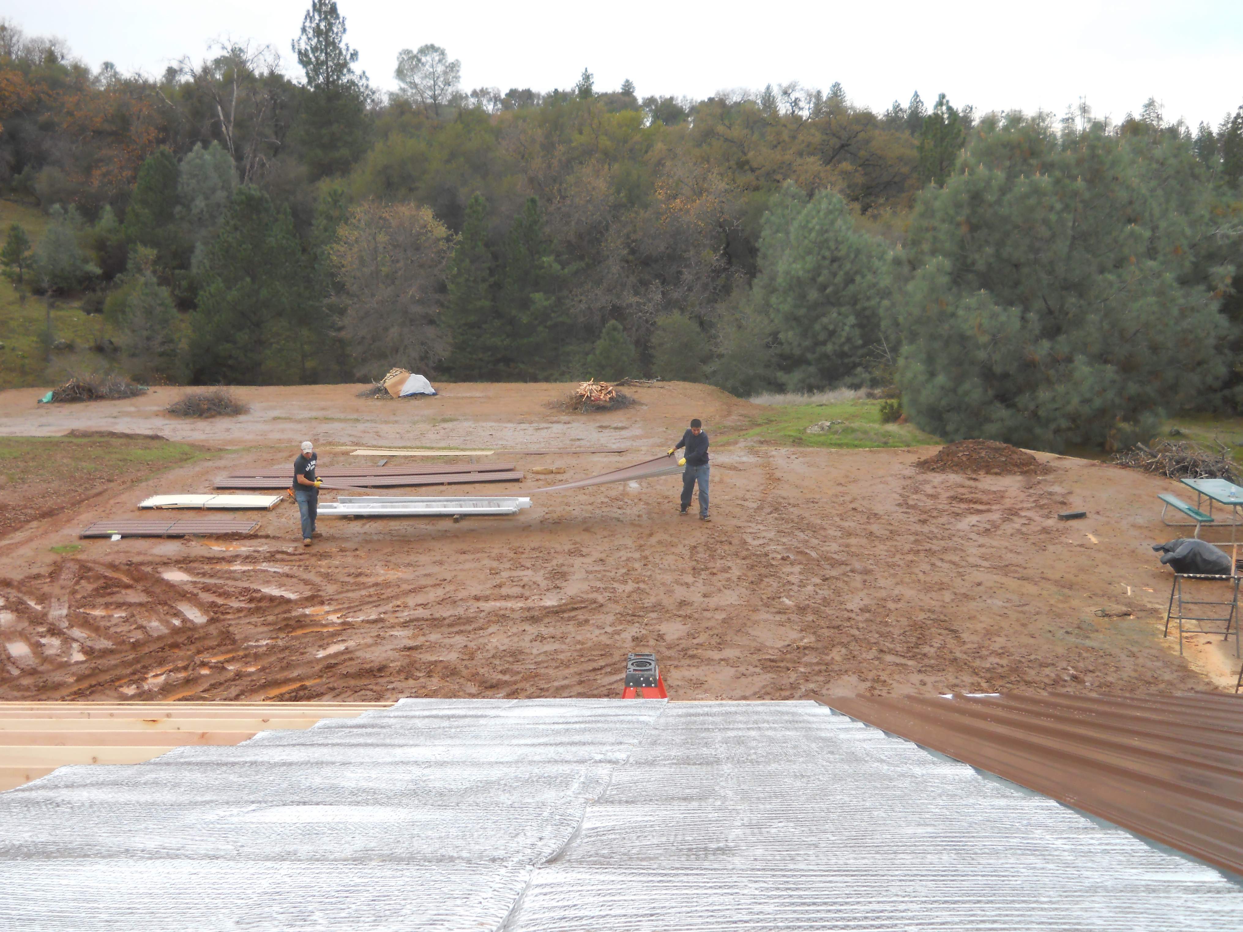

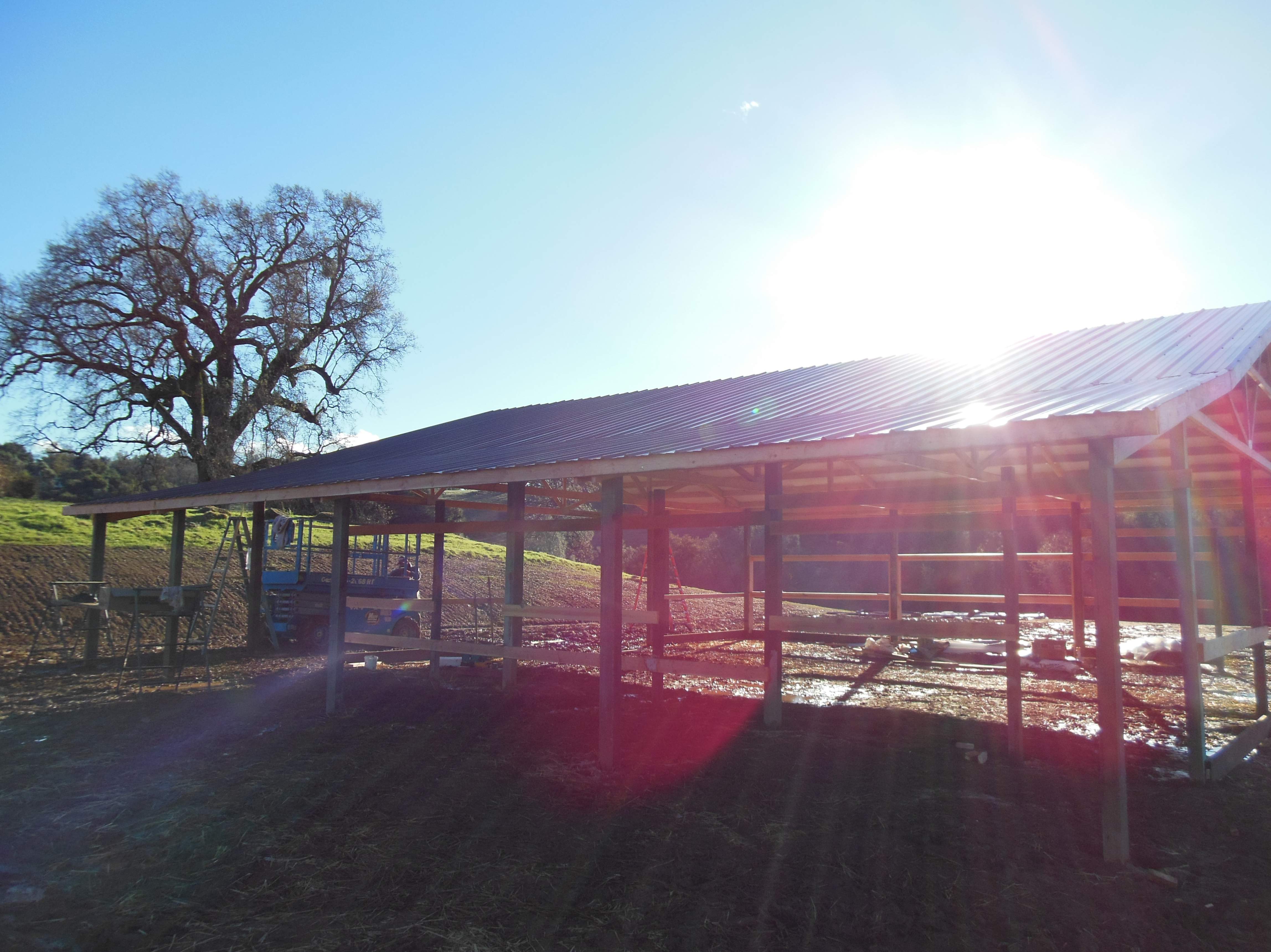

A little more progress in the mud. We have a 48 hour window between rain storms.
