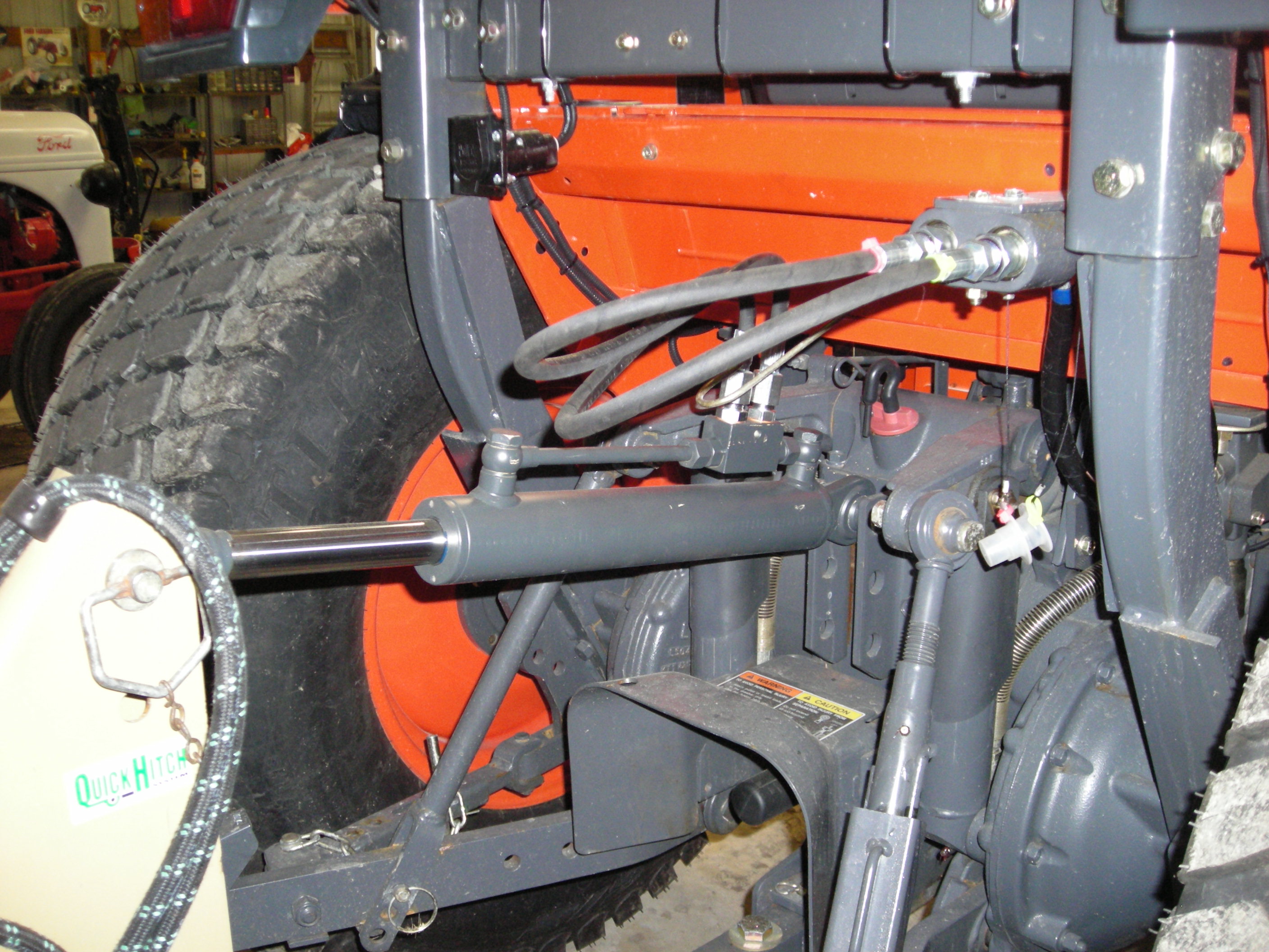

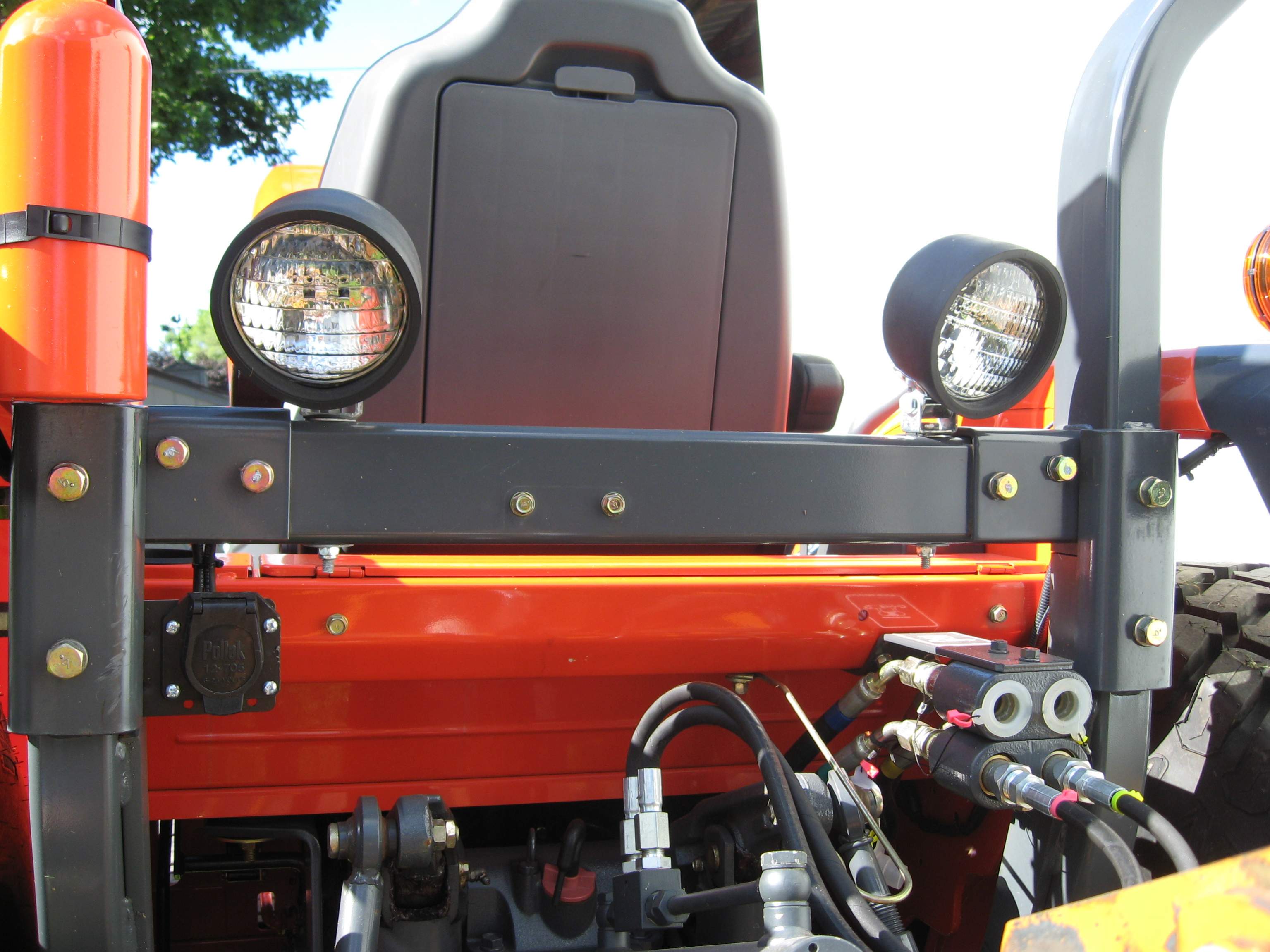

1) I got heavy duty round back, more indestructable. Depends on your uses, but I am hard on mine.
2) Quick attach a must.
3) Do you need top and tilt? If you do, you must have 2 remotes. I bought hyd top link seperately from ccm. I do have 2 remotes. 2nd remote is to angle rear blade.
5) Mid pto is for mower, snowblower, and broom. With the later 2, you need sub-frame assy. Have you priced sub-frame? I would wait on this and see what you needs are.
7) I would do my own lights, OEM's are kind of crappy. You would be happier with your own, I can help.
8) I like my turfs. Kubota has 3 styles of R3's, if you get R3's be clear to dealer of what you want. My turfs are great for mowing and moving snow, do good on dirt, and okay in mud. Cannot comment on wear, not enough time. Pic is pulling 8000 pounds thru sloppy mud, R3's got job done.
Philip.
