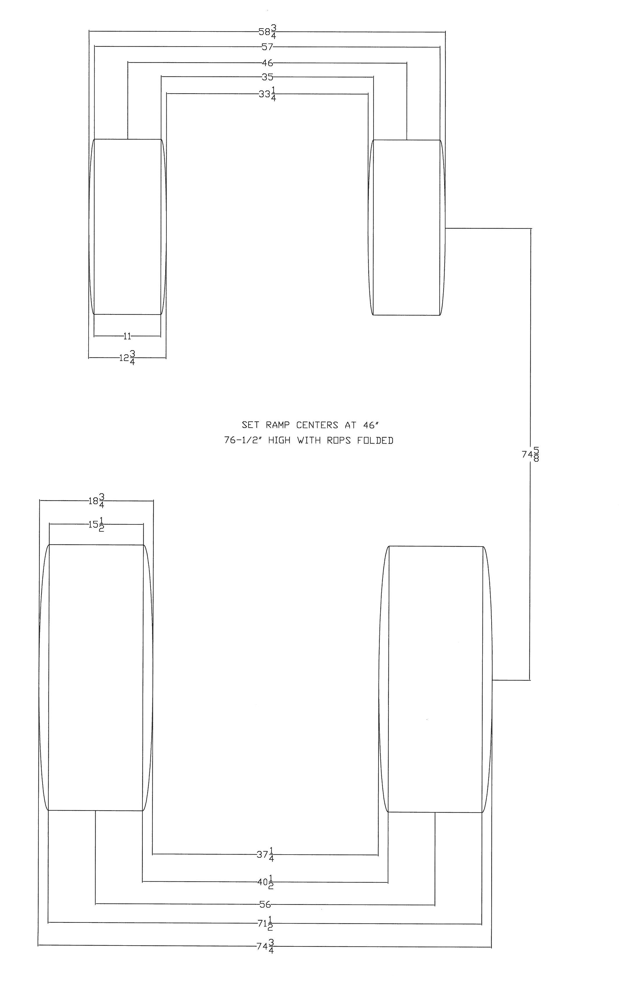

Yes, I see the three sizes, and I'm not sure if that's for r1, r3 and r4 or in and out measurements. If there's only two positions, then maybe it's for tires, but in which position? Above it I see overall width, which is what I was using, because if it's wider than the tread pattern, I can't go dragging the fender on the fence, or don't want to.:confused:
   / 3700 vs 4400 or L3940 #53
My only point is that when considering between the two tractors, dimensions should not be a significant factor.
You can get any tires you want and have the dealer set your rims however works best for you.
You have lost me on overall and tread width.

OK, here's my issue. The overall width is the closest I can get to the fences for the corrals. There are 3. If it's 5'6" wide and that tractor can't pull a 6 or 7" then I'll have to go back and do the last 6-12"manually. The corrals are for equestrian jumping and probably 1-2 acres each. For both sides or even jsut the outsides, that's a lot of work. So I'm trying to figure the smallest one I can get and pull a 6 or 7 with. The 5ft seems to be too large for the 25PTO (like the 3240) and OK for the 3540 or 3700. Some have said 3700 will do it no problem if it's not too rough. These aren't like small trees, jsut central FL brush stuff. and it FLAT, I mean the elevation on the land is 32ft max and 28 min. So there's like + or - 1 degree max. Starting to think I should just get the 3700su and buy a b series little one for tight stuff.

I am kind of ****, but here is the tread width of my L3940 with R3's, accurately measured by me. The point I am trying to make, the manual will say what it says, if you are concerned, get a tape measure and get the details you need yourself to be sure. Philip.

Tonight I'll measure my L3940, which has R4's with the wheels set at whatever normal width they come with.
