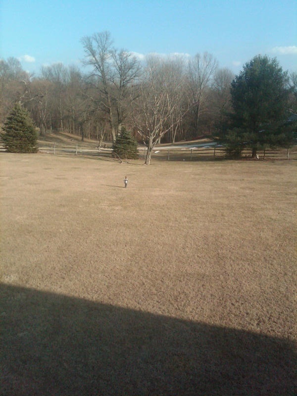

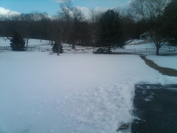

The neighbor behind me has two storm water drains emptying into his property. One from my property and one from the neighbor to my left. Essentially, the easements cut a Y into the front of his property and he has a wetland over there in the front of his property whenever it rains. From the front of his property, he has a pipe under his driveway for the water to drain under that empties from my property onto his. From what I can see (i.e., I have not yet walked onto his property) he has rocks laid out from that pipe down to the creek where all of this water ends up. The problem is that it pools up around that pine tree in the pics and it causes a wetland in the back of my property and the entire front of his. I am willing to bet that if I were to suggest a rock bed or something to channel the water to his property, he would be alright with a rock bed channelling it straight into his pipe and down into the creek, but who knows. With the amount of water flowing through this pipe, I seriously doubt a drywell will work, but am thinking about using drywells for some of the downspouts on the house. The backyard also needs to be graded at a couple spots because it holds water in the middle of the yard where you can see my son running in the yard.
To answer your question, there are days when the area is dry, but not often. Heck, the day I took my F350 on it I thought it was dry and I am still dealing with the ruts a month later and I came in on the left side and backed the truck right back that way instead of going across where the "river" flows.
Here are some pics to help you guys with the issue I am dealing with. The drain pipe runs under my driveway and comes out smack dab in the middle of the driveway. The way the downspouts currently empty, they make the rest of the backyard a mess too. Might try a drywell on the left side of the house and might try running the right side downspouts into that drain pipe. The pic with the snow shows exactly where the water is running.
Edit to add: About the only issue with adding a drainage ditch is that the tree to the right of the flow is a beautiful weeping willow that needs a ton of water, and diverting all that water away would probably end up killing it.
