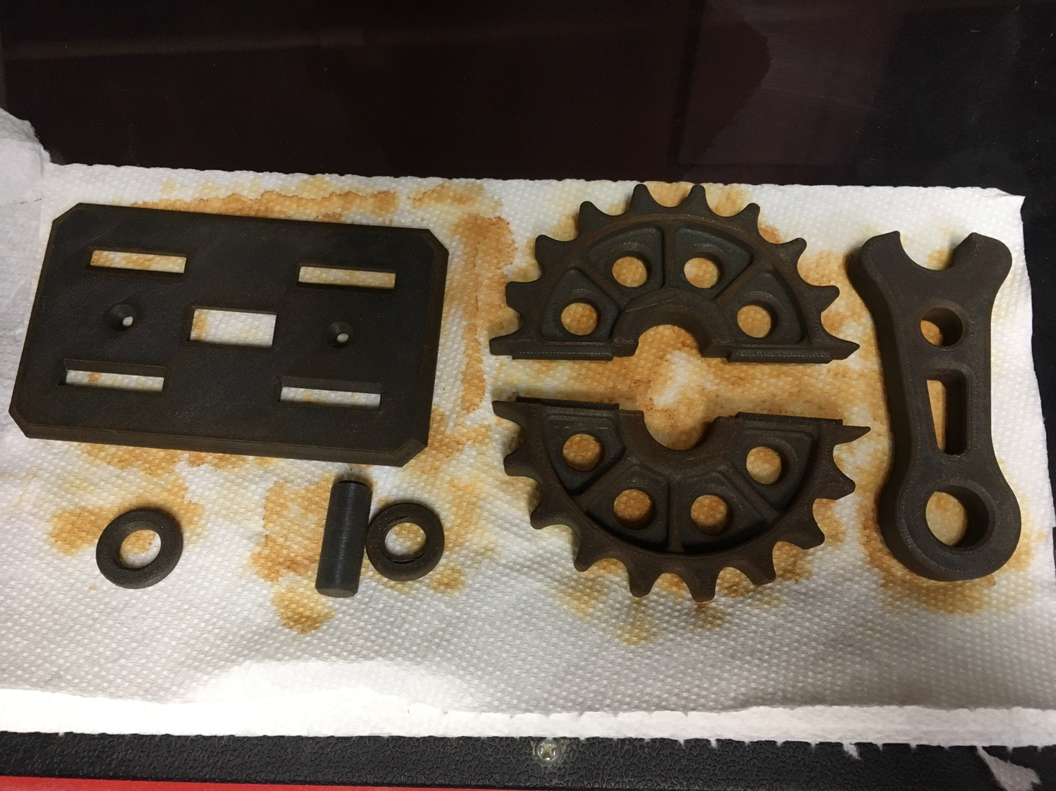

These were printed with an iron powder impregnated plastic.
A little forced rusting is being done now. The pieces look like weathered cast iron afterwards.
It will be a light switch when assembled. Gift for a young relative.

nice steel nozzle?
