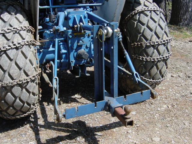

I am in Ma. I picked up my holed drawbar at TSC in N.Y. last friday when I was out there. I saw them at two other local dealers for around the same price last Saturday. You could easily turn this into a hitch system with a few pieces of metal to weld up to the top hookup of the 3pt. I plan to do that with mine. I hope to weld a 2"2" box on it for a Reese hitch drawbar to tow trailers around the place. There will be another piece welded to the top of each side of the bar to connect to the top link of the 3pt.

Here's a pic of the one I made.
   / 3ph attachment for hauling out trees #13
Vary nicely done.
