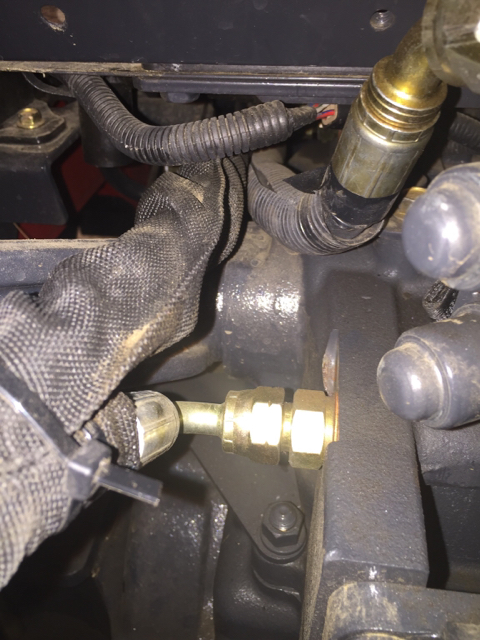

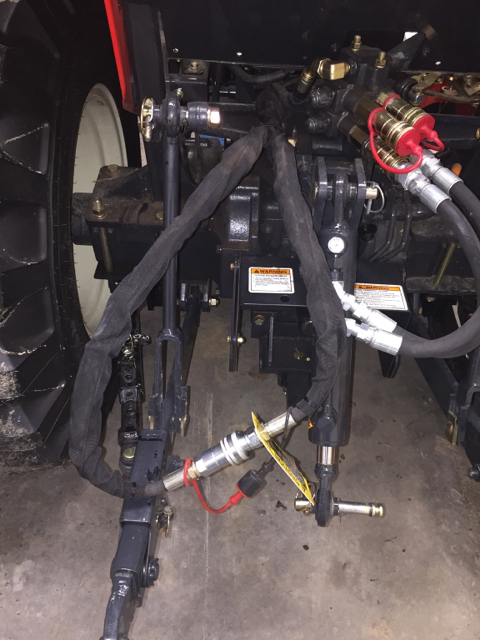

Here are the images. In the second image, you can see the two hoses wire tied together which I'm referring to. I'd like to avoid looping the hose and your suggestion still does this. If there isn't any type of bypass, I may cobble some fittings with a ball valve to tidy up the rear and gives me two fixed coupler points.
Remember I was shooting blind before the pics. :cool: I still think you could avoid valves/shutoffs by just cutting/rearranging the hoses and a couple of new QDs and possibly bracket to hold them, similar to how your factory valve is now.

Seems a lot of manufacturers make the tractor siDe hoses kinda long. Could you just put shorter hoses on the tractor side and longer hoses on the hoe side?
That's how I did my hoses when I made my bh.
That's what I was trying to say - you stated it better...:thumbsup:

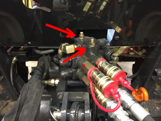

Something like this could be done on the tractor side, then a short jumper, a valve teed in between the to lines right behind the quick connects , that way you have nothing to keep up with to jumper it that way. Bunch of ways to do it , just have to decide which way you like and can do.
What CB says above - (more so in his pic), is what I am trying to suggest/convey. Make it easy to connect: on the hoe one male end, one female end, then match those up on the tractor rear end. The excess hose stays on the hoe, and the male/female ends connect, when not in use, to keep it clean. If the tractor hoses need to always allow flow when the hoe is off cut a short jumper to connect when the hoe is off. I take it the existing hoses are running off the FEL valve?

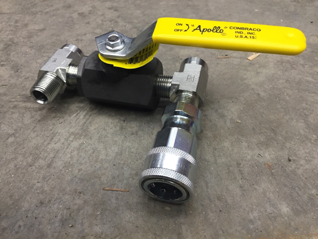

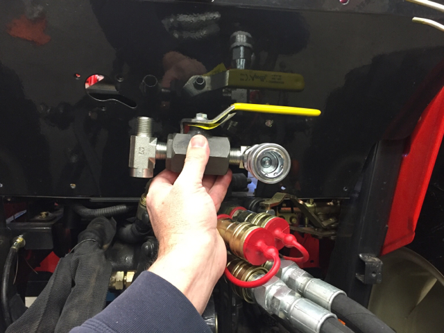

I went to a "hose" store where they also have fittings, etc. got a few items and after looking over the tractor, I believe I have an excellent plan which would make the install look factory sharp. So good that I just might offer it as a bolt-in retrofit kit for 3520 owners w/ backhoes.
The ball valve fitting has no attachment points but I plan to weld mounting nuts on the bottom side and secure it on a fabricated bracket using the existing hardware from the top of the remote stack as seen in this top picture.

Looks like a good plan, but I am concerned about the NPT fittings. They are hard to get tight and pointed the way they need to be.
The "hose" store should have sold you O-Ring Boss (ORB) fittings that you put in position and snug the nut down on the o ring till it doesn't leak. SAE Straight Thread O-Ring (ORB) Hydraulic Fittings

You know what, you're absolutely correct. I'm going to take a few steps back and try to locate an ORB ball valve. I think I found one from Ball Valve, 3/4" ORB and I'm waiting for them to supply more info & pricing. I'm hoping this one has the means to mount it too!
I know I could have gotten adapters but that would just clutter up the rear so I'd thought I'd try to do it right as if I'm engineering the setup at the Branson factory.

Got the info and it looks that this ORB ball valve I mentioned will work well. It has means to bolt it to a mounting plate and thanks to Xfaxman, the correct valve is on the way to me! The minor downside is the company is from Canada and shipping & tariff amounts to about $30 for a $48 dollar part. Not too bad since the original valve is about $58 bucks. Had I stuck with the original valve, I'd have to buy adapters and it would make the assembly wider, cluttered, and I'd still have to fabricate a unique way to mount it. In all, I came out ahead!
