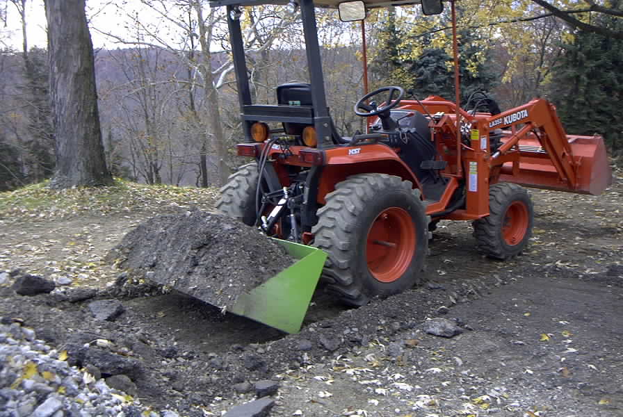

3ph bucket w/ hydraulic center link
   / 3ph bucket w/ hydraulic center link #11
Another picture.

Yeah that's exactly what I was thinking of. Thanks alot for the great picture!! Have a great day!
   / 3ph bucket w/ hydraulic center link #13
hey Bud, does that rigid bucket with no tipping frame, have enough dump angle with the hydro top link only ??
It is a very simple bucket, i think it could even be cheaper to make a bucket like this, and buy a hydro top link with it, than the Dutch type of buckets with additional tipping frame.
I will keep this in mind when replacing our 3p lift bucket... /forums/images/graemlins/laugh.gif
...Tye, i think i should have read your question better... /forums/images/graemlins/smirk.gif
   / 3ph bucket w/ hydraulic center link #14
Nice. And unlike a FEL bucket, you can tilt it to the side.
John

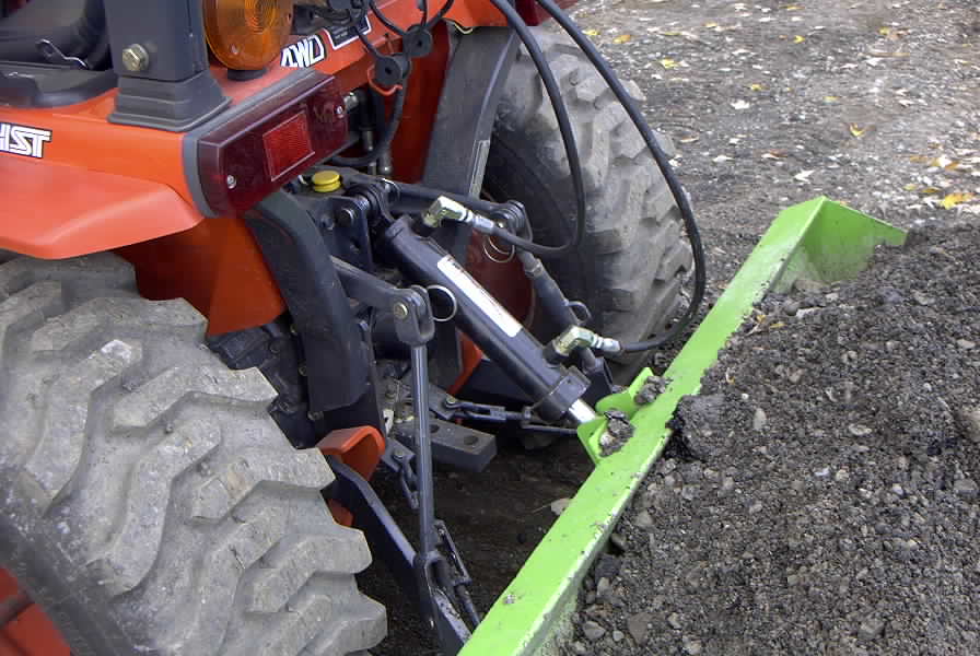

   / 3ph bucket w/ hydraulic center link #16
That bucket is not rigid, I have a hydraulic top link on it, and it will dump past 45 degrees when the 3PH is in the up position.
Bud

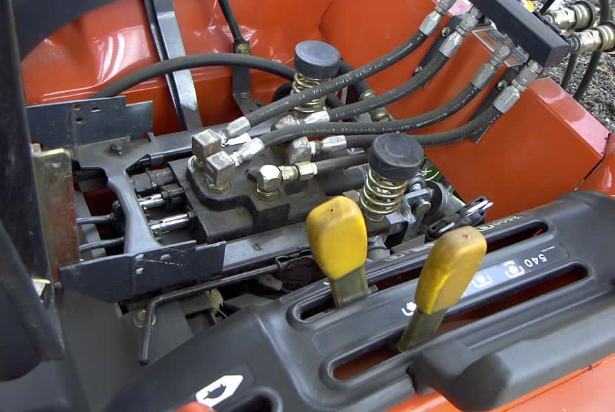

   / 3ph bucket w/ hydraulic center link #17
This is the valve I used. It's one of the three I had, with joysiicks, from the 352 loader. So I put it under the seat and used it for the rear hydraulics.
Bud

   / 3ph bucket w/ hydraulic center link #18
I have made a tipping bucket on my 16HP tractor with 3PH and it works great. With the 3PH all the way up it will dump the load at almost a vertical angle. The bucket is designed to have the pivot point about 12" from the rear of the bucket which makes it dump when you release the latch. I have moved a lot of dirt and haled fire wood for years. Now I plan on making a loader for my tractor this year.
