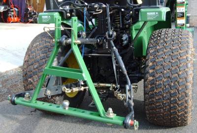

Here's the drawbar a friend made for me after I bought the drawbar and bars to to the upper link.
I'll get to how to connect it to your shredder in the next picture.
The drawbar for now. Notice the top set of holes. The top link is connected 15" up from the drawbar, which is iMatch spec (where it would hook: e.g. if you wanted iMatch, you'd attach the top link to the top hole).
Ralph

   / 3PH "Cradle" for Chipper/Shredder #15
Re: 3PH \"Cradle\" for Chipper/Shredder
Here's a picture of my soil ripper attached to the drawbar.
Another top link goes back to a bar attached to the soil ripper. The main part of the soil ripper attaches to the drawbar with a couple "U" hitches.
What you could do on your chipper is weld on a couple "U" brackets down low on the shredder that'll straddle the drawbar. Then weld an attachment (or just bolt a U bracket of some sort to it) a little higher to attach another top link. You might want to explore the 2 shorter Cat 0 links if the standard 19-29" Cat 1 link is too long.
This drawbar and double top link setup allows a lot of leeway when it comes to transport. You can tighten both of them and get the tool up high enough to clear places where the rear wheels dip.
Ralph

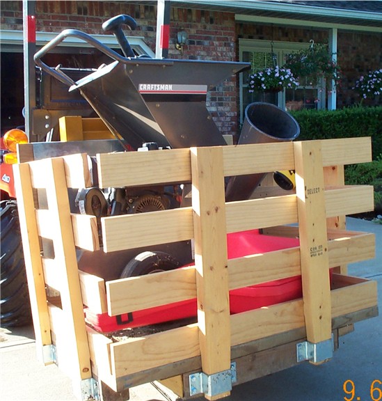

I transport my 10 HP chipper/shredder on my carryall (picture attached). When I get to the worksite I just leave it on the carryall while I use it. The carryall serves as a good work platform.
John

My drawbar design was done to be able to work on a iMatch. All you'd do is put the iMatch on the 3 pt and then use it to lift the drawbar. The ASAE specs are 26" apart at the bottom and 15" C-C up to the top link. That's the way mine is built. The additional top link that goes back to the tool is 3 or 4 inches higher.
Ralph
