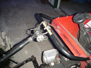

this is the top-link hook

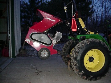

and this shows grond clearance. I have fairly steep trails, and havent drug it yet, but I'm tryin'

Bluemule,
Fantastic! Thanks for all the pic.'s. With it lifted, if you ever do drag those wheels on your land I hope you have your seat belt real tight!
With all the thoughts and pic's, I have a flurry of conflicting ideas and a few questions.
A carry-all is a great idea but, I think I really like the concept of just backing up to the chipper/shredder, moving where I want, and either leaving it, or running it attached where I can lift and move it as needed. Definetly leaning that way.
I like the simplicity of the bolted on drawbar and innovative cycle hold-downs for the toplink connections. However, I think I like Ralph's concept of a more universal drawbar that is I-Match compatible (ty Ralph, ...yes, I have the spec.'s for I-Match dimensions...used 'em for modification of the woodsplitter I bought...will definitely stick to them).
Q: Don't you find that, when chipping (especially) there's an awful lot of vibration on the 3ph, with no damping connection? I would think that eventually there would be some serious metal fatigue. Probably on the c/s 1st.
Q: When fabricating your hitch, did you consider turning the c/s around so that the motor, clutch engage, starter/pull-start, etc... were more accessible? This may not be an option. I have to take a closer look at the front foot and clearance to get to the chipper chute and blade access.
I'm falling asleep at the wheel here with too many alternatives. Just had an idea of maybe using large rubber bungies (I know..vey in-elagant) in a serpantine pattern, between a c/s mounted bracket (for lower lift pins) and top link attachment point, to a Ralph style I-match compatible draw bar. In-elagant but, might provide reasonable damping. I'd better go to bed before I doze off again. I think it's time for me to do some better measurments and drawings....after a good night's sleep.

In response to your questions..Vibration is not that bad, not as bad as when I drag my box blade down my packed gravel road. The toplink hooks allow some dampning by not being a fixed connection, and I leave sway adjustments just a little loose. You can also lower unit to ground to operate to absorb most vibration.
The reason I mounted it like I did, besides being the easiest, was I have found that shredder would spit back toward the handle side, so I always feed it from the side. I use a nylon tie looped around clutch handle for starting, so all i have to deal with is pull rope. I also wanted the discharge as far away as possible from tractor, and side benifit is great access to discharge chute and screen
