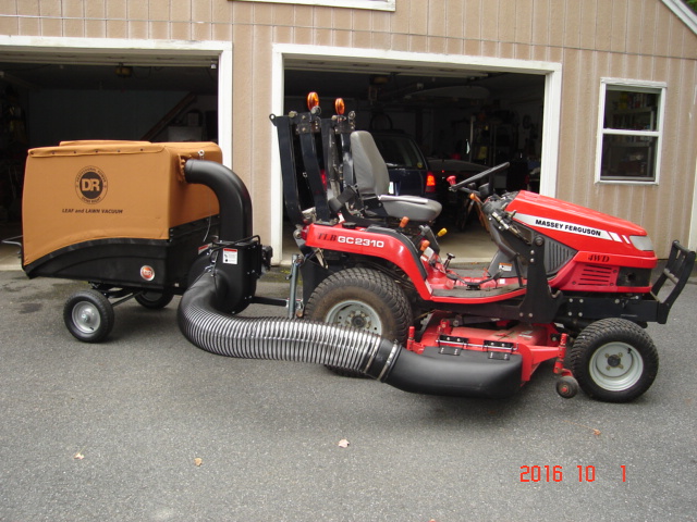

Fiz,
Do you have a picture you could post of your MMM and Proters PV-18-PTO quick dump grass catcher? Did you unit fit "factory-direct" or did you have to build and modify something? Did you consider any other baggers before choosing that one? And, do you know, approximately, what the combined cost of a MMM and bagger might be?
Twice per year, at a remote property, I have huge leaf cleanup; otherwise, regular mowing needs. I'm trying to decide whether to buy a lawn tractor for that property with bagging system, or add a MMM and bagger to my GC1710. I would have to trailer the 1710 and bagger to the property needing cleanup, but since its only twice per year I could do that. I'm trying to decide whether to invest the $$$ in a better lawn tractor and bagger, or go with a lower end mower with no bagger, since I could bring in the 1710 when needed.

I finally broke down last year and bought a leaf vac, this one's made by DR. It works very well, though I have to be careful on slopes. Really does chew up leaves and is extremely easy to empty.
