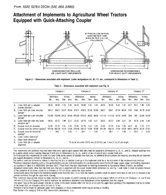

interesting note about different width implements. I have the tractor supply carryall which I just measured at ~27.5" and the "newer" kubota ballast box which appears ot be about 1" or 1.5" more narrow.
If I had a rigid frame QH like the HF one, how would I make that work? I assume it is 27.5" so is that where the bushings you mentioned come into place? to accomodate a more narrow implement?
   / 3ph quick hitch rundown (cat 1) #12
According to ASAE, Cat 1 lower hitch points should be just a hair under 27" on the inside and just a hair over 29.5" on the outside.
I plan on buying one within the next couple weeks and have found different widths on some. Measure twice as to what will fit your stuff or what can be easily modified.
Someone from here gave me this handy reference page:

looks like good info...do u have it in higher resolution? some of it is hard to read.
I will probably look into this for a few more days but maybe Pat's with the spacer bar will be the easiest given the different widths..
