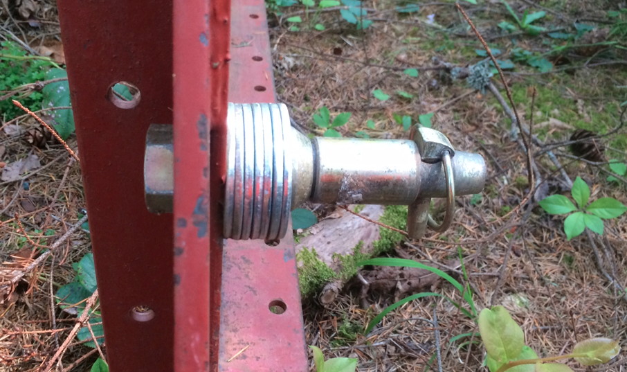

With slop you are beating your implement pins up and your quick hitch. With slop it would make it tough to grade because the implement could move freely.
Not sure I agree with slop making it difficult to grade. There are many other points that move so significantly with a 3 point hitch (and the tractor over rough terrain for that matter) I'm skeptical you'd notice movement at the pins. Plus there's no down pressure so any vertical movement won't come into play - either there's slop at the quick hitch or it would lift the arms. IMO not a noticeable difference.
Point taken on slop wearing things out more quickly. On something like a land plane or box blade, larger pins or adapters would be prudent. However, on a york rake, chipper, mower, etc I don't think it's required. FWIW I have larger pins on my weight box and box blade since those are heavy and subject to hard use. No adapters on york rake, grader blade (rarely used), chipper, PTO Saw, or bushhog. Some of those implements are borrowed and shared amongst different machines, some without a quick hitch so I can't enlarge the pins. But I personally haven't had an issue.

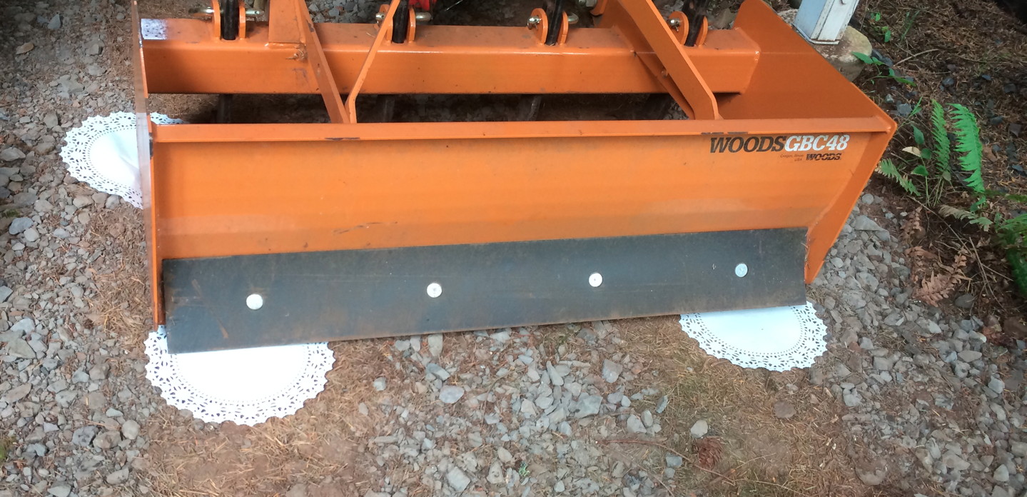

If you have the option to store your 3-pt implements on dollies, that greatly simplifies the procedure
Storing implements on the flat, using dollies will definitely make it easier.
The REAL secret is to store all of your 3pt implements on moving dollies.
I have a slab, Quick Hitch and all my implements on Dollies.
I ended up building roll-around dollies for my implements -- except for the ballast box.
OK, guys, what's the secret?
I bought the largest in the store (12 inches), tried it on hard packed gravel and on concrete. It didn't make it any easier to move the implement.
What am I doing wrong?
The white ones are for sand. You wanted the pink ones for gravel :)
Bruce
Hard packed gravel:
Concrete, but not very smooth:
The cheap paper dollies aren't worth it, you need to use linen dollies.

With out the bushing you have a 1/2'' of slop in the lift arm pins. If you have a blade on the tractor that extends 2' beyond the Qh you will have 1'' of movement at the end of the blade.
For a non draft implement like your chipper running with out bushings is not that big of a deal.
You don't have to use these style bushings on most implements.NorTrac Quick-Hitch Bushing Set — Fits Category 1 Hitches | 3-Point Hitch Adapters| Northern Tool + Equipment
You can use the Cat 1 to Cat 2 and the Cat 2 to Cat 3 bushings. Then on something that is borrowed or not used frequently you can easily take them off.
